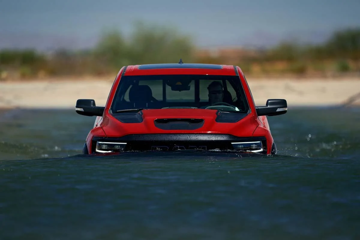

2022 Ram 1500 TRX
Exterior length (") 232.9
Exterior body width (") 88
Wheelbase (") 145.1
https://www.ramtrucks.com/trx/specs.html
How the Ram 1500 TRX Dominates the Ford Raptor

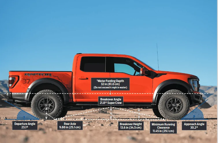

2022 Ford F-150 Raptor - Water Fording Depth - 32 in (81.0 cm)
https://www.fordservicecontent.com/...50-Raptor-Card-Version-1_RQ-EN-US_10_2021.pdf
2021 Ford F-150 Raptor
https://media.ford.com/content/dam/fordmedia/North America/US/product/2021/f150/raptor/pdf/2021-Ford-F-150-Raptor-Tech-Specs.pdf

Thanks for the info, but there wading depths are typically limited by engine air take height for the ICE. EV has no such limitations. That's why for ICE you get a snorkel to improve wading depth and keep water out of your engine. (And for better dust control)
My point is that Cybertruck is designed to float ie be amphibious, all the others are not designed to float, rather to sink, so they get the good wading depth.
If you design it to float, you want it to be as far out of the water as you can, which means the sealed underbody becomes the things that starts floating, not the cabin volume which is much higher up.
You can either have good buoyancy or good wading depth but not both, unless you can get the wheels further down from the underbody. BTW amphibious trumps wading depth any day of the week in my book.
It really just needs an electric powered jet ski water jet sitting in the rear bumper, and wading depth becomes irrelevant anyway.
