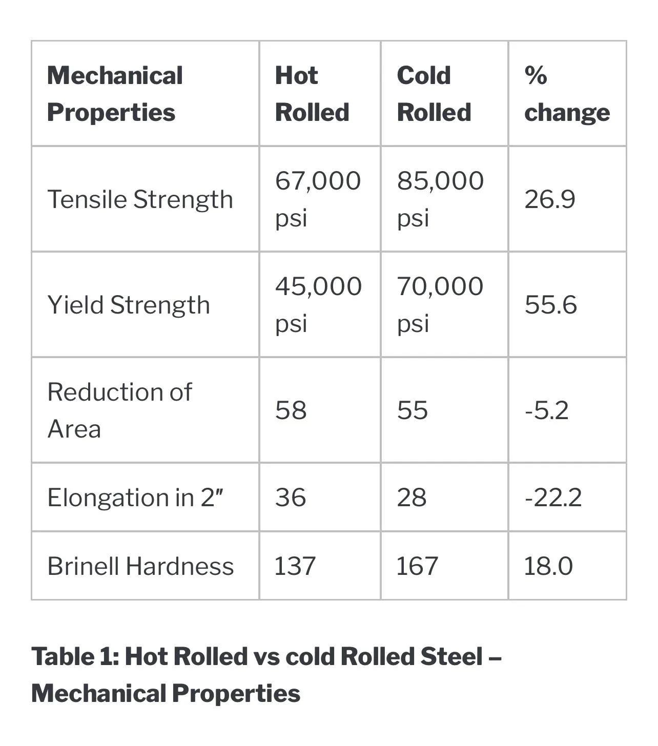

"Hardness" is the correct term. Cold-rolling the steel causes a work-hardening to happen. The more passes through the rollers, the more it is work-hardened and the harder the steel becomes. There are multiple grades of hardness with cold-rolled stainless steel and Elon didn't specify a particular hardness. It goes from full soft (not cold-rolled) to "full hard".
I’m talking out of my bailiwick here, as in my post above I was only quoting this company - which is in the business of modeling/simulating the formation and stamping of stainless steel and design of presses that do the same
If I understand their post correctly, according to them while cold-rolling is sometimes called “work-hardening” the steel, the main metallurgical quality being changed by cold-rolling for the purposes of steel being used in these applications is increasing its “Strength”- (both yield strength and tensile strength) the maximum tensile stress the material can handle before permanent deformation occurs (distinct from “hardness,” which is the material’s resistance to localized surface deformation, like abrasion/friction resistance).
roughly, it seems as though “Strength” is defined as the ability to withstand an applied load without permanent deformation/failure while “Hardness” is defined as the ability to resist localized deformation (particularly surface deformation like abrasion) …. with cold-rolling metallurgically improving the former, such that the more cold rolling is performed the more the steel’s yield strength approaches its tensile strength.
that said, cold-rolling also improves hardness as the two are related - but I found this cool little comparison example of the relative improvements by cold-rolling:
