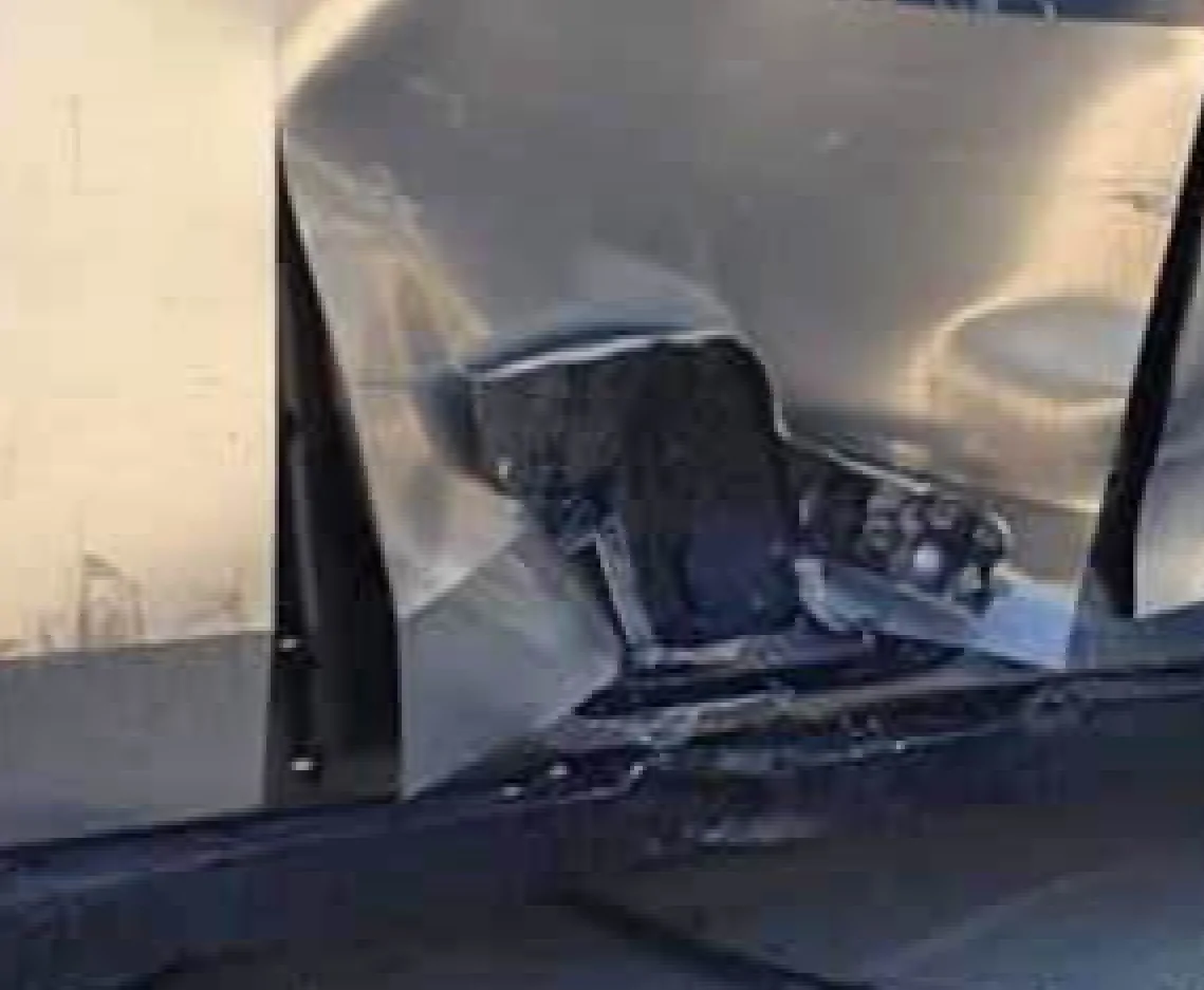

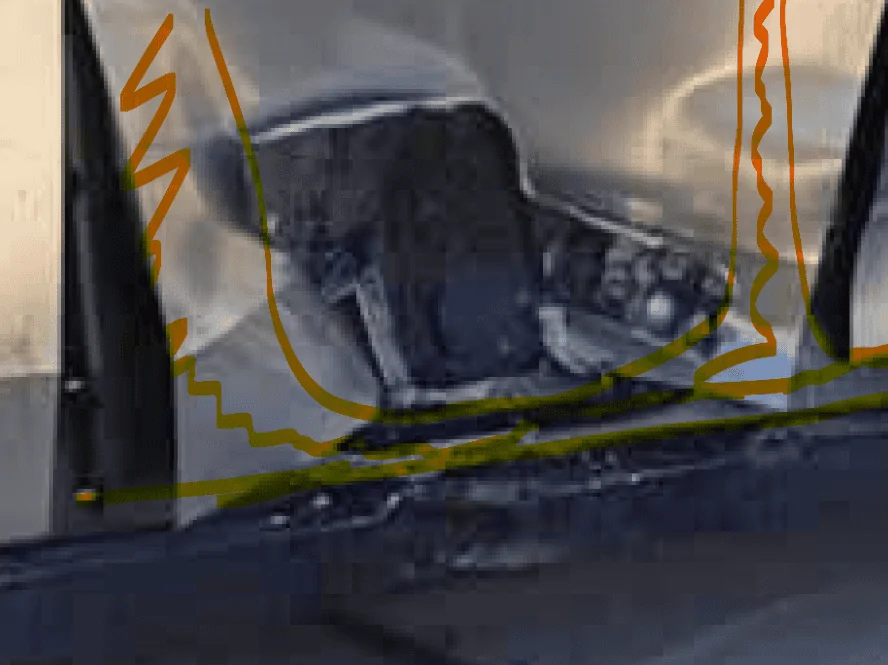

That looks like a piece of the Toyota stuck to the Cybertruck.
The top piece is, and it's "clipped" into the bottom sill of the door opening.
Tesla Cybertruck Cybertruck T-Bone accident at high speed - damage photos 1715808039466-d7
There is no anti-intrusion bar in the door to prevent this exact scenario, unfortunately.

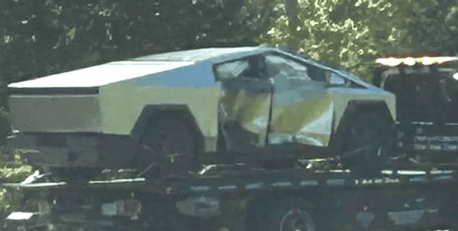

Tow truck picture w shadows helps to show it more.
It's in there probably to the seats.

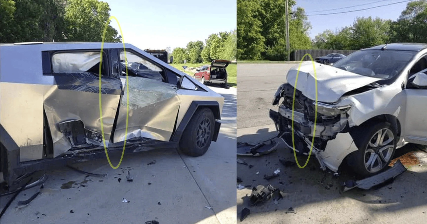

What the pictures tell me (as @carsly also pointed out), the B-Pillar is mostly intact with this accident showing proof of it's strength, because it actually cut into the center of the impacting vehicle imprinting a 'V' shape (right image). The uni-body rails of the impacting car were what likely pushed the door panels in on each side of the B-Pillar but they still held up fairly well IMO, resulting in an 'M' shaped impression in the side of the Cybertruck:
Tesla Cybertruck Cybertruck T-Bone accident at high speed - damage photos 1715810033636-w8
I hope the repeater or side camera videos can be retrieved and posted, because even with limited field of view just before impact, an analysis of movement for the approaching vehicle frame to frame, will likely give a fairly accurate indication of how fast it was going (if enough frames were sampled of the approach and impact).
Regardless I think it already speaks volumes on the safety benefits for occupants in a Cybertruck.
