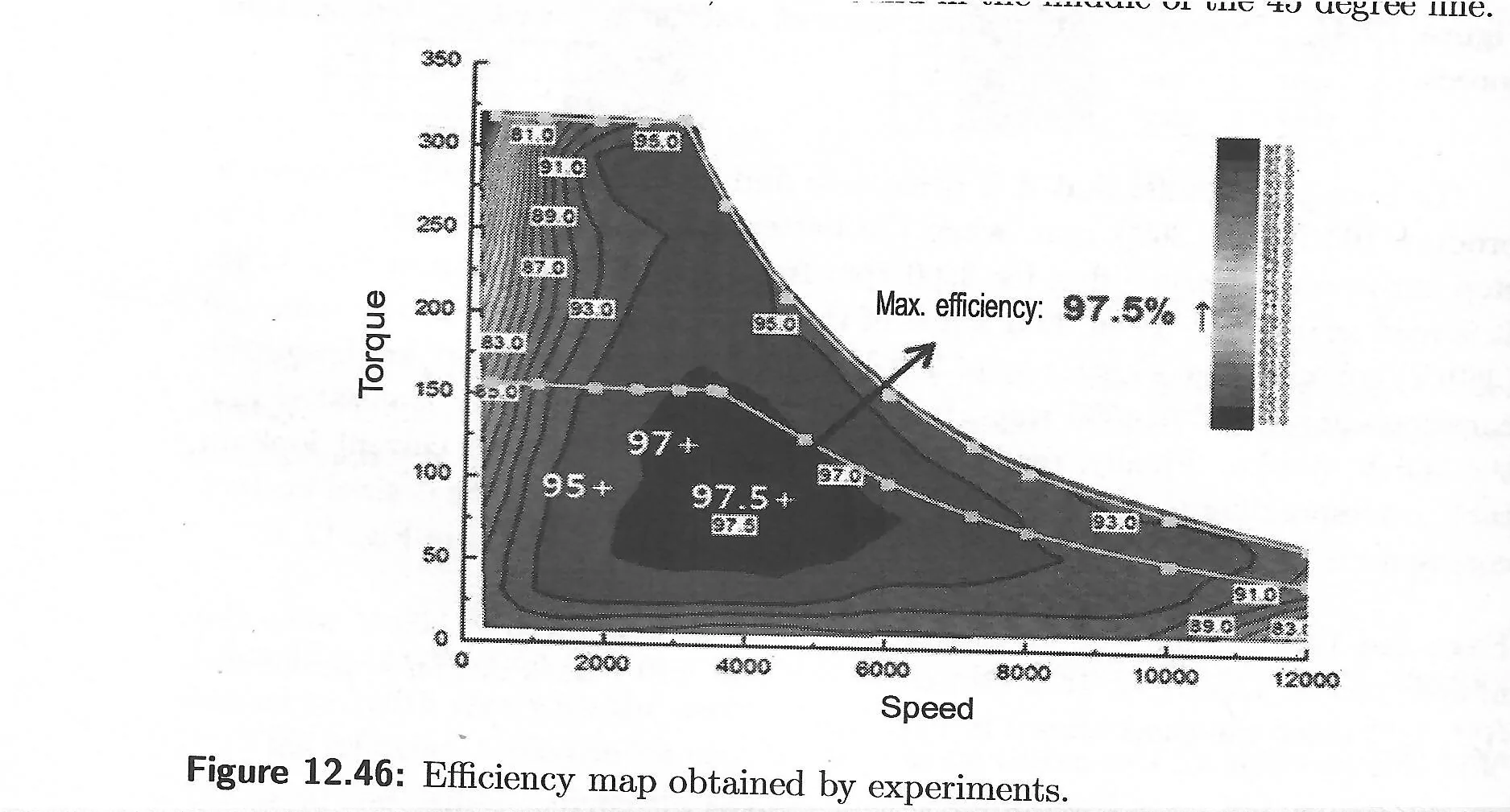

Well yes, that's true. Obviously a great deal of effort goes into designing the motors such that they are most efficient at the speeds around which the car normally cruises as this translates into minimum Wh/mi and thus maximum range under typical use conditions. And it goes without saying that if you lock the rotor and apply current the efficiency will be 0 as current will be drawn and heat generated but no mechanical power will be produced. But that doesn't happen in a BEV as the controller will sense the locked rotor and shut off the current.
The picture you post may represent a typical PMDC motor but it does not represent the motors that are going into BEV these days. Tesla is currently using induction and switched reluctance motors with permanent magnets. It is also worth noting that we now have vector field control of these motors which makes them much more efficient than they used to be. As you can see from the picture I posted (measurements from a modern PMSM motor) efficiency is best at midrange speed and torque but is still pretty good in the startup range. Do keep in mind that there is a fair amount of reduction gearing in the transmissions of these cars. Looking at the plot suppose that the gearing and tire radius were chosen such that engine speed were 6000 rpm at 60 mph (reasonable and makes the math easy). Then at a 1 mph crawl the engine speed would be 100 rpm. That's at the left edge of the plot and efficiencies are from 51% (the lowest number on the chart) to over 90% depending on the torque requirement. So yes, you are right in that the motors are less efficient in a crawl than at cruise on the highway but not by nearly so much as you seem to think. And, as I showed in my last post, it doesn't matter.
Tesla is, of course, aware of all this. If they thought lower gearing were necessary they would design the car with lower gearing.
Our legs are a little like an electric motor in this regard and we all know how much easier going up a steep hill is in a lower gear with higher rpm while riding a bicycle.
It isn't any easier at all. The same amount of work has to be done. If I weigh 100 kg (and, to my disgrace, I do) I must produce 980 joules of energy for each meter my altitude increases whether I am pedalling furiously fast in a low gear or trying to generate more torque than I can in a low gear. I cannot apply more than 980 N to the pedal.

Does this mean that gearing lower, which would lower the top speed, to something like 100 mph, could significantly improve the highway efficiency of the CyberTruck? I may have inadvertently :ROFLMAO: exceeded 110 units per hour when passing someone a few times in my Model S, but could certainly give up 30 mph of top speed in exchange for greater highway efficiency.
Edit: After seeing AJ's diagram, all the above seems moot, assuming its correct. It sounds plausible though. :cool:

If the motors used in BEVs had characteristics that even remotely resembled the diagram posted by Humanoid1 then the designs of the cars would be very much different than what they in fact are. There would be elaborate gears/automatic transmissions to try to keep motor speed near 85% during cruise whether that be at 45% or 90 mph. Different gears would be selected to get you to high torque for acceleration but you would pay a heavy penalty for this as you couldn't have maximum torque except at very low efficiency. So I say again. Those curves are not typical of BEV motors. The picture I posted is typical of BEV motors. Note that this motor exhibits constant maximum torque out to about 3700 rpm at efficiency always greater than 51% and more or less constant power output (product of torque and rpm) at higher speeds with a large area (large span of torque and rpm) available at efficiency > 90%. This is what you want and need for a BEV motor. I have no idea what sort of a load the motor depicted in Humanoid1's curve was designed for but it clearly wasn't for use in a BEV.

Just noticed that the curves posted in No. 30 are for a PMDC (Permanent Magnet DC) motor. The difference between these (typically used for the fans in computers) is that they have Y connected 3 phase windings in which the battery + is connected to A and - to B and C for a bit and then + goes to B and C and A go to - for a period and then C goes to + and A and B to -. This creates a magnetic field which goes around the motor in steps. In a PM synchronous motor, by contrast, the switching is done at a much higher rate (10's of kHz) and the pulses are of variable width (PWM = Pulse Width Modulation) thus causing the voltages sent to the three phases to closely approximate sine waves (vs square waves in the PMDC motor). This results in a smoothly and uniformly rotating magnetic field. The PWM allows the currents in the windings to be adjusted such that motor flux and torque can be separately controlled. This is why the induction and switched reluctance motors in the Teslas have such good efficiency.
