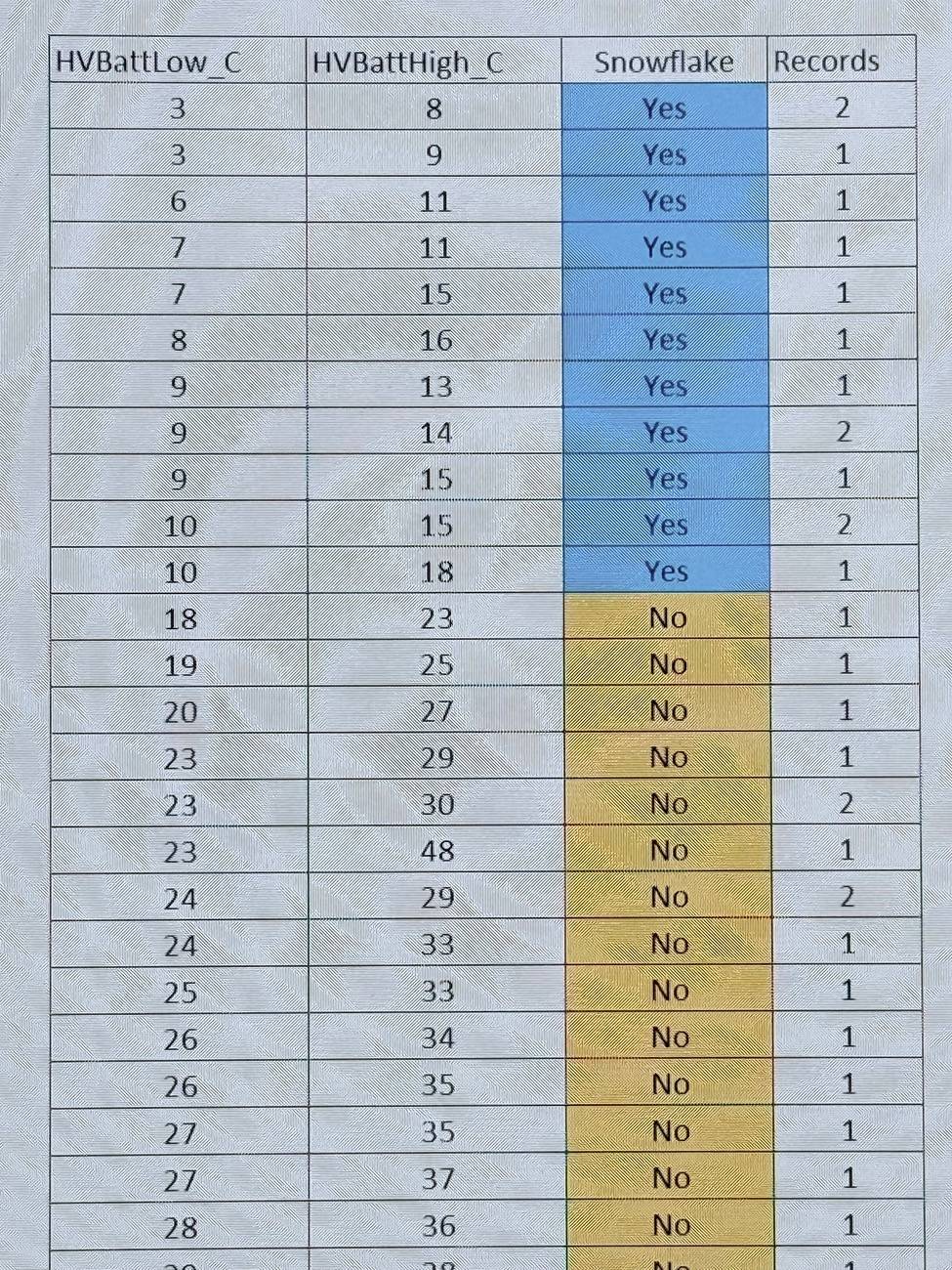

Battery temp ranges aren’t in the manual, but you can see them in service mode. The snow flake seems to appear when the battery temps are somewhere in the range of 10-18deg C
I’ve recorded these on a few dozen recent trips, including one where it got down to about 4 degrees below freezing over night (the truck was outside).
As far as I can tell… When driving with the snowflake, the octovalve was usually in ambient source mode (pulling heat from the autopilot and drivetrain I think). When parked, it was either in ambient or series radiator bypass. The power train coolant pump was always on regardless of driving state, temperature, coolant pumps, anything it seemed, just always on. The chiller pump was on about 80% of the time, also regardless of whether the snowflake was displayed or not.
