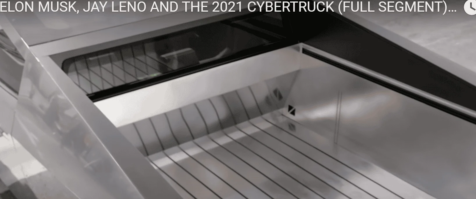

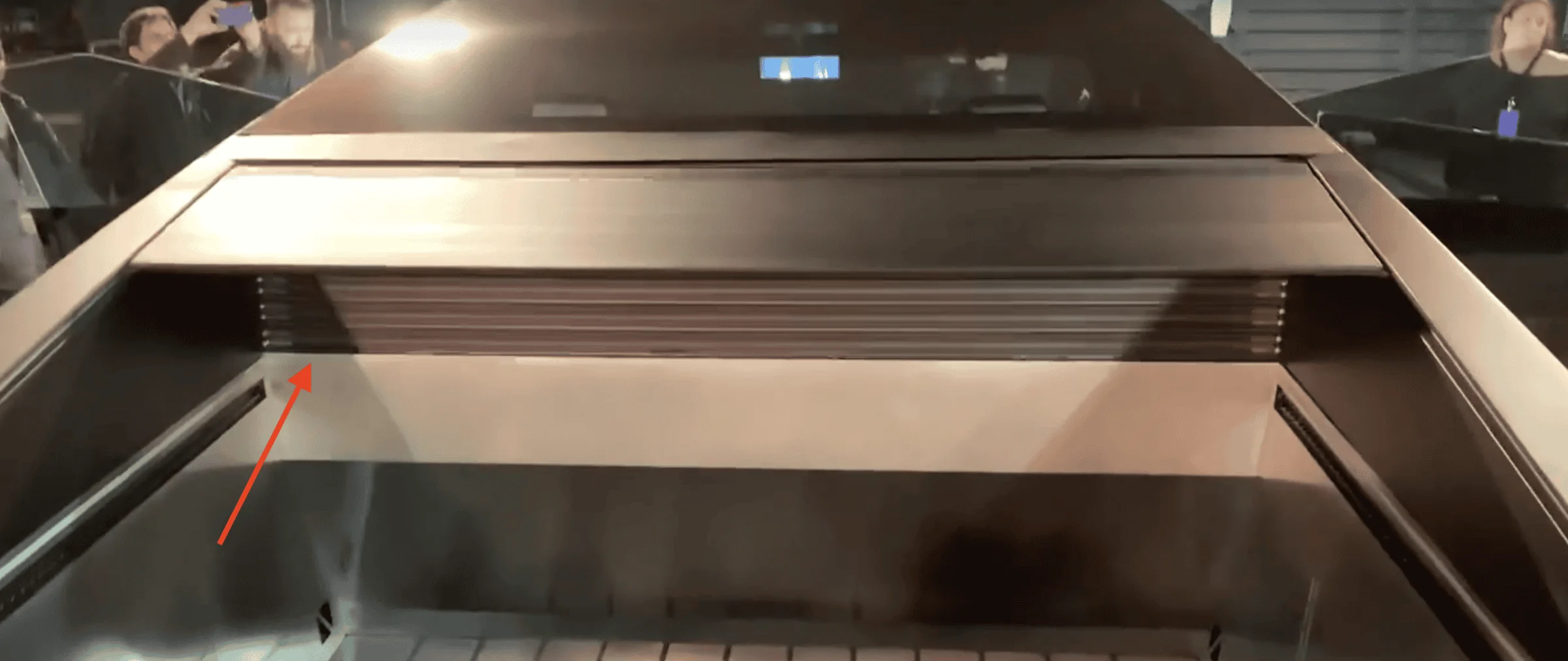

I’m not sure if you’re just being belligerent or if you honestly don’t understand the failure mode I’m trying to articulate to you. The likelyhood of something inadvertently dropping in to the cavity is significantly higher when the opening is at the bed level as opposed to what is pictured below.
All of the other doors you’ve mention function in open space or swing into an accessible space. The Tonneau does not. This is a special case when thinking about possible obstructions to function.
Yes, I think I see your point. fiinallly lol.
My take was that the seat is an independent item which needs to be folded down … But behind the seat is a configuration as per picture below.
The Tonneau is never exposed to the bed.
Are we talking about the same thing?
A Midgate significantly complicates and compromises storage of a rolltop tonneau cover.

I think @***** is saying if the path of the cover is aft of the midgate instead of through the mid gate then obviously it is unworkable if the bed is loaded or an obstruction slides into the path.
There will have to be a bed wall at the front protecting the cover path. That wall has to be significant strength to prevent it being bent into the cover path. With a mid gate scenario that wall could only be attached at the sides with the attachment wider than the cover path, now if the gate is open there will be no path for the cover... as much as I want a mid gate and the cover I do not see how and eagerly await the magical surprise Tesla wizards pro...pro..pull a rabbit out of the hat

If they do a mid gate I can see dust/soil and small debris being a design challenge as it could fall into the slot when the mid gate is down and gunk up the tonneau storage area. However the toolbox example makes no sense to me.
It's quite clear the tonneau cover runs through the middle of the partition.
