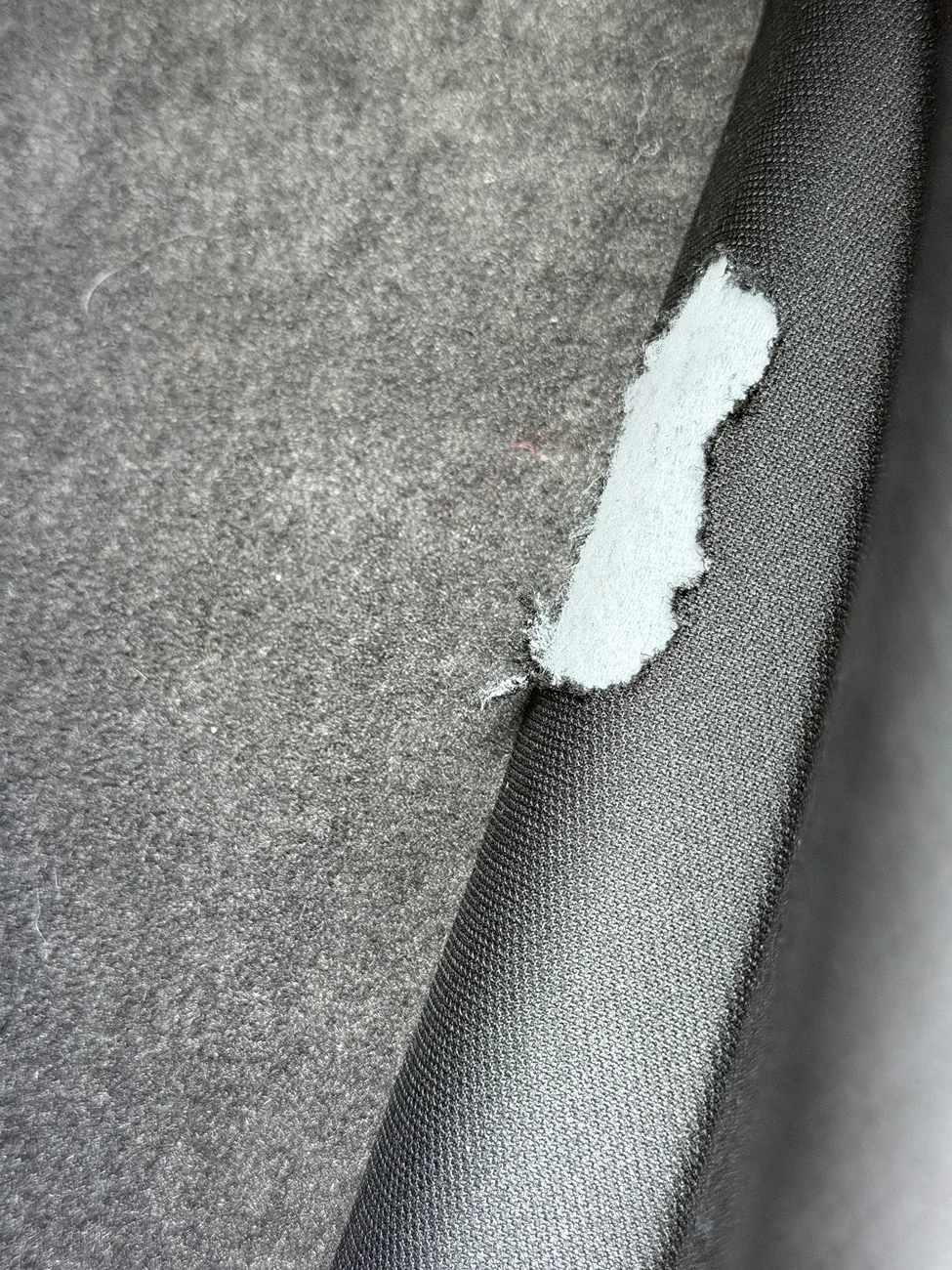

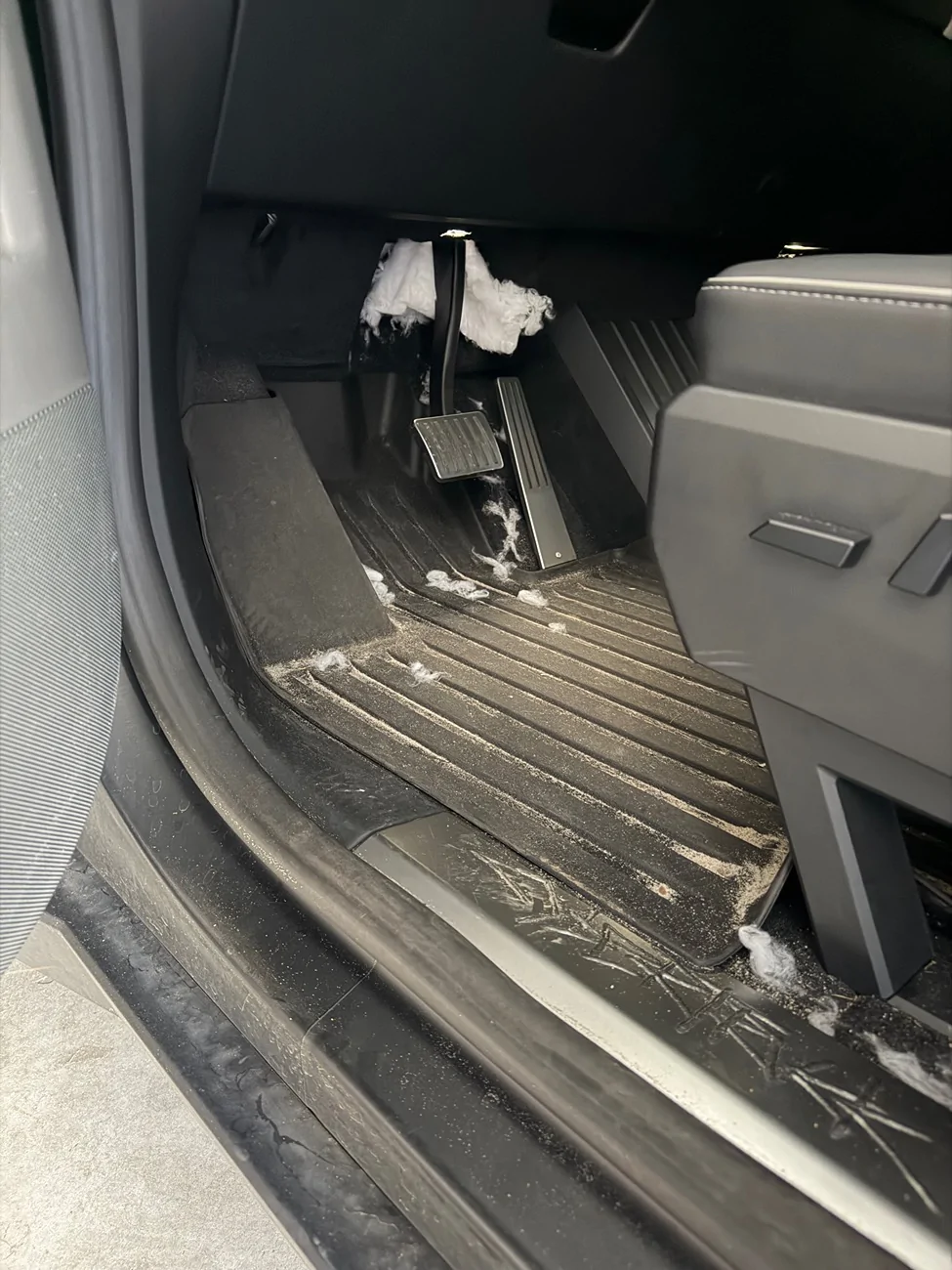

How does a mouse get it the CT?

I know simple steel wool keeps them from climbing into the house next to pipes but not sure if it would hold up in the CT around seals.

They get in through the wheel well and then up into the space by the air filter. I had to have the main wiring harness on my truck replaced last year because of rodent damage. Apparently the wires have soy coating which they like to eat.Took a month to get a new harness to a local service centre. I picked up a bottle of rodent spray deterrent, and I spray that shit all over the inside of the wheel well around the shocks. Not sure how effective it is, but haven't had anything climb in there this year… Knock on wood!

I had the same thing happen on my Jaguar F-Type. Rodents chewed though a couple engine harnesses causing 3k worth of damage.
Like others have said it’s due to the soy based harnesses that are more eco-friendly. The Jaguar dealer ended up wrapping my harnesses in Honda Rodent Tape. Never had any problems after that.

This is a serious issue. I had a Toyota Highlander that a mouse went and chewed up a wiring harness. Cost me over $2k in damages.
Just last week I had an oil change done on my F350 and they found rodent nests in both the air filter and the cabin filter. My brand new F150 had the foam engine cover chewed up by pack rats 2 days after I bought it.
It was war. I placed 8 bait traps with Tomcat poison around the house and shoved poison in the engine bay of my vehicles. In about 3-4 days the rats were all dead. I’m still working on the mice.
Luckily my CT is parked in a heated garage and haven’t issues with that one (yet).
