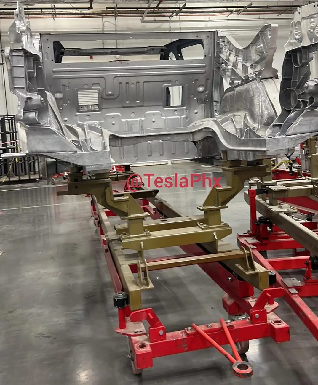

The brake pedal seal makes perfect sense for rodents to enter the cab.
I was thinking the air vents that release air pressure when shutting the doors on the back of the BIW. They are located behind the rear seat.
Tesla Cybertruck How does a mouse get it the CT? IMG_2745
LemonCT
Jan 28, 2026
35
Orlando, FL
2024 Cyberbeast
Come to think of it, they ended up having to replace those vents as well. So maybe the rodents on my CB had entered through those to
