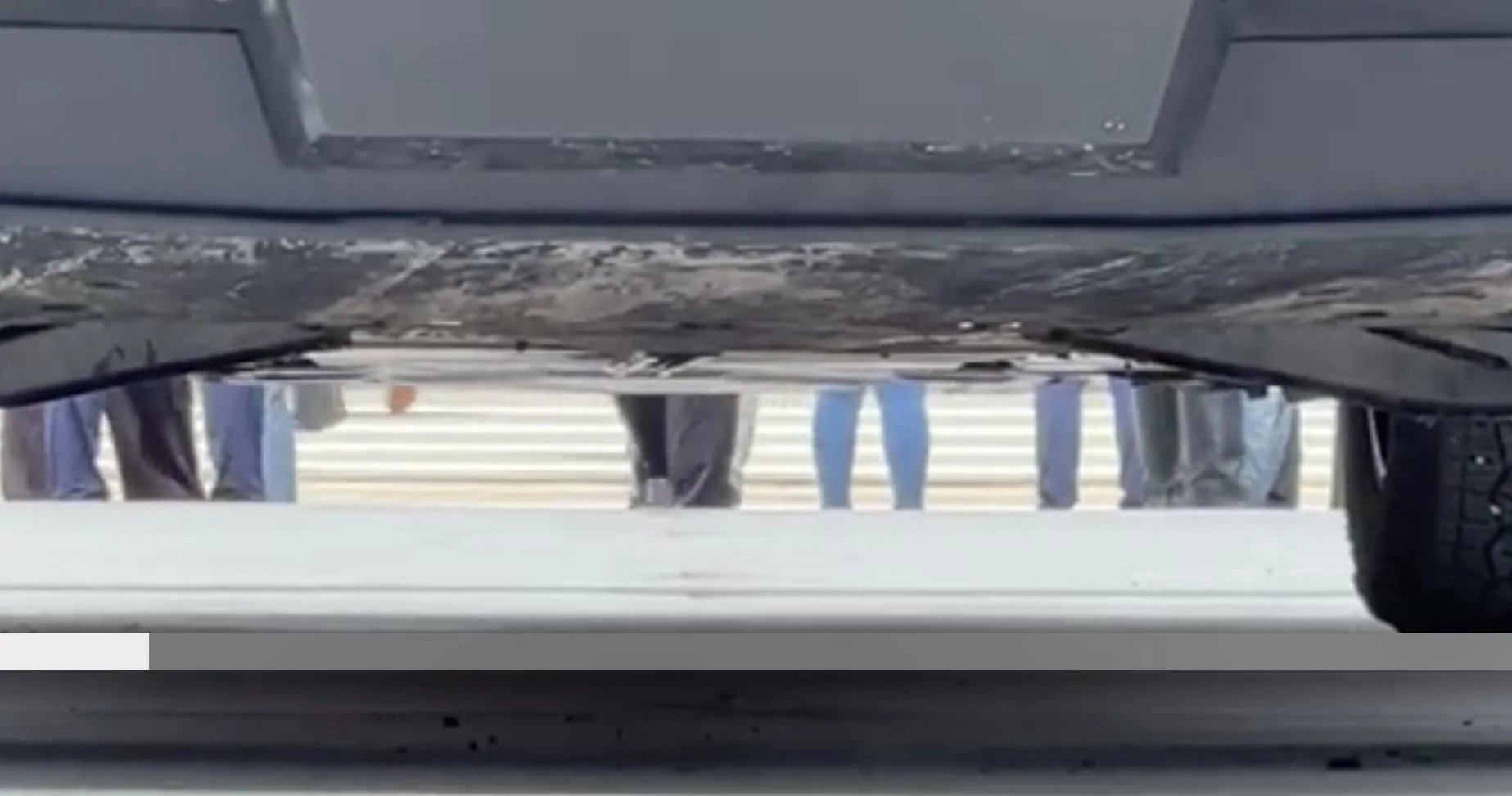

The biggest issue I see with the diaper or what I would call an aero fairing is that its either a) highly vulnerable to offroad damage because of departure angles or b) will need to be pulled off to “go offroad” which doesn’t always mean it was planned for and if the bed is already full, where does it go?
1,768
2,940
I’m not doubting there are other seams. At all.
I’m saying for the tow hitch, that middle 1/3rd is what comes off.
I have an image of it off if you’d like to see. But you have it too.. Y’all miss a lot of detail in the fuzz sometimes.
Go watch the Texas drive by video the other day. It’s off and exposed.
that the tow hitch and pin set are there under that middle 1/3rd trim piece is uncontroversial
seemed like you were going further and there are not other removable trim pieces to the left and right
If you weren’t disputing that, then we were just talking past one-another
1,768
2,940
why would you say that :ROFLMAO: /s
Cybertruck Tow hitch hook on Cybertruck -- closeup look without cover 40DBDBD3-6DA9-4277-A0D1-987B850E2BE1
and if you look closely, that bottom, forwardmost, edge of the diaper trim will be susceptible to catching on a rock / limb and will be removed for “free” by the trail
I suspect that people intending to be on trails with regularity will remove the diaper entirely, exposing the CTs hangy-down giblets
