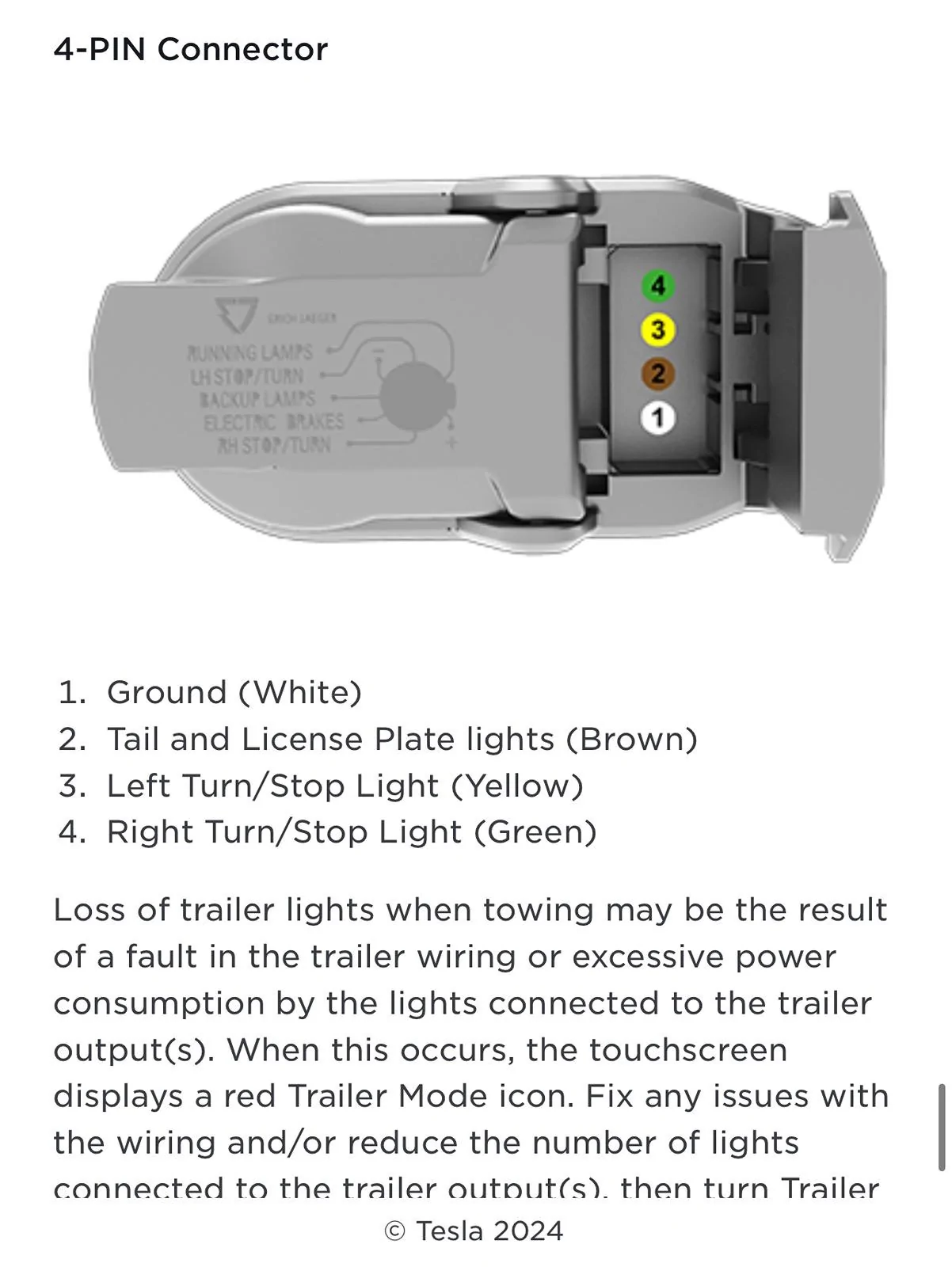

I see the 7pin but i don't see the 4 pin i need for my utility trailer
Tons of adapters for 7 to 4 pin available if you look.
I hope Tesla offers the newer EZ Connector as an option. Great design, much better than traditional 7 pin connectors.
