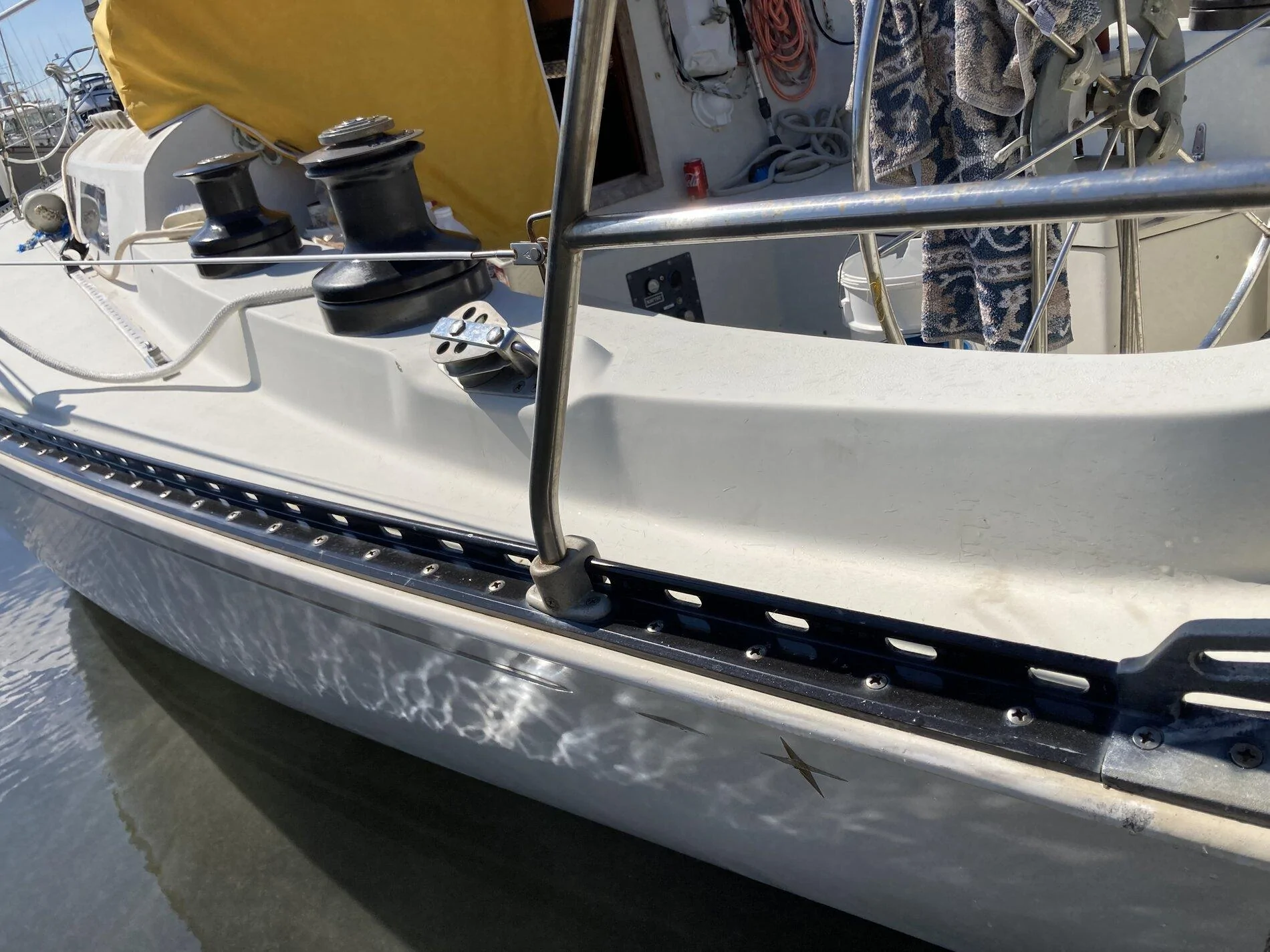

The marine industry has been dealing with galvanic issues between aluminum and stainless for years. Obviously the type, finish, and grade of aluminum and stainless are all important. This is a photo of an anodized extruded aluminum boat rail fastened and has direct contact with 316 ss bolts on my sailboat with no signs of corrosion, even after 41 years. I am confident Tesla has given thought to the issue.
