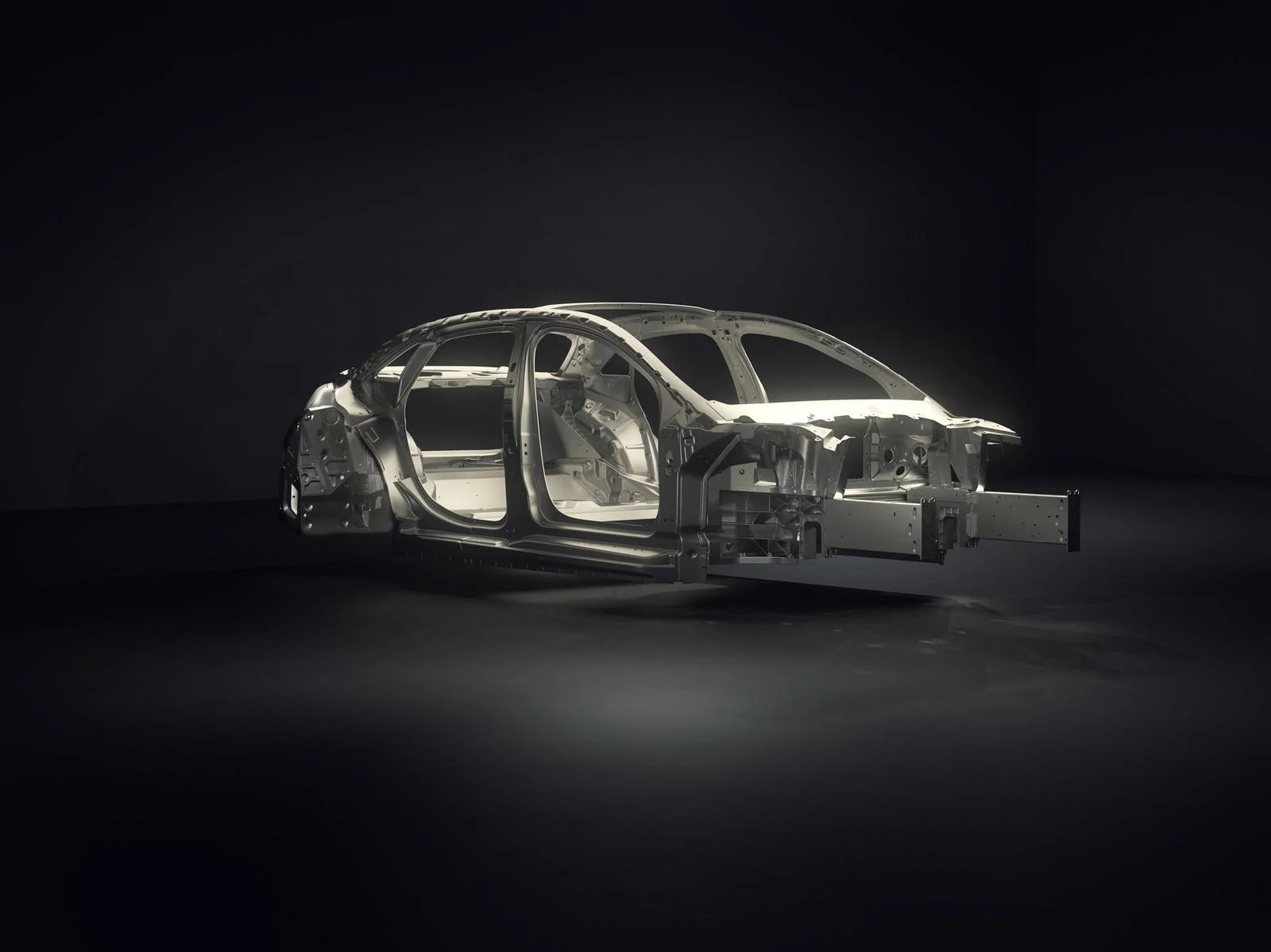

The Lucid Air BIW is joined together using rivets, structural adhesive and 2 welds. Will the Cybertruck be similar? I believe so because if you TIG weld SS it will show discoloration from being heated from the welding process.
Tesla Cybertruck IDRA 9000 Ton Aluminum Press material concerns with Cybertruck Stainless Steel Material 4A537C4D-06AF-4DDE-8ADB-C92F923A5DFB
“There are also jars showcasing the strength in simplicity by assembling the body in white using rivets and structural adhesive. Its only welded in two spots!”
Friction Stir Welding isn't as hot as TIG so the discoloration problem may not be a problem (or it will). I searched for images of the back side of FSW stainless steel but couldn't find any. The video below doesn't show much discoloration at the edges of the weld in 301 stainless steel. Tesla may be formulating their 30? stainless steel to avoid the discoloration problem. (wishful thinking on my part)

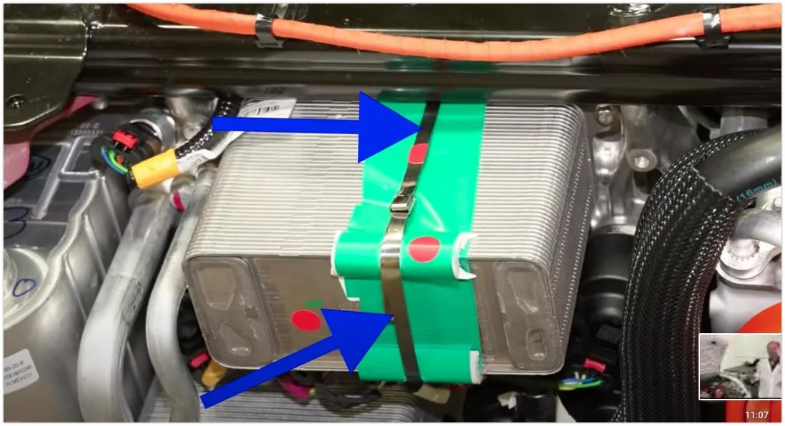

We need to get this done next week!
Engineer 1: we don’t have the parts for 3 weeks though.
Engineer 2: we can use straps from the hardware store in a pinch. They won’t look pretty but they are rated for the load.
Engineer 1 now works at GM. Engineer 2 still works at Tesla.
There are likely hundreds of cars with this workaround on them and there has never been a recall on them. Says a lot about the reliability of this quick solution.
