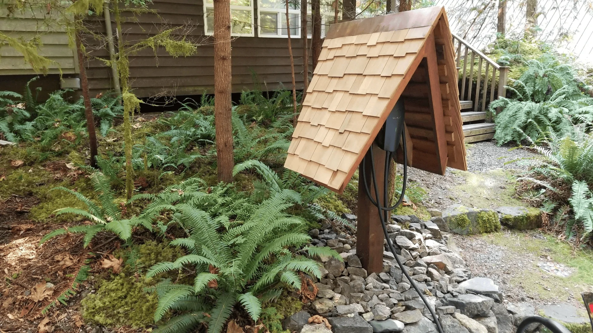

I did this install at our ski cabin in 2019 with a 60A 240V breaker, underground conduit, a 35' run of 1" Schedule 80 PVC conduit and three AWG #6 copper conductors rated for in ground use and one 35' ground wire. The cost for all electrical equipment (all copper wires, circuit breaker, conduit, and all misc. conduit fittings, pipe glue, etc.) was only $165 worth of supplies purchased from the local hardware store. It would have been less but I ran one un-needed AWG #6 conductor to "future-proof" the underground wiring run in case anyone ever wanted to turn it into an outlet and oversized the copper ground wire from the required AWG #10 to AWG #8.
Tesla Cybertruck Are you using a Residential-rated receptacle Then an EV Industrial Rated receptacle to charge? 1666761065699
I believe the end result is better than if I hired a contractor or licensed electrician because I was meticulous about every detail with an eye to longevity and keeping the oxidation of the copper connections to a minimum. It's been performing perfectly for over three years through all kinds of nasty weather without so much as a glitch. None of the connections, including the breaker, become anything more than slightly warm after charging for a couple of hours at 48 amps. It adds around 45 miles of range per hour of charging and allows me to start my ski morning with a warm cabin and full "tank" of electricity.
This was so much better than the Mobile Connector that I used through the first winter, mostly because it's faster and far more convenient.
