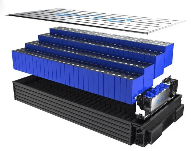

That is definitely not a structural pack. It looks like something I would build. (not high tech) The BYD blades (LFP)span the vehicle to at least eliminate the internal ribs. I think they are glued together provide a little torsion resistance through the pack as well.
All those internal ribs are counter to the whole idea of a structural pack me thinks.
Having ribs in the case does not mean the assembly is NOT structural.
As a posted before. Structural can be done with cell shapes other than cylindrical.
Some examples are BYD, Magna, Leap Motors.
But it does mean that there is structure is in the ribs and not the battery. It means the pack wastes some of its mass specifically on structure instead of batteries.
