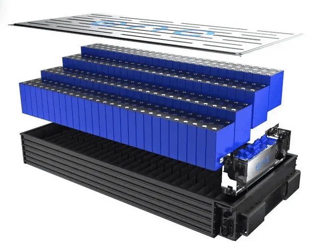

Tesla Cybertruck LFP Cybertruck one-bat-Screenshot_20220524_211743
But it does mean that there is structure is in the ribs and not the battery. It means the pack wastes some of its mass specifically on structure instead of batteries.
If the picture is accurate to rib details it shows them to be non-continuous. I would think a structural rib would be continuous. Also the height of the rib seem too short ( only 1/2 to 3/4 height of case ).
The ribs in the picture might be more for thermal cooling and as separators so individual cells are not directly pressed against each other.
I have seen several designs where packs of prismatic cells had separators (non-thermal type) between each cell with whole row of cells compressed in line.
166
10,735
27,050
Having ribs in the case does not mean the assembly is NOT structural.
My understanding of what makes a structural pack is that the batteries are part of the structure.
In this case, it looks very much like the ribs are the structure and the batteries are just dead weight.
BYD Blade cells are long and rigid which means they can be aligned to enhance the structure of the pack. 4680 cells are tall and cylindrical and when they are encased in resin become a structural honeycomb.
This pack looks like the batteries are supported by the rib structure.
Though I don’t think it much matters here because these are for heavy equipment and the extra weight won’t be a problem.

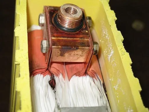

Tesla Cybertruck LFP Cybertruck unnamed%20(2).jpg?part=0

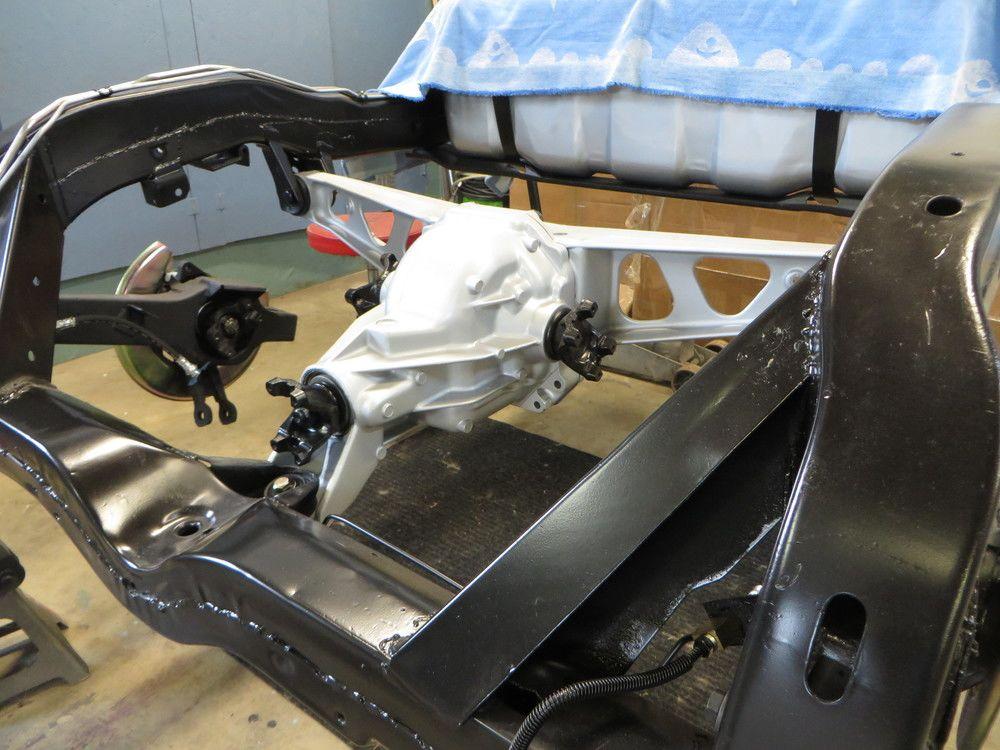

Tesla Cybertruck LFP Cybertruck 18AE83F4-8CB2-4BED-9A4C-3FD398DAE582
This photo teaches that Tesla casting its motor assy together with the inner wheel well is inevitable.
A one piece structural motor assy,wheel well casting is another step away from “parts”. Its less assembly. And it invites innovation solving axel shaft angle at max droop(read limiting factor).
Interestingly, it frees Tesla from Double wishbone rear suspension enabling trailing arm.
firsttruck
Sep 25, 2020
205
2,761
4,441
mx
none
Very interesting.
Where is the picture from (link)?
Is there more info about it?
