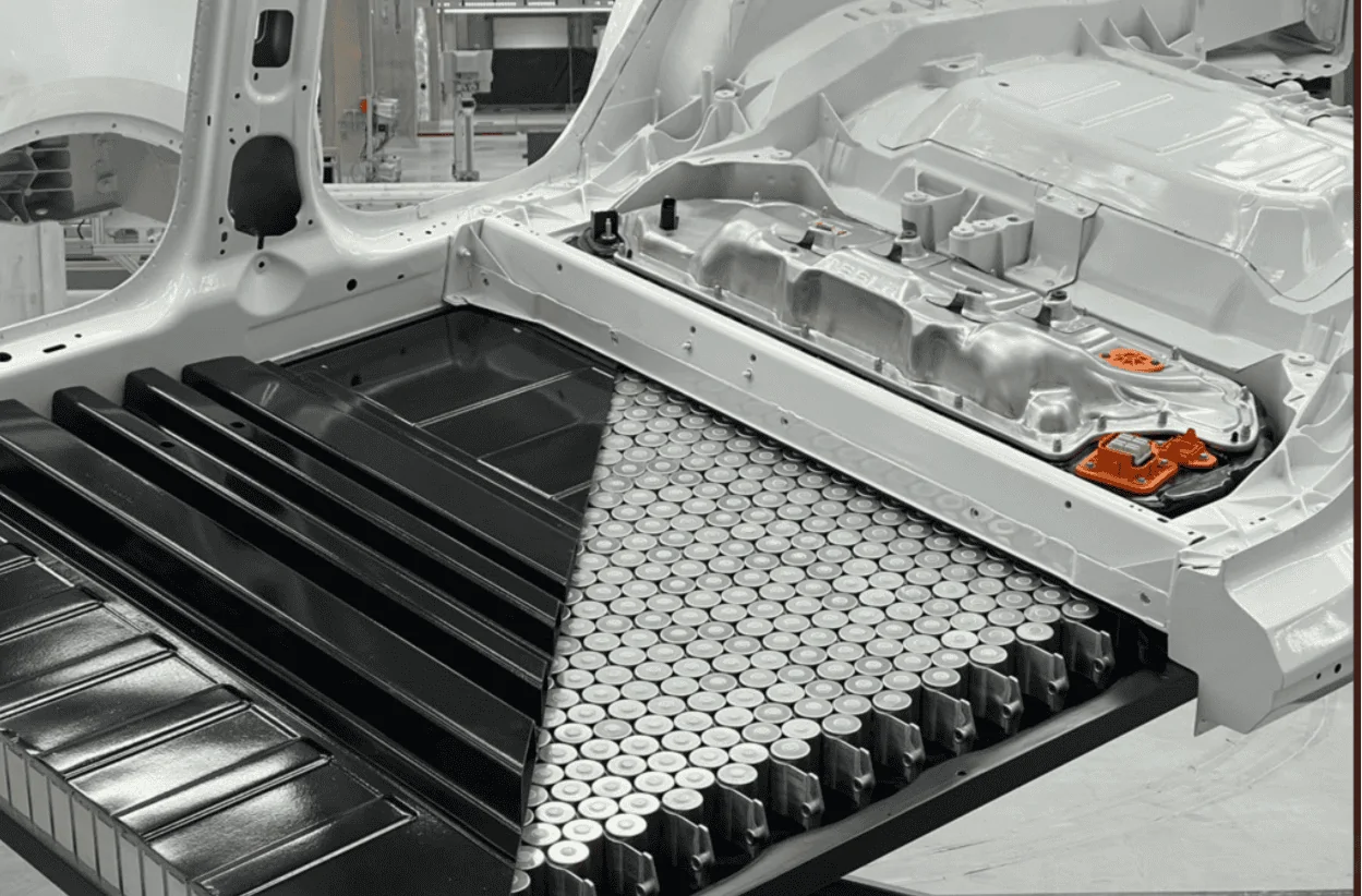

I copied an image of the model 3 strucutural pack on the unibody frame. There will be a lot of internal stamped steel. I never said the internal stuff would be painted. It will be corrosion protected and doubt it will be stainless. a lot of people on here are under the impression that the entire body will be stainless and i very much disagree. If you cant see it I bet it will be steel. like the B pillar. probably going to be steel. that will probably get painted because you can see it when the door opens. Ha! I even found it painted in this video around 10 seconds in you can see both doors open and a shiny black pillar. If you believe you are getting a 100% stainless body I believe you are very mistaken. There will be a stamped steel interior body frame with stainless steel exoskeleton panels mounted to it making a composite unibody frame once connected to the castings and structural pack. The entire structural pack will be painted steel as well! there will be A LOT of non stainless steel on that truck and I don't care if its painted or not. But I still think the 3mm exoskeleton is an incredible move and they likely are greatly reducing the interior framing due to the strength of the exoskeleton.
The Structural Battery is not part of the exoskeleton.
The shiny black B-pillar is externally visible. It is probably plastic, containing a side-view camera or the cardkey reader. But the pillar itself is part of the stainless exoskelton.
I see a lot of misunderstanding of what an "exoskeleton" really is. If the battery is structural, then, by definition, it is part of the exoskeleton.
I agree. An exoskeleton in nature is a crab or insect with very small openings. A modern jet liner has a stressed skin and could be called a exoskeleton.
There are too many openings on a CT to be a true exoskeleton. It is a unibody with some neat folded SS sheets attached to aluminum megacastings tied together with a self supporting structural battery pack with some shear and bending moment resisting capabilities. Then you glue a hell strong glass composite on top. Efficient and strong yes. Magic exoskeleton no.
An exoskeleton says nothing about the size of the openings. Almost the entire underside of a crab is openings, for the gills.
And when the doors are closed, a Cybertruck will have fewer openings than a crab.
Everything else you said is true.
I think we are arguing semantics. The structural pack adds rigidity to the exoskeleton, but so does the windshield and the roof. It all works together, but the exoskeleton is still an exoskeleton when it has neither the pack nor the glass.
We need a philosopher to settle this. Elon...?
