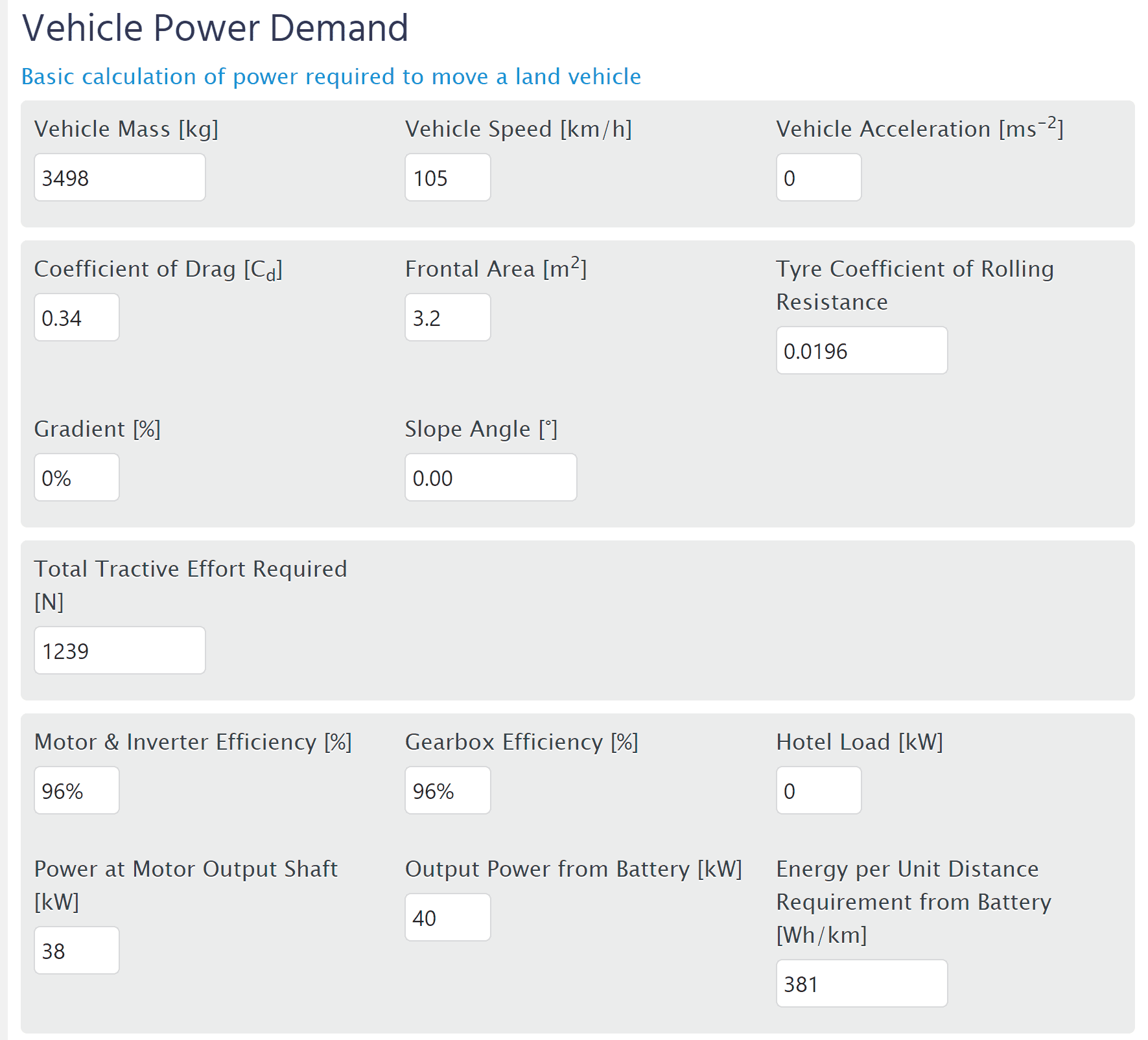

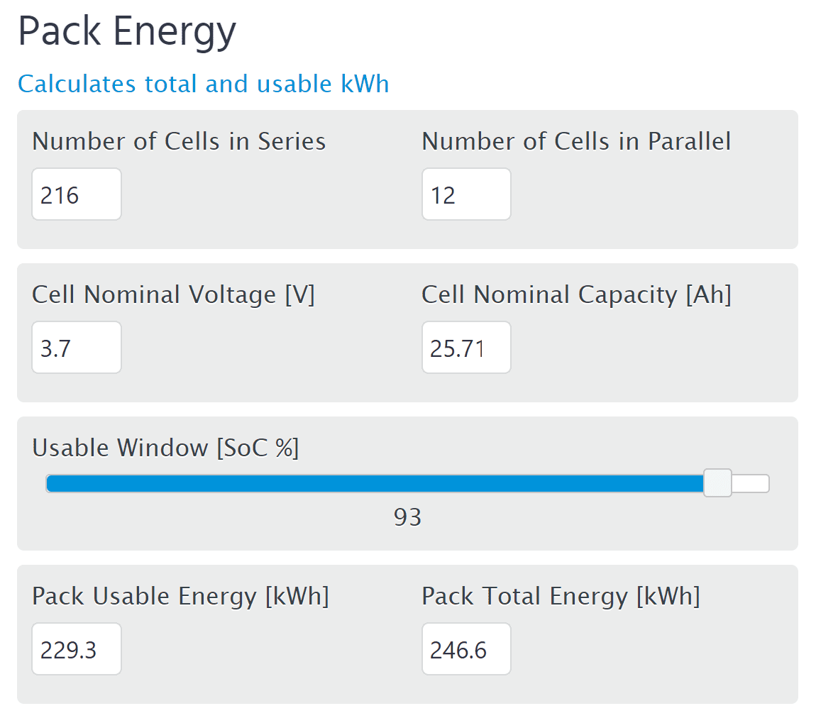

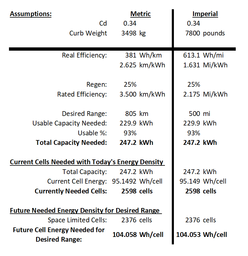

Your curb weight is too light for a 500+ mile model, but please explain your "25% regen". That sounds like a lot of braking to me. Curb weight will generally have a smaller influence on real world range compared to how much regen braking there is. I think around 185 kWh of usable capacity is a good estimate for 500 miles of range.
The Technoking comment was more of a joke.
https://www.batterydesign.net/tesla-cybertruck-and-battery-pack/
I was using this website tool to rate the efficiency and their resulting logic to rate range with a 25% gain for regen. I have doubts that a 500 mile pack fits in cybertruck with today's energy density. I estimate about 1200 batteries per layer, so 2400 max with two layers.
0.3 Cd is far-fetched, maybe 0.34 with the diaper. As for weight, I believe a pack with 2376 cells is more about 7800 pounds. I ran the number before off some wild ass predictions I've heard on X spaces. They were saying 500 miles was coming from a 130kWh pack @ less than 6000 pounds :rolleyes:.
These are my projections using the website tool.

I'd like to start a new dedicated thread tomorrow to discuss CT performance, charge and range predictions and calculations in detail. These interest me.
Great idea because I think predictions are better with more feedback/correction.
I've been running calcs on different pack sizes and weigh estimates and how they effect range, curb weight, 0-60, payload, towing and weight ratings. We have a wide range of technical experience and nonsense on the forum. Once I get some feedback on my predictions, I'll know what category I fit into.
It would be nice to get some real grounding before launch event so we don't go into it with unreasonable expectations. Also, what limiting factor do we need to monitor progress on to meet the goals of the customer in the future.
