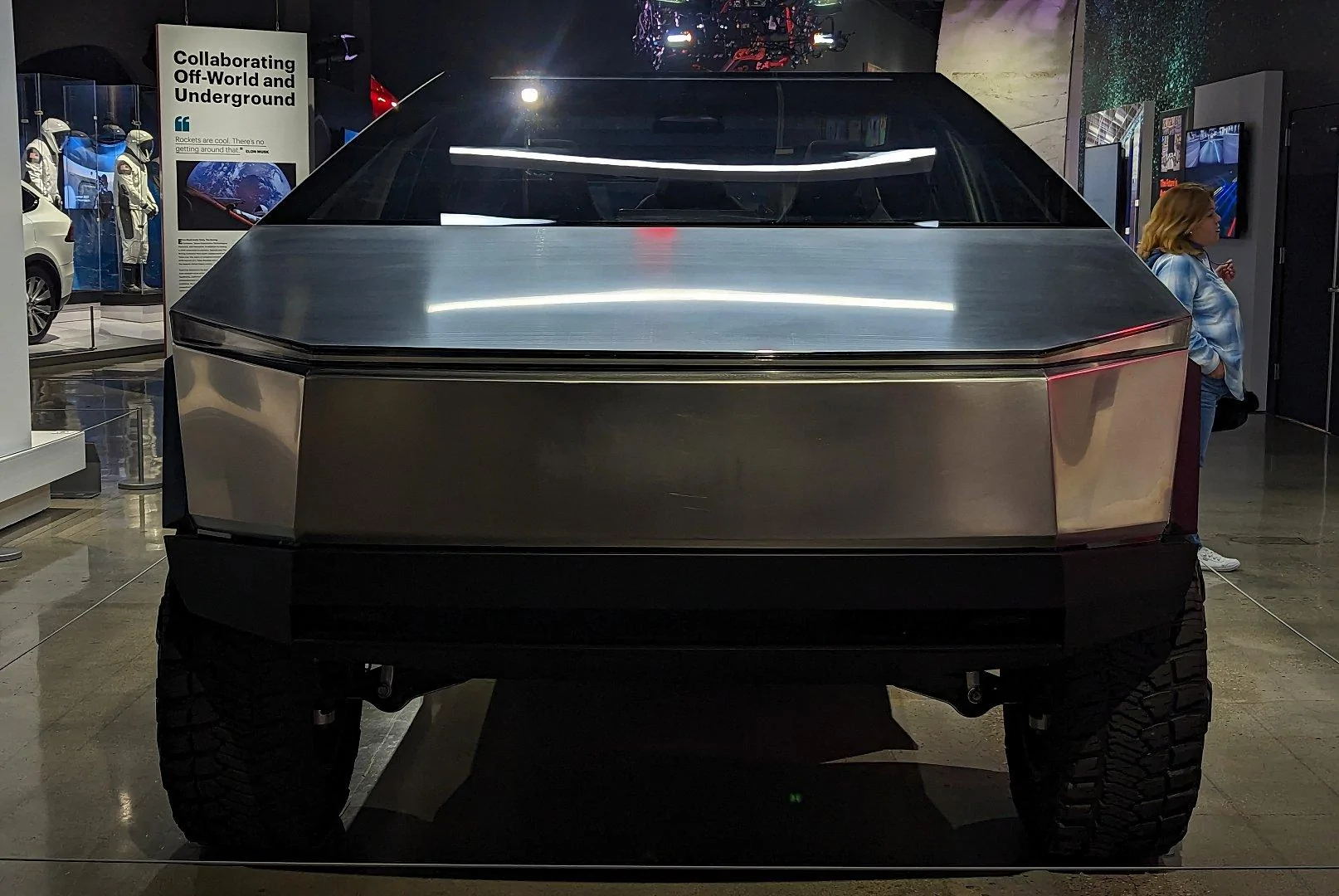

Two things I'm still struggling with deciphering is just how much the front windscreen is curved, and from where, and if the CT sidewalls are curved front to rear in a long gradual bow, or if they are in fact completely straight. I believe a curve would be better for aero.

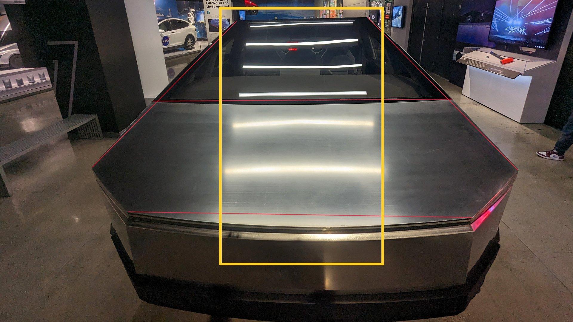

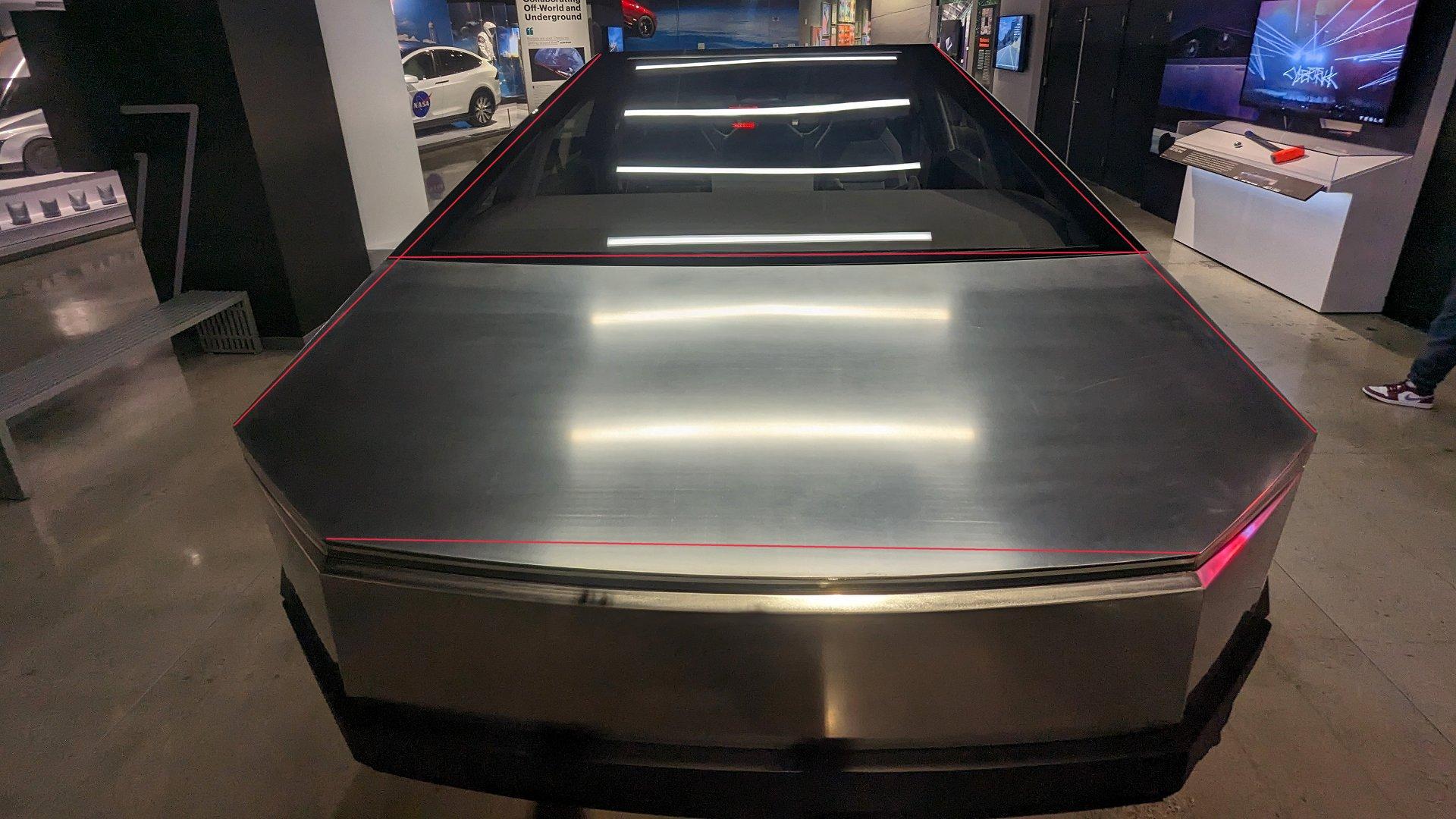

Here's a couple of photos I took of the prototype CT at The Petersen Musuem. I added straight lines to make it easier to see the subtle curves.
Tesla Cybertruck Midgate a No-Go (Assuming Tonneau Patent)? topwithlines
Tesla Cybertruck Midgate a No-Go (Assuming Tonneau Patent)? linesfrontqtr

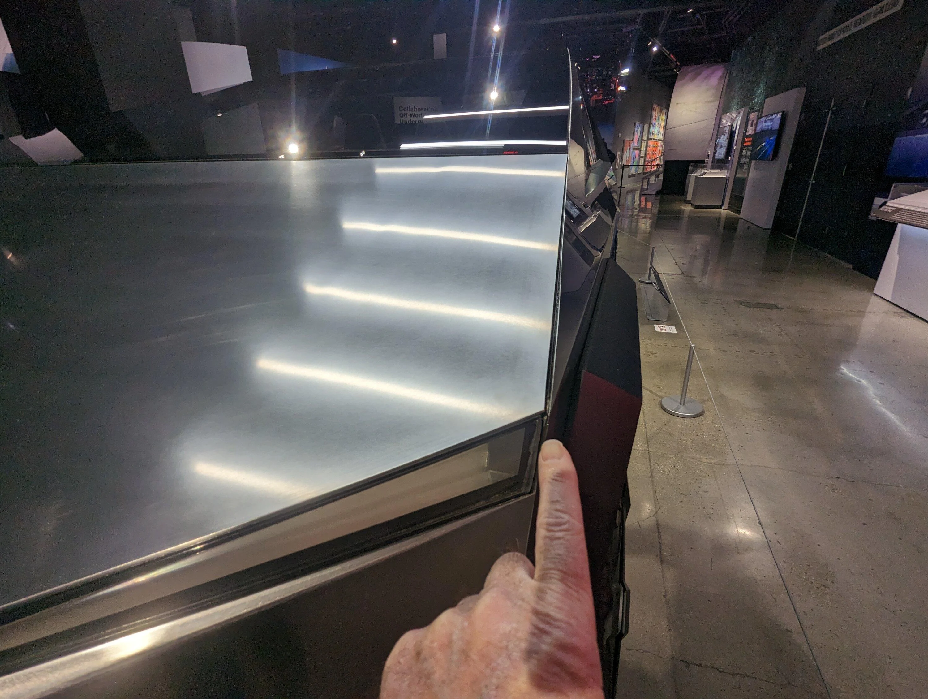

photos are tough because the pens can curve even straight lines
the reflections of the tube lights on the glass, on the other hand, do indicate convex bend at the center of windshield glass

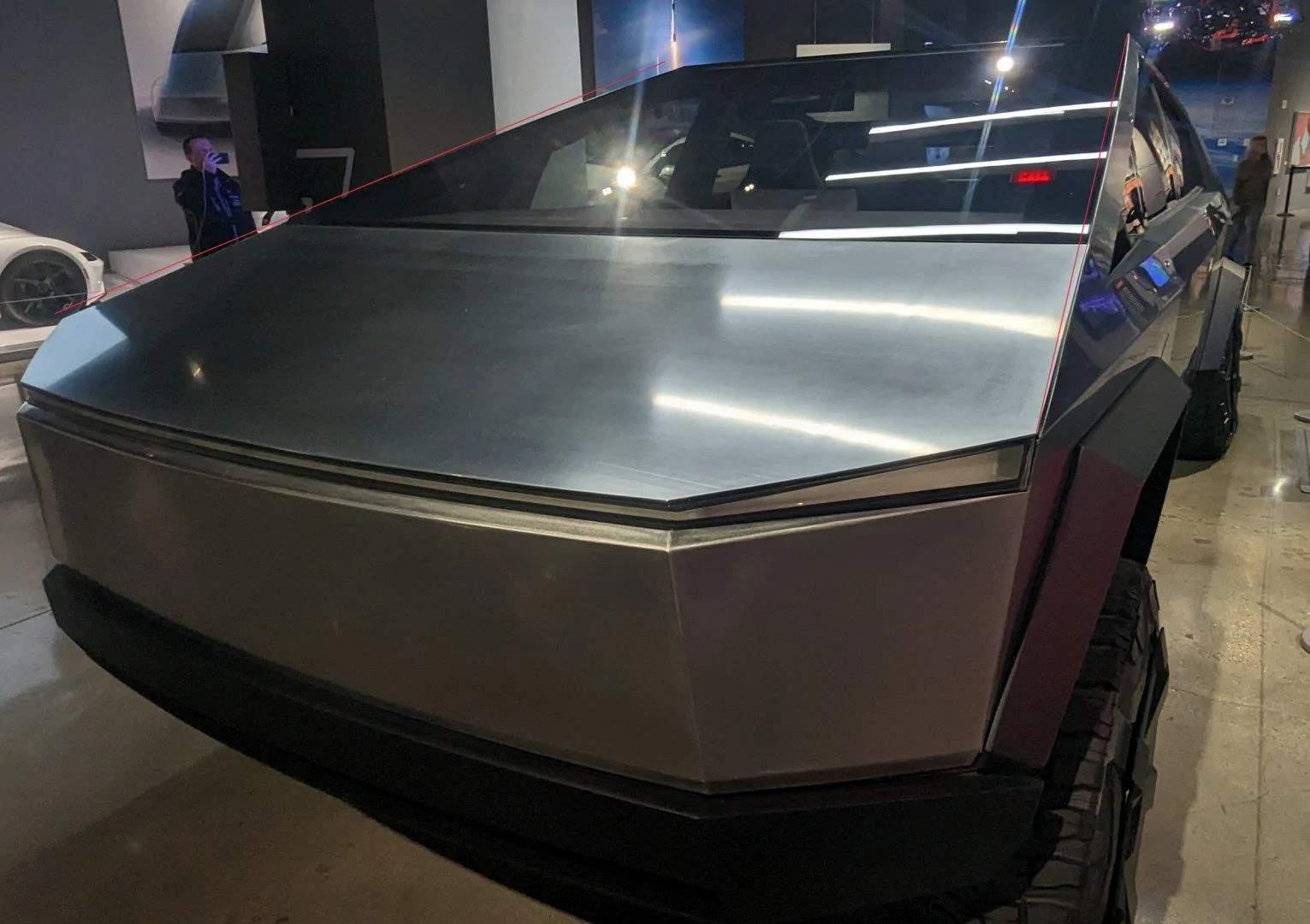

Exactly!
Here's an even better photo showing those reflections being curved by the windshield.

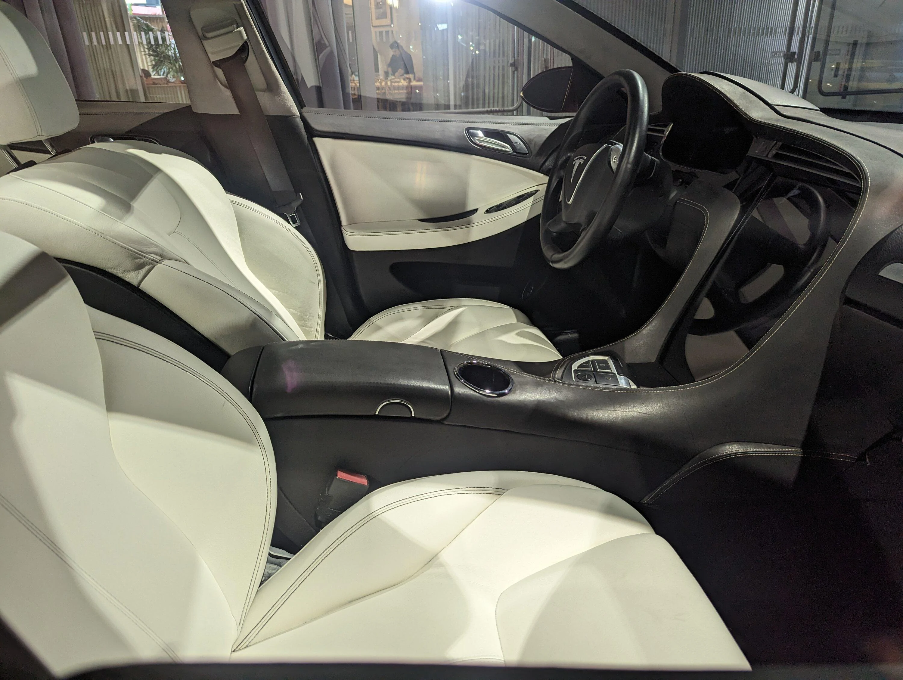

Definitely not enough for anything like that. One thing that was very apparent to me was that this CT is a concept car. The metal skin is very thin, not even close to 3mm and that stainless steel bed is the stuff dreams are made of. There's no way Tesla was going to build something like that and sell it for $39,900.
A few months after the reveal, Jay Leno and Elon did a drive and filmed a segment of Leno's Garage with it. In that video Elon said "I hate when car companies have a show car, and then the production car is nothing like it, we won't do that".
So this was Tesla's show car to create interest, and what they are going to produce will be similar, but nothing is set in stone. Therefore, when I was at the museum. I enjoyed it for what it is. It's the start of the revolution, prototype #1. They had several vehicles there that were of the same pedigree. The 2017 Concept Semi was parked in the parking garage. And the original 2009 Model S concept car was there too. Lots of great information about Tesla as a company. And how the media portray them as never going to make it.

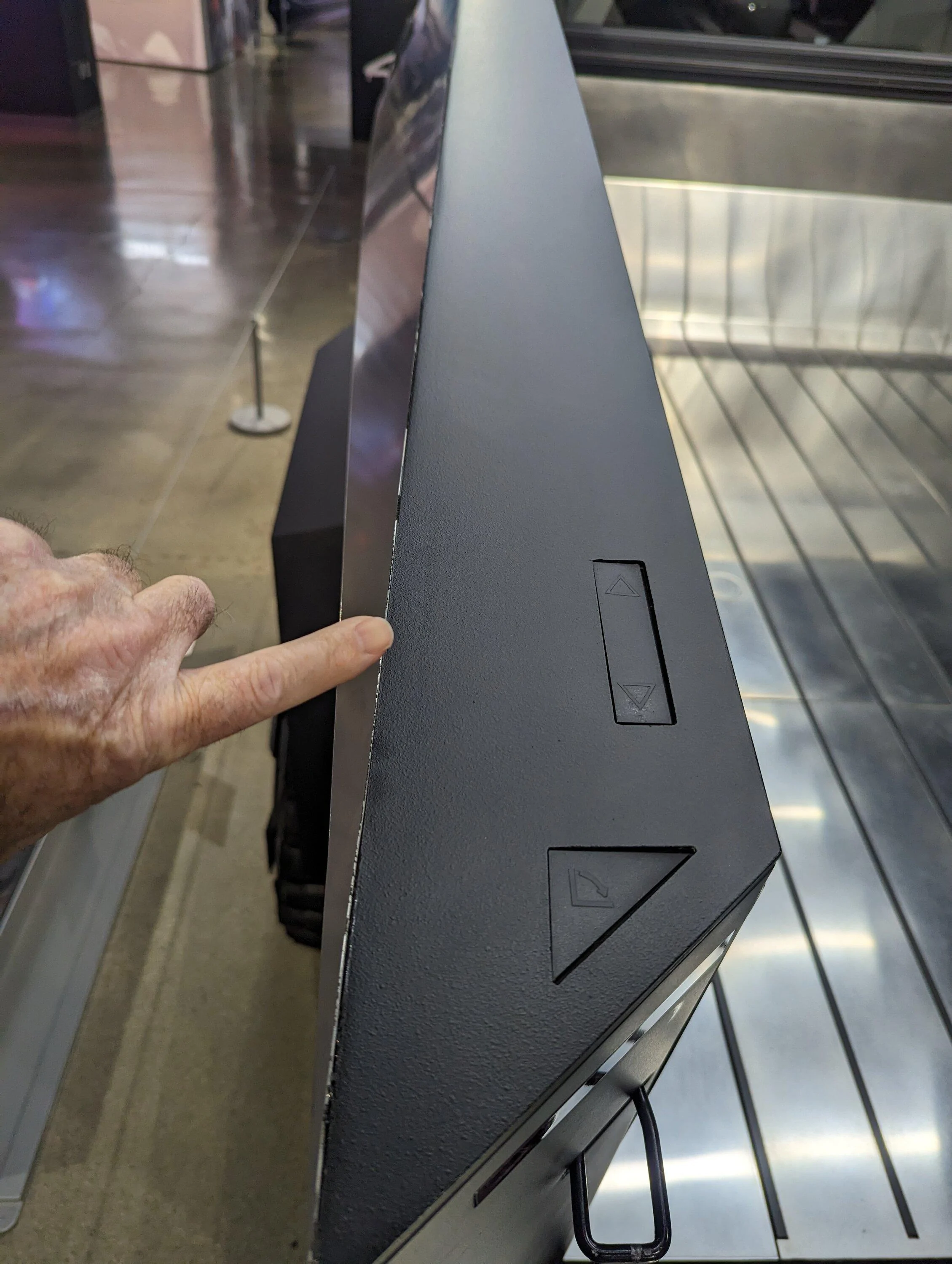

I’m not saying this is likely, but in theory something like the following could possibly make for a window that rolls down - but I’d say it requires the rear window to be at an angle leaning towards the bed
edit to add, the investor prototype window does appear to reflect the bed/tailgate, suggesting that rear glass could in fact be at an angle
On that angle it might be possible, but there really isn't that much room behind the rear backrest, and the assembly would move the seat further forwards. Although I wouldn't mind having an opening to the vault, what would it be good for, being so low you can't get through it? I fear people might use it as a passthru to put longer items into the cab, and those longer items would then be dangling around at head height. Rather have a center armrest passthru, that either terminates behind the center console, or even goes through it Bollinger style. At least it would be more contained.
We once talked about an alternative vault cover, using a peice of glass stored in the rear cab roof. It is missing about 10" to work dimensionally, but would be possible. Good thing with a peice of glass is that it would be much cheaper than the vault, and always be out of the way of the bed, loads and possible midgate. Could also easily embed solar in the glass.
for what little it’s worth, I do think it’s possible the glass is angled just so (based on that reflection photo), and no doubt it would move the back seats that much closer to the front seats. Maybe 1”? 2”?
as for the utility of the back glass going down, I personally would enjoy it for airflow with all the windows down and the tonneau open. I probably wouldn’t trade that for 1-2” of back seat room, though.
Others appear intent on sleeping in the vault with heat/aircon. Vault seems right to me, but I’m a bit large and non-clinically claustrophobic.
More than that, given the CT’s materials, I just imagine that vault getting so hot/cold, even if insulated, that a mere rear window to cab doesn’t circulate air well enough to have the desired effect. Perhaps if just above and inside the rear window there is a vault-facing air duct?
In any event, the rear window being mobile seems a challenge given the bulkhead shape/tonneau function - but not insurmountable. Real question is if the cost (money or function) of it is worth the benefits.
