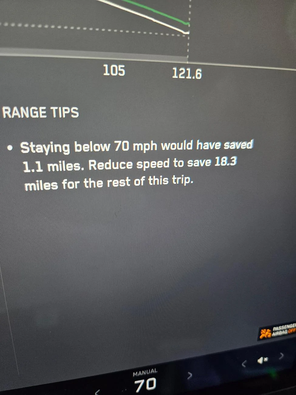

I just drove from st Augustine to new Orleans. The AC is biggest drain on battery. Even when charging it eats up 4 mph. Next is speed. 68 is best.
I will attach message I got00
