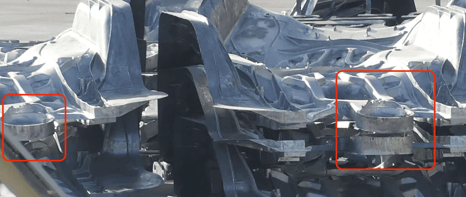

what are those round things ?

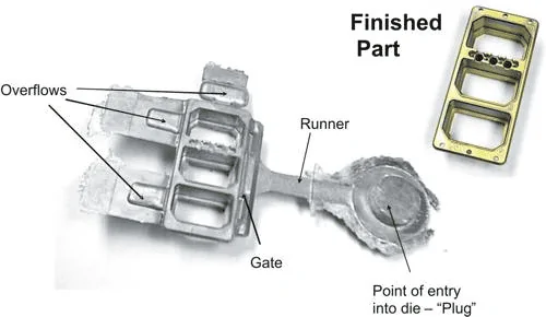

Sprues or injection sites. You need a spot where the cast material enters and where it's exiting to, and you use the part that was made in-between.
It might also help with grasping the hot piece as it comes out of the press.

Call me crazy, but I think that circle part may be a spare tire support. If you look at the casting where the outer diameter of the tire would be it seems circular too. That’s really the only thing that makes sense to me.

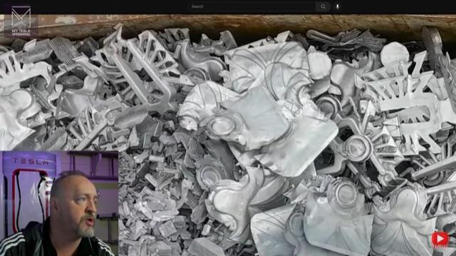

here’s where that is headed - it’s a forming piece of the casting that is cut off and thrown in the trash
covered already, earlier in thread

... it’s a forming piece of the casting that is cut off and thrown in the trash
... thrown in the trash back in the smelter for recycling.
There, fixed it for you. ? ?
