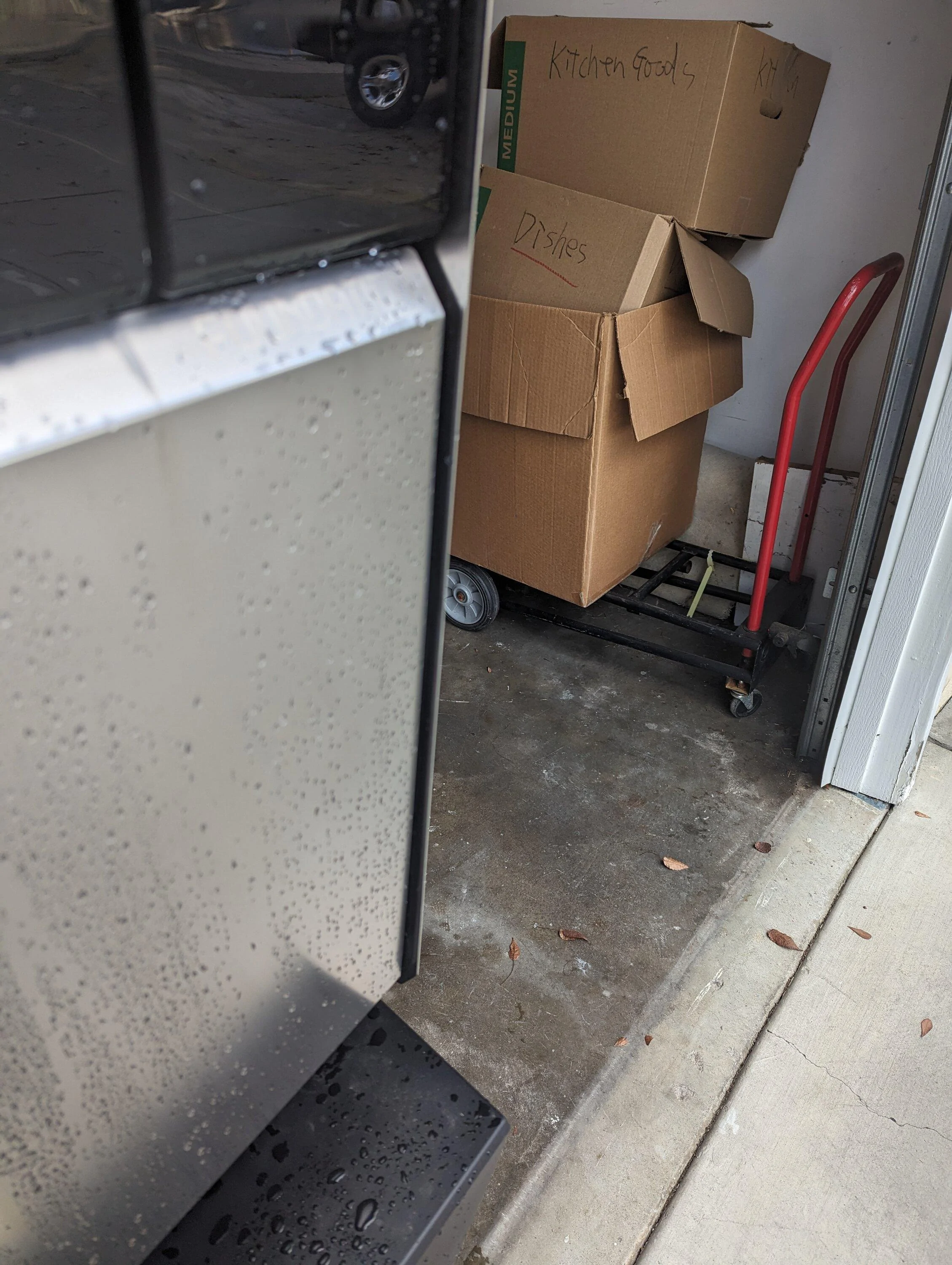

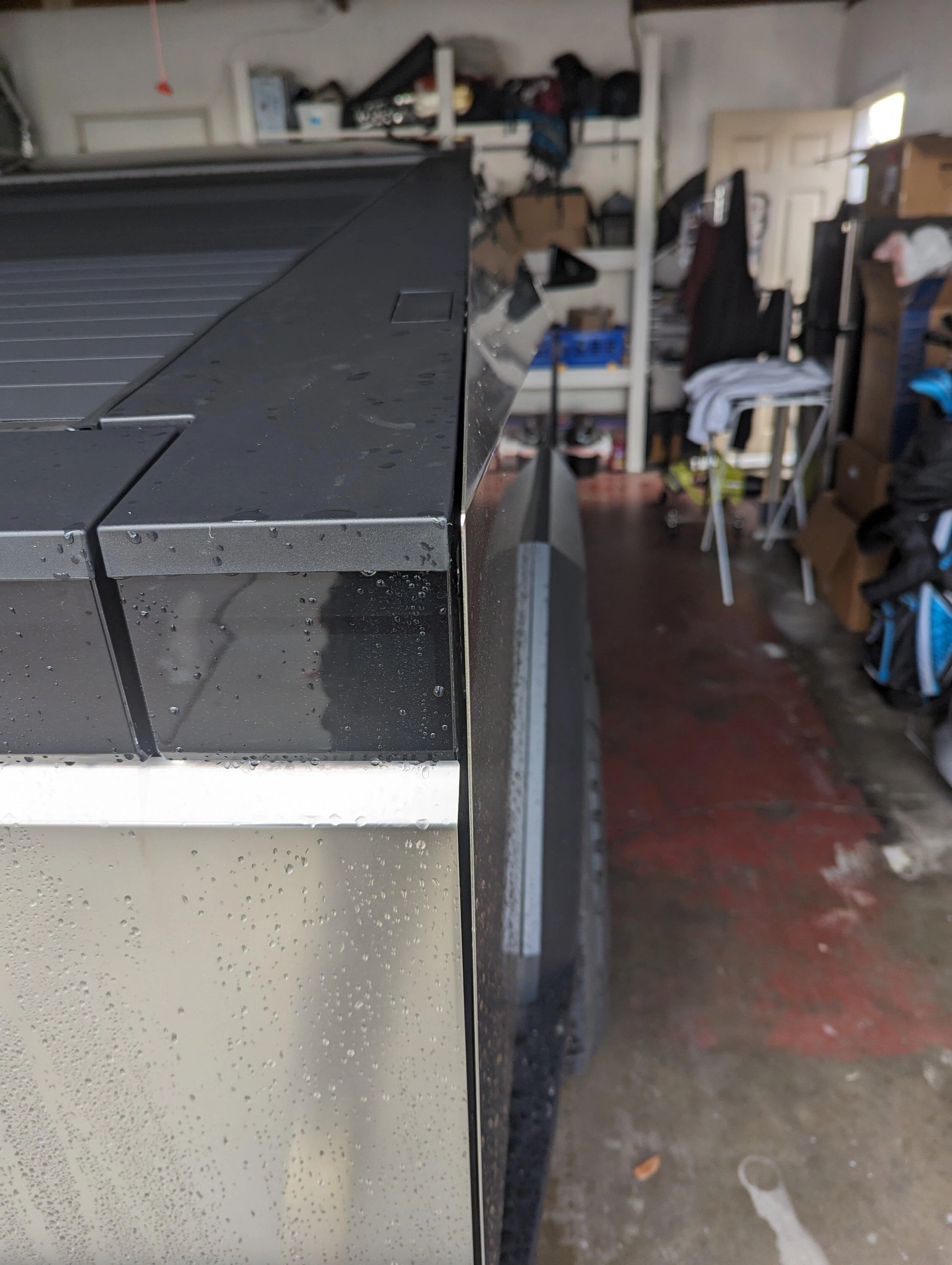

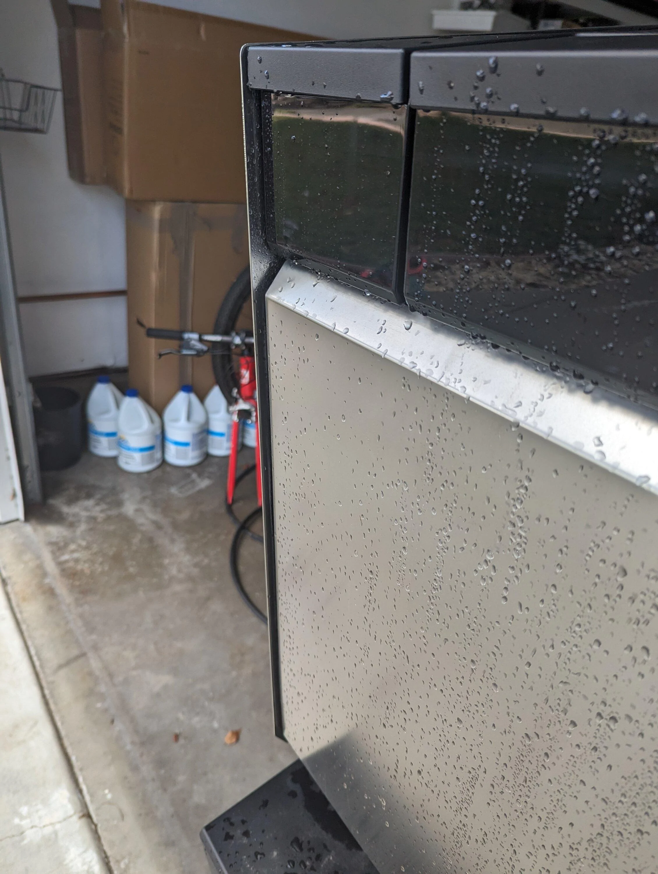

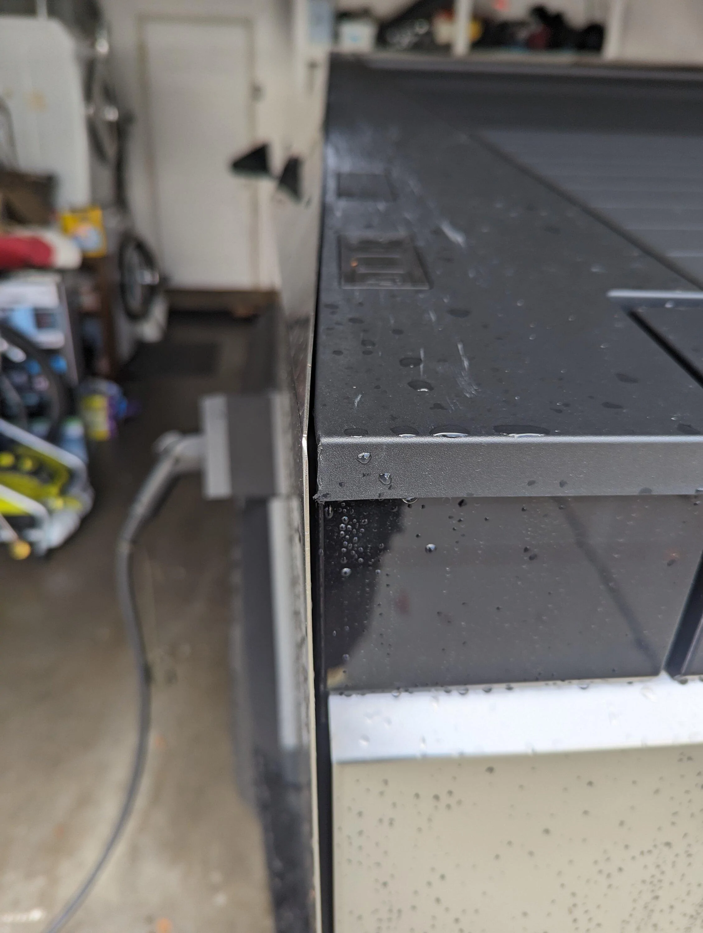

- rear panel gap. left side was OK, but right side was a little bigger gap: I compared with two other CTs on the lot and found all had the same gap, actually one of them had much bigger gap on the right side. but looks like these are within spec:(
- hard to see from pic, but internal white materials was not finished flat, a kind of waving, maybe after long rain with moisture?
- also extremely hard to tell from pic, some part of steel panels were dirty, its a little whitey like a dust surfaced. Sales rep called service person to wipe it. He brought some spray cleaner and wiped, but did not go away. he looked tired of wiping(maybe from all rains), shaking his head and told me that was best he could do. Maybe I can clean it with special formular, but I confirmed my decision to wrap was right.

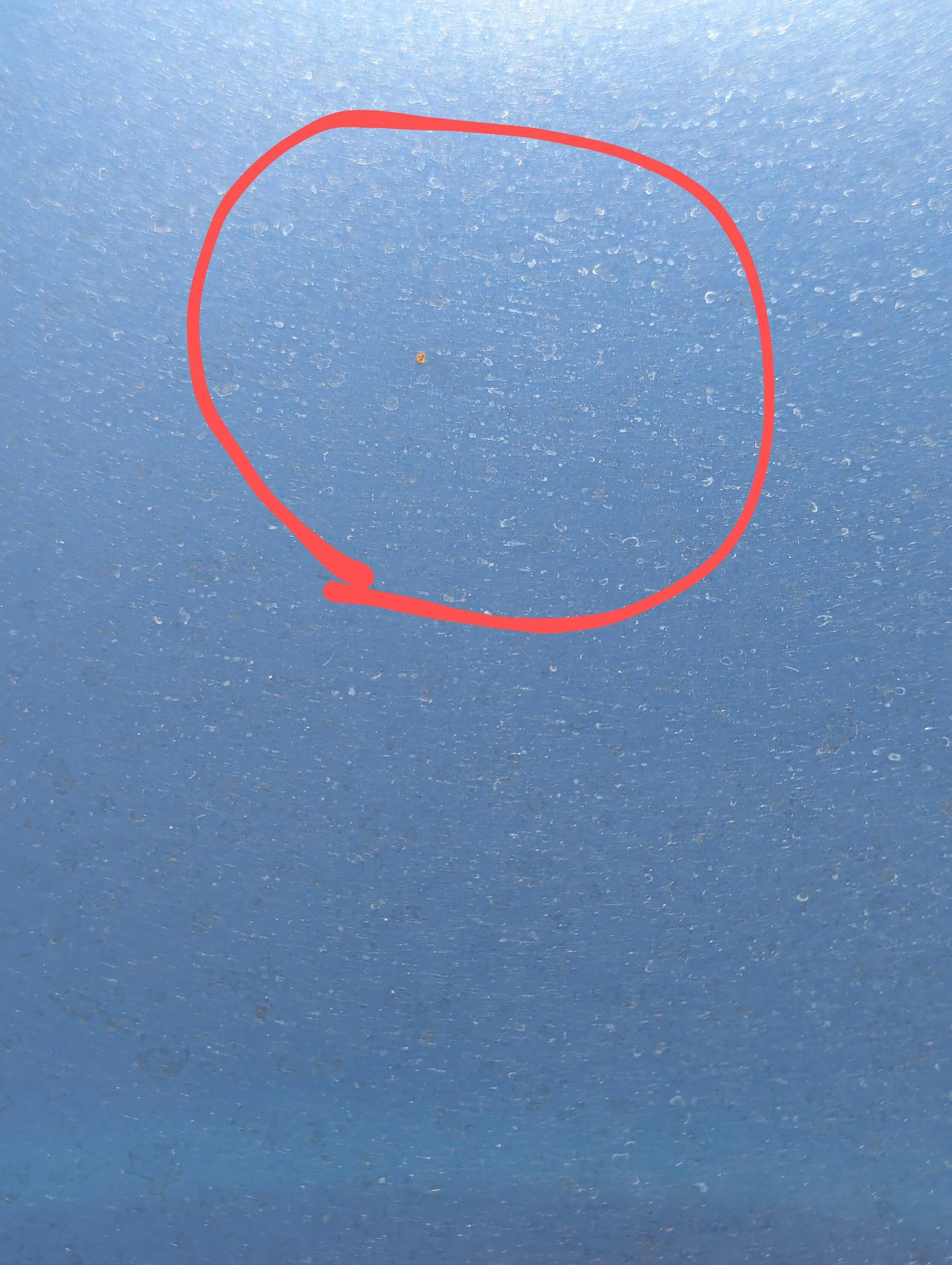

Just found a small orange rust yesterday.. only one on the frunk area, but concerning since its only a couple of weeks after build. In the past I left a brand new stainless steel plate (for hood) in the back yard for a year, then this orange rust were all over. Hope CT wont be like that. another reason for me to wrap.

Unlikely that this is corrosion or oxidation. The CT will not require a wrap, just as DeLoreans did not require wraps.
This is most likely rail dust. It should be removeable with a clay bar.

That rust speck looks on top of the stainless. Just pick it off with a small stainless pick or something. It's likely from a grinder, and not actually part of the stainless surface. But anyway, the idea is basically to not rub it in more, then just lightly clean the surface (using almost anything but windex) and it should be good to go.

Difficult for us to tell based on that pic but if I zoom in it looks like that orange flake is sitting on top of the panel, not in the panel. Could be rail dust, pollen, dirt, etc.

I imagine (and hope) it buffs out pretty easily. That said, I am thinking snow/salt areas will not be ideal for this until wrapped. I guess same could be true to being close to the ocean.

I did not want to make it worse, so did not use any serious remover, just use soft material to wipe it out, but never go away. it's not pollen, dirt. it's a rust but not sure it's on surface or from inside. I will wrap it. so won't do anything any further.

It's not the panel rusting, it's a surface contaminant. Don't baby the hard frickin' steel, just scrub it off and give it a quick polish with some wax or something so more stuff doesn't stick to the surface. You need to scrub off all those minerals anyway. What splashed on it to leave all those white minerals anyway? It looks like something caustic. Scrub it off of there.
People whyo are concerned about orange surface rust must not have ever cleaned their 18/10 stainless silverware or owned a stainless barbeque that was left in the weather.
I actually think a wrap might prevent oxygen from getting to the surface of the metal which could be a bad thing. Ironically, oxides protect stainless steel from oxidation. The chromium in stainless steel reacts with oxygen in the air to produce a protective chromium oxide layer across the surface. Although very thin, this layer is what protects the metal from corrosion and why stainless steel doesn't turn orange while mild steel flashes orange as soon as it gets exposure to air and water.

hummmm. not sure if I understood you 100%, but Tesla provides wrapping service as well, so it's should be ok solution, I believe.

I am going to wrap at Silicon Valley AutoSpa at Fremont. I asked about a rust, they said they apply "rust protection coating" to avoid future damaging for all vehicles before wrap. I selected PUREppf satin bullet for wrapping. can not wait !
