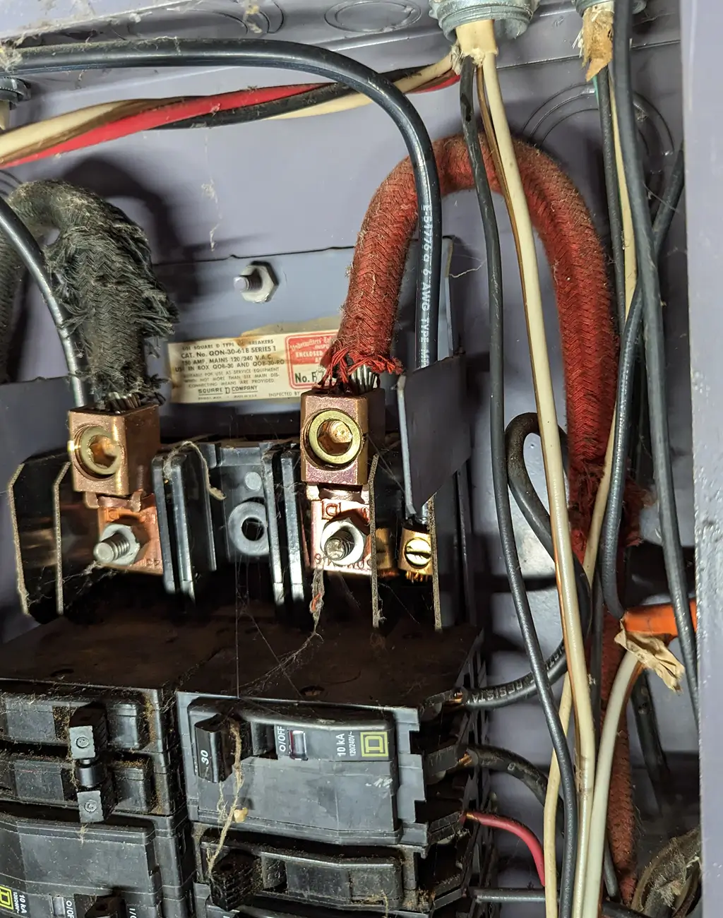

My dad's house is of a similar age. I'm looking at major electrical changes needed. The fuse box in the garage is a very early Square D QO box. Notice what is not at the top of the fuse box. Disconnect is out at the electric meter. The L1 and L2 come in the bottom of the fuse box along with the neutral. Most of the house wiring is two prong without ground. Some new circuits have been put in with grounds. By local code if the wires after the meter are touched, then they must be brought up to code. Cloth insulation is no longer allowed. That means they have to be replaced, and the fuse box must also be replaced because it doesn't have a mains breaker. If the fuse box is touched, then all the house wiring must be brought up to code. Oh, there also is a sub panel in the kitchen. It also doesn't have a mains breaker. At least all the circuits on it are up to code.
If you read the label it says "Suitable for use as service equipment when not more than six main dis-connecting means are provided." That was the old NEC standard. Last I knew it's now six actions. Opening the fuse box door is an action. If you turn off all the breakers in the top 1/3 of the box, all power to the house is turned off. Two of the breakers in the top third control power to the right lower 2/3, and left lower 2/3 respectively. Another controls power to the air-conditioner. Another controls power the sub panel in the kitchen. There is another for the EVSE. Opening the door is another action. Am I under the 6 actions limit to turn all power off that is now required? If it wasn't for the cloth covered cables.

I chose this photo because you can see and read the important part of the label. (I did blow the cobwebs and dust out after taking the photos.)

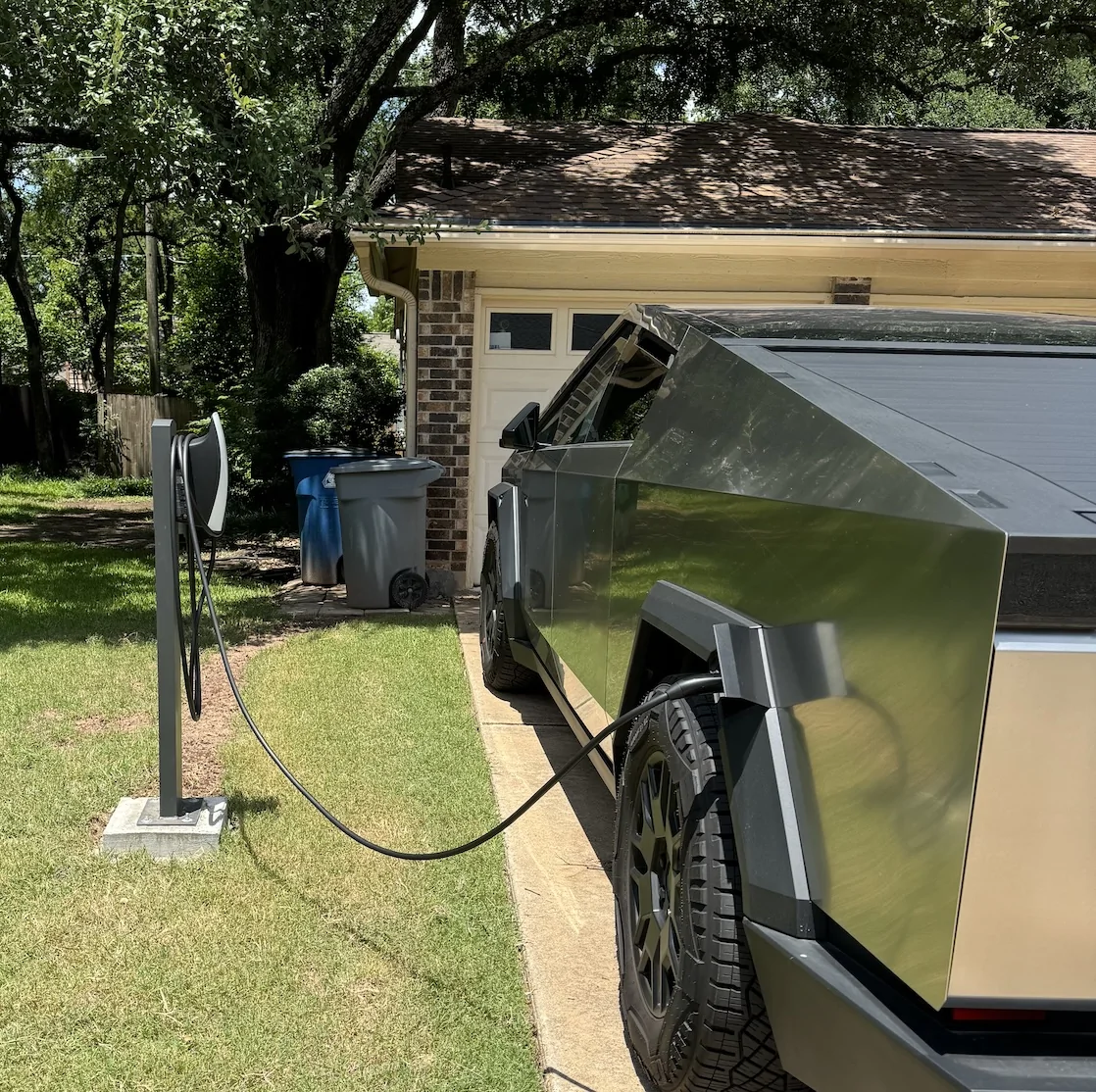

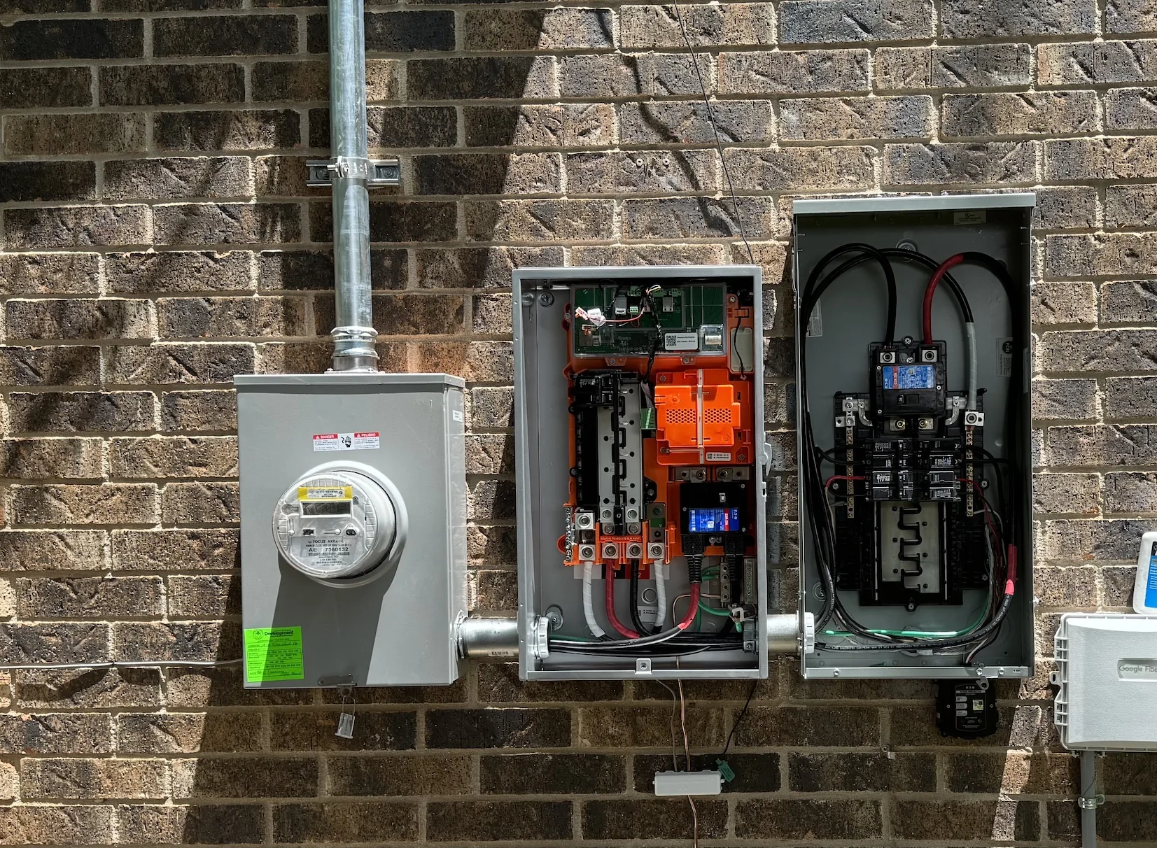

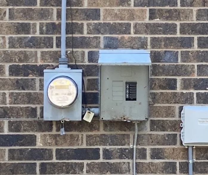

My electrical service was 80's vintage, with no main breaker, utility line attached directly to house instead of a riser pole, etc. My Powershare installer took one look and said "lol no".
I ended up having it all replaced, all the way back to the pole. It's now all brand-new and up to code, but it was a $10k job (including the UWC installation). The subpanel inside remained.
Before:
Tesla Cybertruck My home power backup without Powershare solution/ neutral-ground bonding/ transfer switch options/cold temps IMG_2746
After:
Tesla Cybertruck My home power backup without Powershare solution/ neutral-ground bonding/ transfer switch options/cold temps IMG_0115
Tesla Cybertruck My home power backup without Powershare solution/ neutral-ground bonding/ transfer switch options/cold temps uwc charge pedestal
I've powered the house multiple times with PowerShare (including A/C).
And yes, they used a LabelMaker instead of a Sharpie lol.
