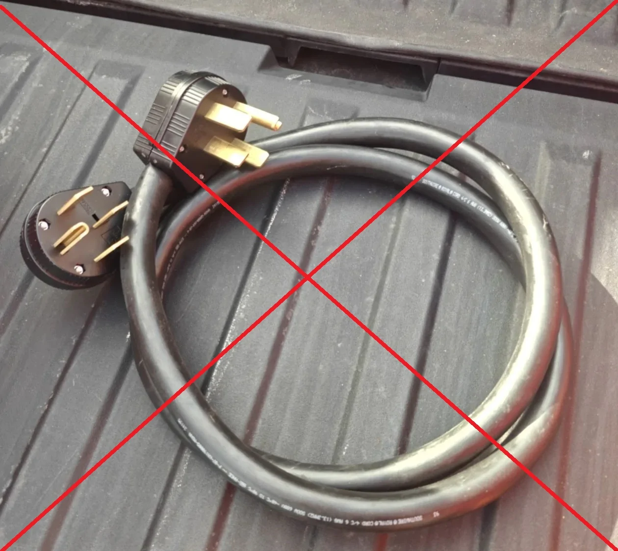

Well...if you already have a NEMA 50AMP charger outlet in your house and get into a jam, the absolute cheapest way (provided you fully understand all principles of electricity and safety) to power your house is this...and with adapters you can power up anyone's house with a 220V appliances plug :)
Has come in handy a few times, just sayin' :)
Please don't promote this deadly cord:
Tesla Cybertruck My home power backup without Powershare solution/ neutral-ground bonding/ transfer switch options/cold temps Unsafe Generator Extension x

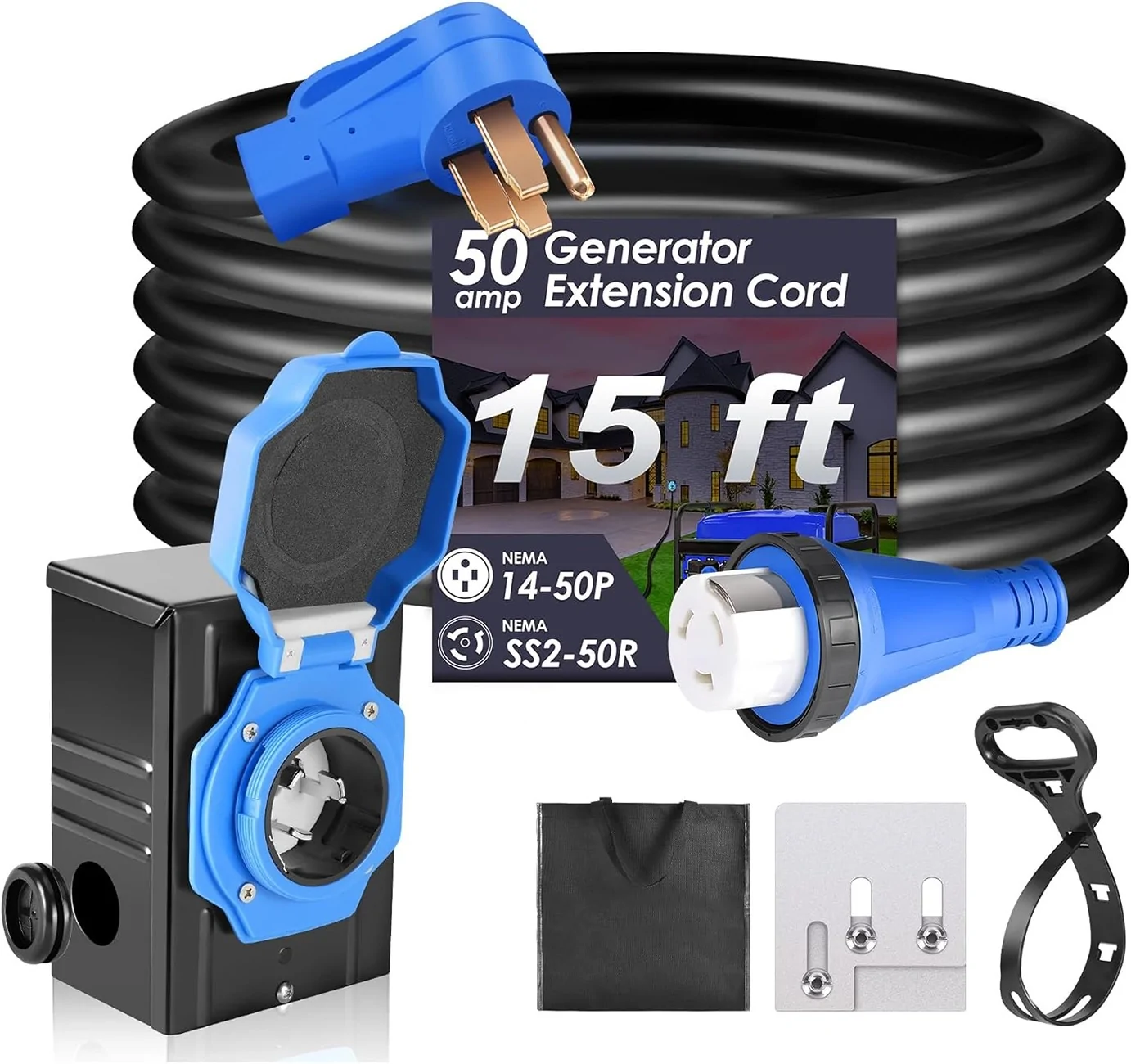

There are plenty of kits available, and very affordable, see for example:
50 Amp Generator Cord,​
NEMA 14-50P/SS2-50P Functional Cable,​
Power Inlet Box​
Interlock Kit​
ETL Listed​
$ 90 - 15 FT 50A Extension Cord​
$106 - 20 FT 50A Extension Cord​
$130 - 25 FT 50A Extension Cord​
$160 - 30 FT 50A Extension Cord​
$220 - 50 FT 50A Extension Cord​
Tesla Cybertruck My home power backup without Powershare solution/ neutral-ground bonding/ transfer switch options/cold temps Generator Interlock Extension Kit
Ah, yes, a "Suicide Cable", super handy lol.
