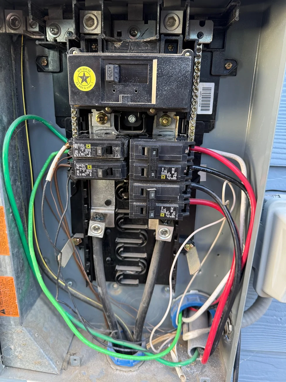

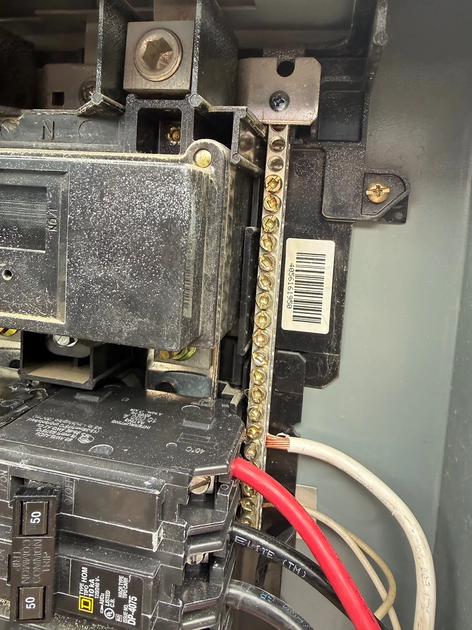

My attempt to install a 50a generator inlet plug and use my Cybertruck as power source for my house (2002) unfortunately wasn't successful. As soon as I activate outlets from Cybertruck, its 240v outlet trips. Near zero loads (<20A) from my house.
Generator inlet is wired correctly: neutral to ground show continuity, as desired. If powered from grid, hot 1 to neutral or ground is 120v. Same with hot 2. Hot 1 to hot 2 is 240v.
However, my detached garage's electrical service panel has utility drop/service entrance from grid, as well as sole meter on my property and is labeled "main service disconnect." I think the issue is neutral and ground are not bonded. This service panel sends power to my house, about 20 feet away.
House aka subpanel has neutral and ground bonded: green bonding screw is clearly visible. This doesn't make sense from NEC 250.24 perspective (says neutral and ground must be bonded at first point of disconnect) and is likely why the Cybertruck 240v outlet trips immediately after enabling the outlet.
At this point I am out of ideas and likely will call electrician...

What does your generator inlet connect to, specifically?

Dedicated 50a breaker (top right). 6 AWG. Neutral wire from generator receptacle connected to neutral bus bar; ground connected to ground bus bar.

And the 60 amp feeds your whole house?

60A breaker in right/2nd position is for my Tesla HPWC. The visible 2 black cables at bottom of panel send 150a to the house. Also large wire on left is neutral from this main panel to house sub panel. Incoming 150a from grid is top of service panel.

Oh I understand now. In that case it would seem to me that you have the same situation that I do, in that your generator inlet first feeds a panel that is not neutral-ground bonded, and that panel then feeds circuits on another panel that is bonded. I'm not sure why you're tripping on the truck end, but you could try disconnecting your ground from the inlet to that panel and trying it, and it may answer some questions.
