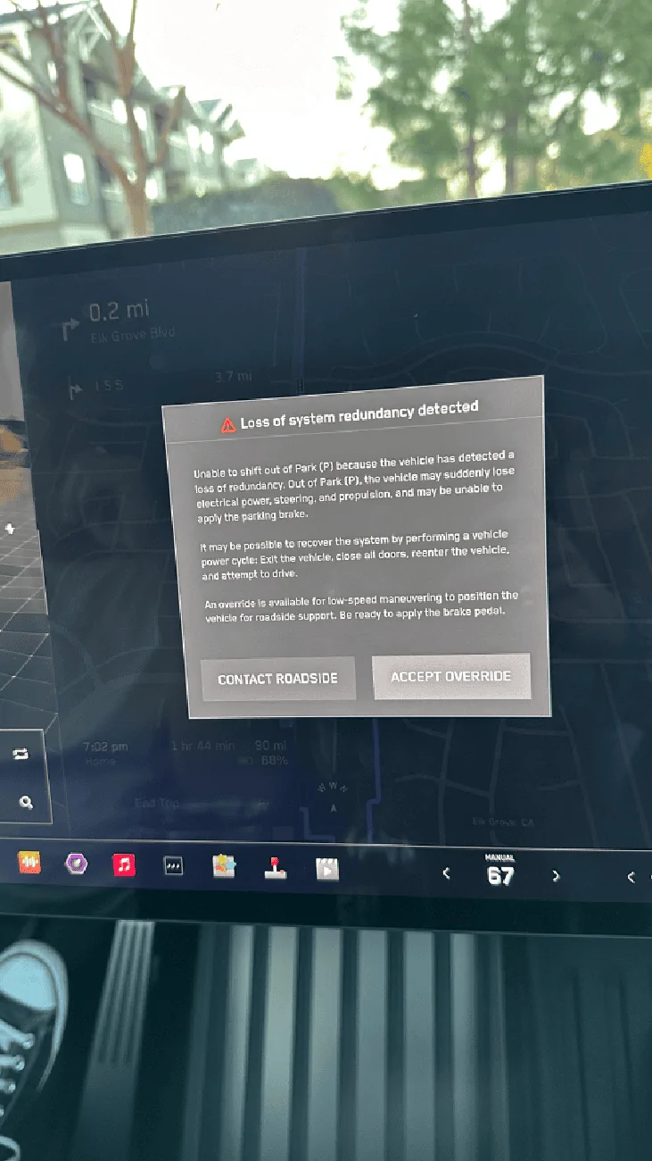

When the failure happened it said the rear wheel steering was disabled (amongst other things like AC, Adaptive Ride Height, No Charging, No Brake Regen). So I only had the front two wheels turning like a normal car.
What ever was the cause, took out several other systems. Below is another photo from yesterday to give you more insight.

In the older Tesla with traditional 12V lead-acid car battery, you will receive numerous error messages from multiple systems when the 12V battery dies.
yeah this reminds me of the model 3s that had the 12v die in them early on.
I wonder if the 48v battery isn’t being charged properly by the truck? I guess we will find out soon.

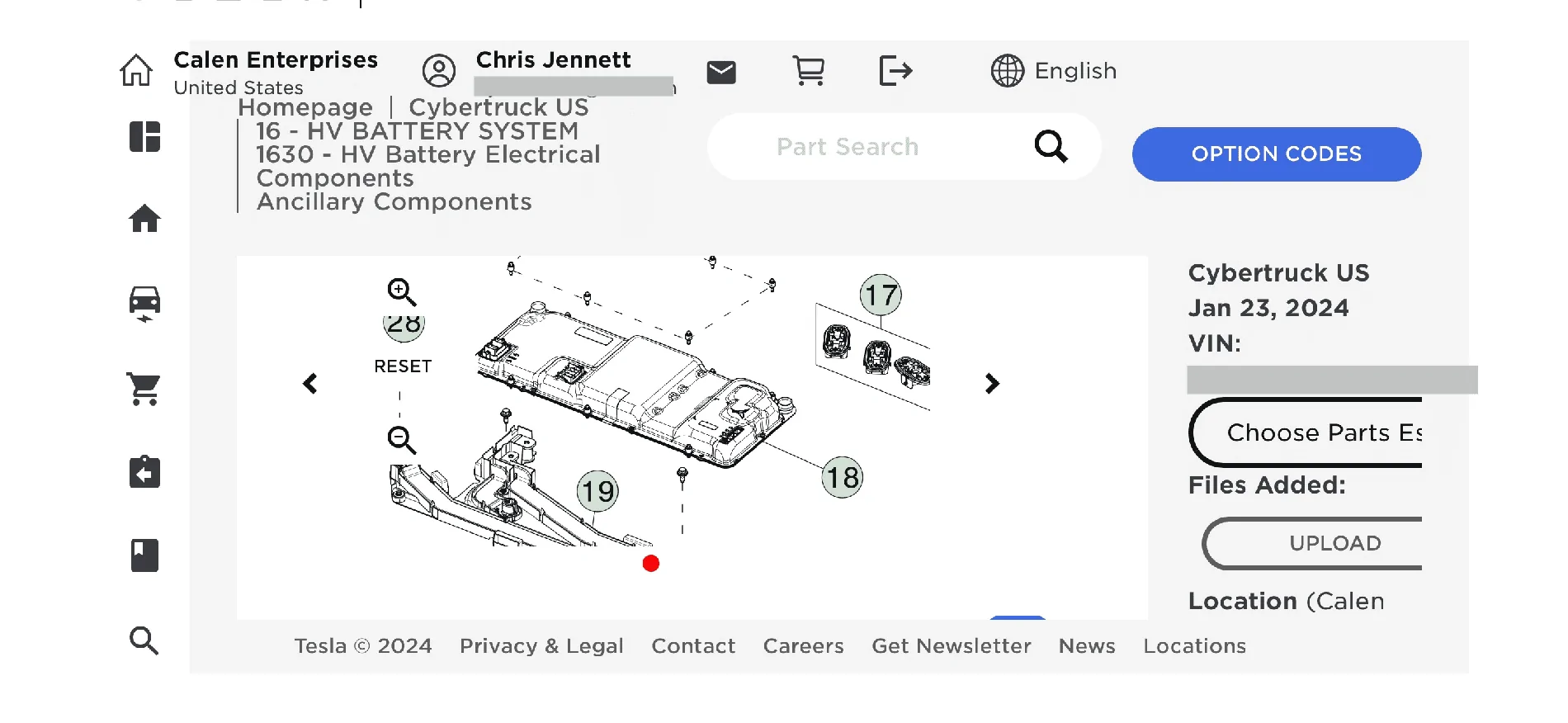

This sounds almost identical to what happened to me. My truck has been at service for a week now waiting for parts. They believe it’s the “PCS” or power conversion system.
#18 on the diagram.
PCS manages most of the loads on 48V and the SbW steering from memory. Would most definitely be capable of causing the error messages listed.
I suppose the good news is that it's probably not a SbW fault, but the bad news is that SbW doesn't work well without power?
I'd be keen to gather any feedback on the exact issue. I'm assuming that if it is indeed the PCS and not the low battery browning out systems, that it might be the electronic isolation breakers if they can be reset? The bidirectional h-bridge power conversion circuits should be overrated and shouldn't really have an issue with peak loads or lower voltages, plus they tap the main pack. The PCS is also the charger so would cover that error, provided its not the 48V battery throwing a code.

It's not really too complicated. They seem to have borrowed the setup from the Powerwall3 (same capacity and battery voltage).
The PCS has 3-4 of these AC to DC bidirectional converters modules, which means they can also do DC to AC.
If you are plugged in a AC circuit it will take 240/120V AC and convert into DC pack voltage to charge your main pack, thats AC to DC. Same for 48V rail and 48V battery charging, but one module can only output one voltage at a time.
The running in inverter mode DC to AC you can use two modules together for 240V split phase which also gives you 2x 110V circuits. That is your powerpoint outlets in AC that comes from the pack.
This is also likely why the outlets switch off when you are 240V AC charging the vehicle, because they can only work one direction at a time. When you DC charge at a Supercharger it should not need to turn off as it doesn’t need a PCS converter module to charge and can use the Supercharger instead.
It should also be possible to operate the outlets whilst AC charging, but that would need to actively monitor your bed outlet load to derate your charging, so it doesn't exceed the charge cable rate.
So if you can't charge and you can't use the 120/240V outlets then it's nost likely that one or more of those bidirectional converter modules is out of service.
Now whilst driving at least one of those modules (probably two) is providing 48V to the vehicle systems, and redundant power to the SbW, and one is maintaining/charging the 48V battery as well. When those conversion modules fail to provide 48V from power in the main pack, then it's just going to run from the 48V battery. At that point it will not be very happy, because that ridiculously small 48V pack will only last long enough to park it or load it on a transport. If that battery dips under voltage your steer by wire is gone, (you are going mostly straight ahead from then on). It looks like the brake booster also doesn't operate from the 48V battery (or maybe it has a low voltage cutout so u can steer till the end) and operates only from the converter modules in the PCS.
If this is the setup then it's poorly managed. The likelihood of having a second or third power converter failure, without a more serious main pack fault or impact accident, is pretty slim overall. Having it all in the same PCS package doesn't really help either if it's a high voltage problem.
For SbW this is the equivalent of a steering linkage failure, or your steering wheel coming off in your hands. It should "never" be happening.
