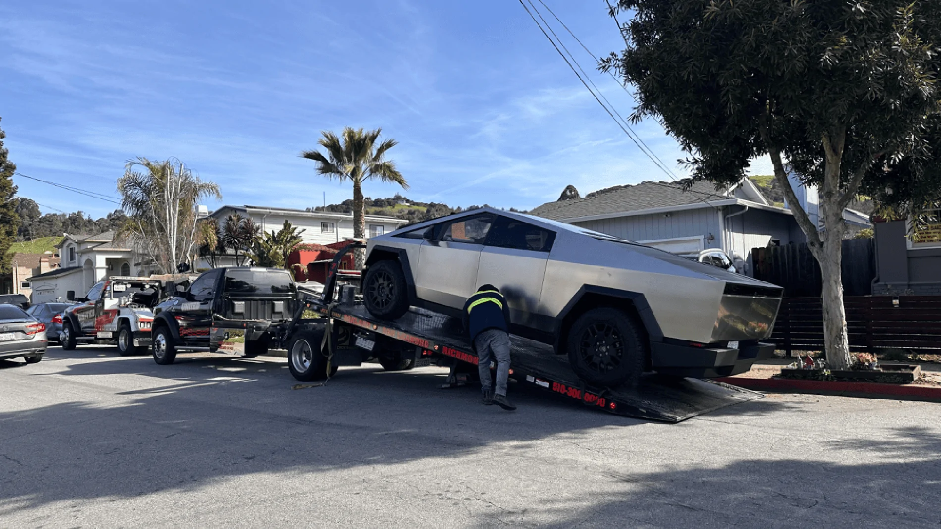

I haven’t seen or heard any updates from the original poster. Hopefully he has an update. My truck was towed/transported to Dublin, CA this morning.
I will keep everyone up to date as I get them.

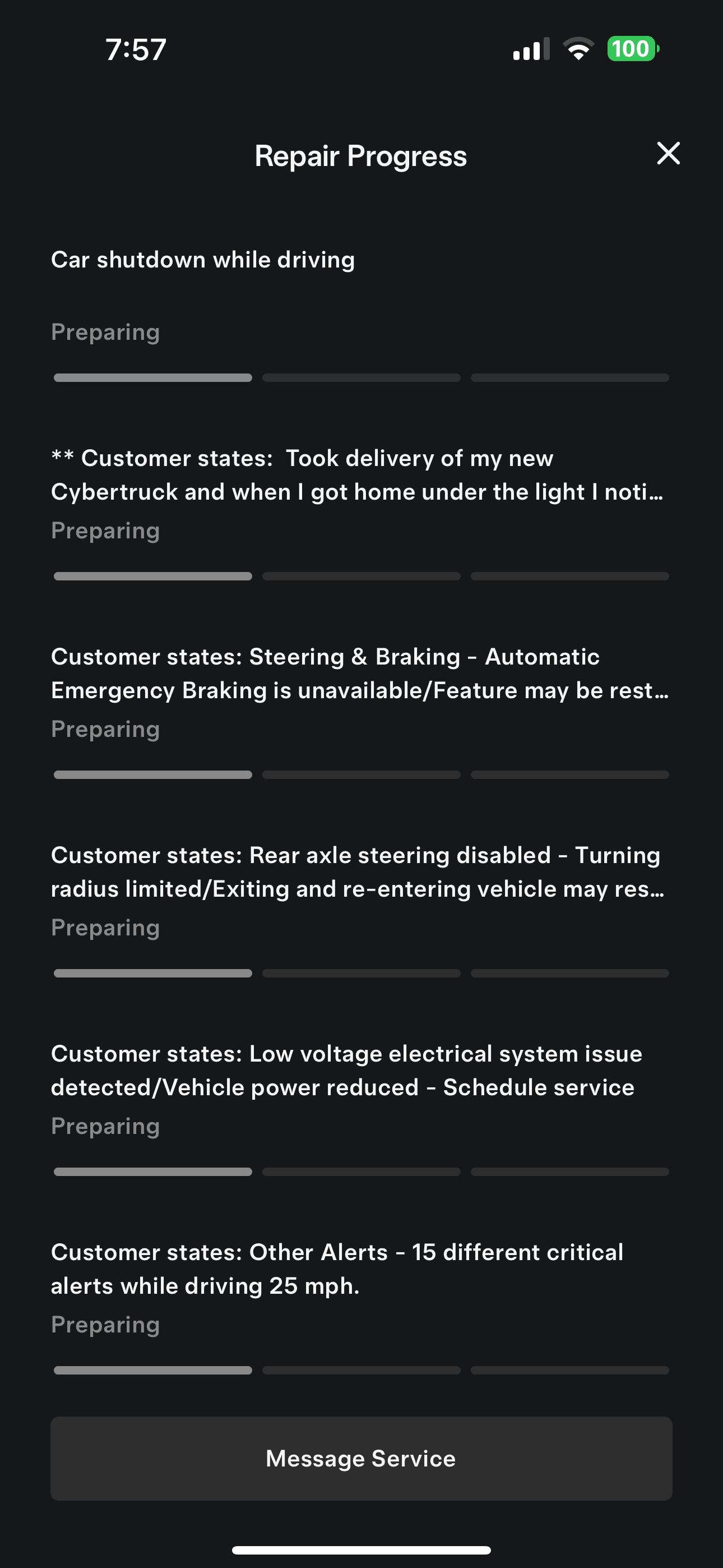

Update: Yesterday when looking at the repair process it had the estimated pick up for Saturday, March 2nd. This morning I logged into the app and it now says Thursday, February 29th.
What it does not say is what the actual diagnosis is and remedy. I sent my service advisor that question via the app. I will report back what I here.
One thing to note, the GPS location on the map within the app shows the truck is in the exact same location in their parking lot and not inside of a building. I am new to owning a Tesla, so I don’t know how accurate the GPS location is.

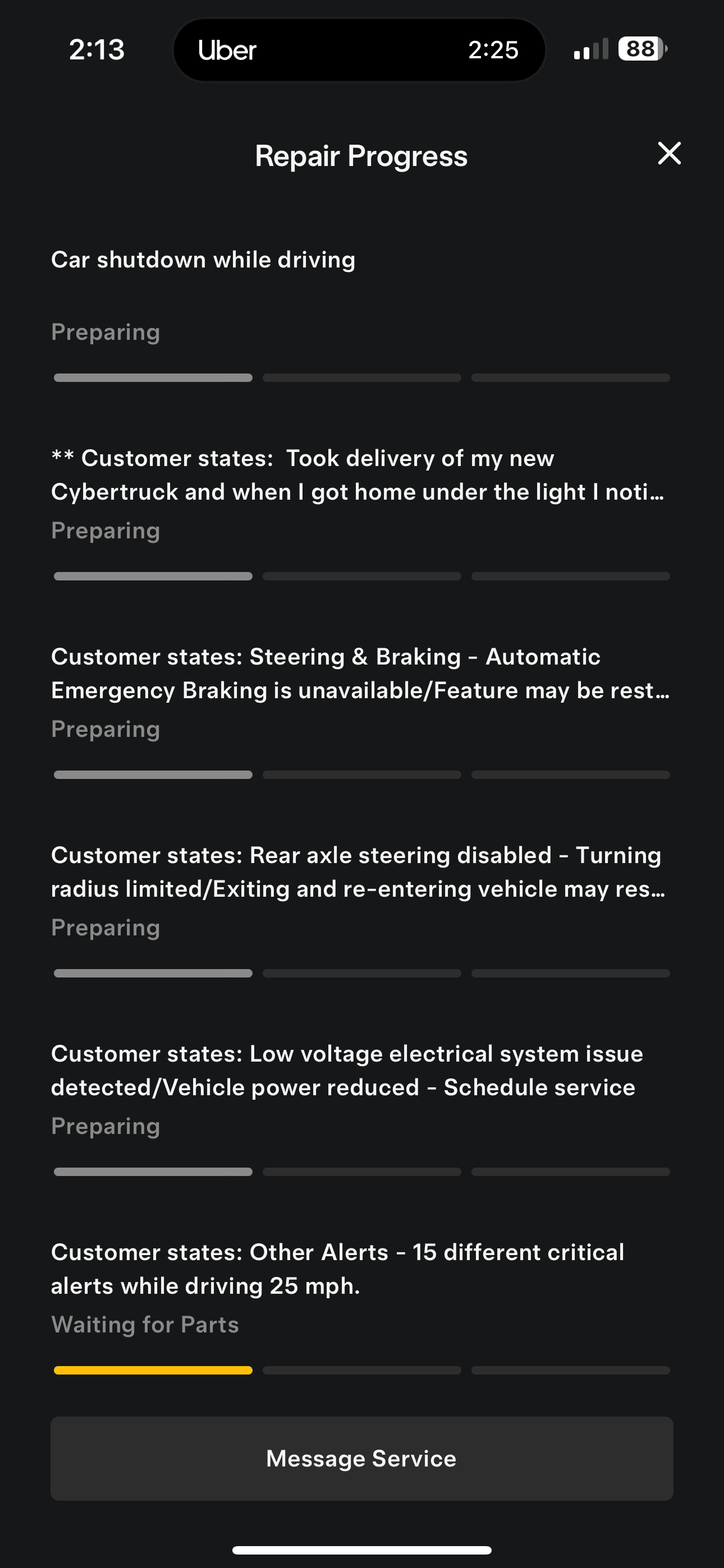

I just checked and it now shows the vehicle is inside the building and the front two doors are open. So I guess you still have the ability to see/track the vehicle.
And now it says waiting for parts, but still showing a pick up time for today. My guess is that if they are waiting on some sort of part, they will revise the pick up estimate to some other date.
I will try to find out what part(s) they are waiting on.

It appears they have identified the issue. This is a good thing. Latest update (Thursday, February 29th):
“Carlos, hope you are doing well. We are progressing through service and technician diagnostic, Bed and Backbone Harnesses - Harness - LV Backbone is faulty. The part is special order and plan to have the part by 03.08.24. Once we install the part we will need to perform an extended road test to ensure there is no other alerts.”
