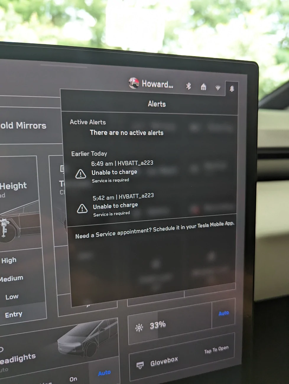

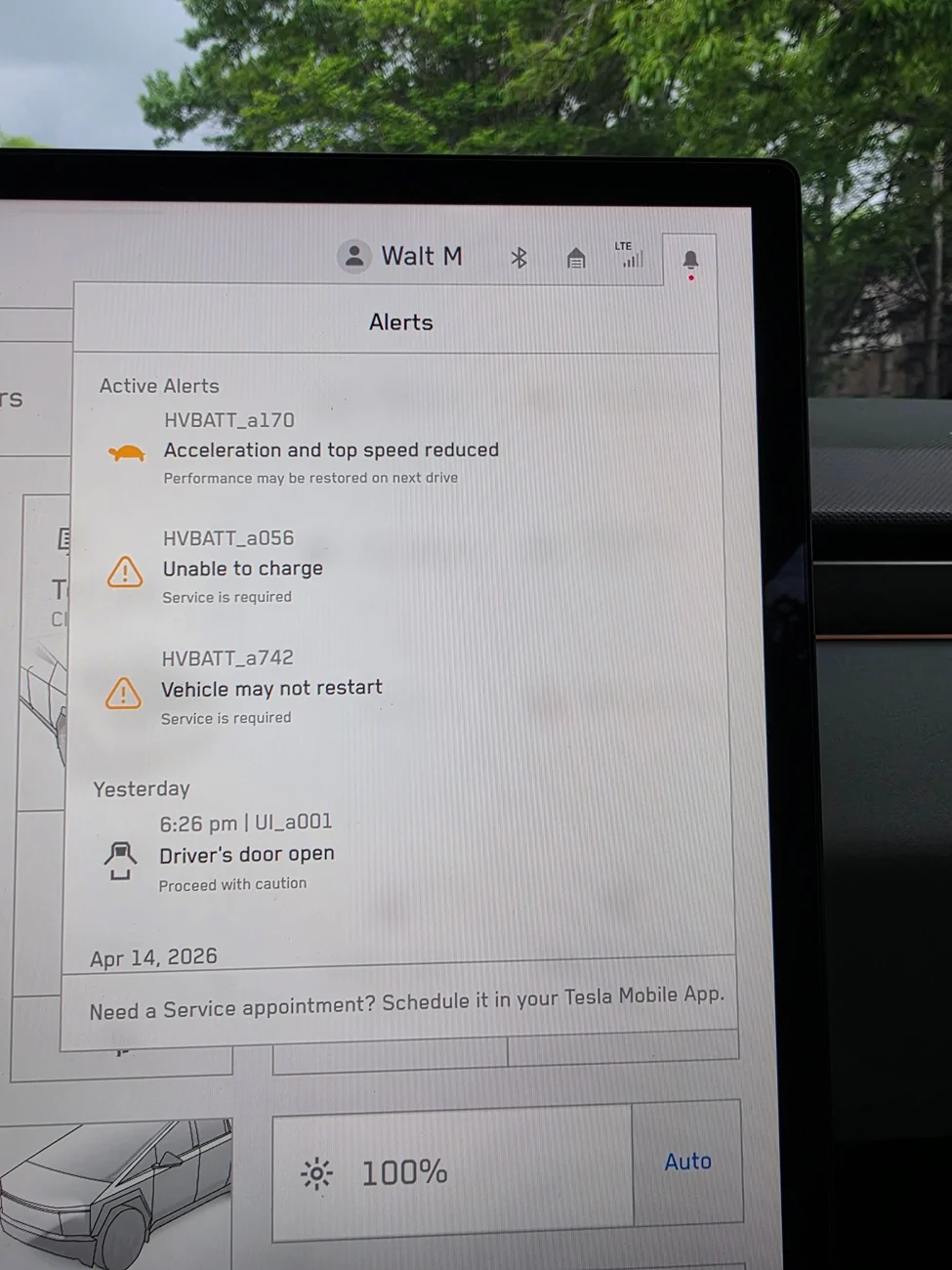

I have a 2025 CT with 7500 miles and got the following codes on April 16: HVBATT_a170 (Acceleration and top speed reduced), HVBATT_a056 (Unable to charge), and HVBATT_a742 (Vehicle may not restart). I took the truck immediately to the Chattanooga TN SC and was told that my CT has a PCS failure. It is interesting to me that the codes are all HVBATT codes (I believe the HV battery has an 8 year unlimited miles warranty) but I am told the PCS is not covered under this warranty. I was provided a model Y loaner and was promised a completed repair on May 7. Based on what i am reading, in seems like May 7 is optimistic. I love the CT but I am wondering if I should sell it when I get it back. This is my first post....
I had the same HVBatt error a couple of weeks before I had PCS error. They said it happened during a firmware update and it wasn't a problem, but obviously they were wrong or hiding something. They will replace the PCS in warranty. I am surprised you did not get a PCS2 error and they are replacing it. It will remain under the current warranty until 50k miles. I have the same issue, but nothing is close to this ride, so I am sticking with the CT and hoping version G of the PCS board is good.
Those aren't PCS codes though. More likely Device Ancillary Cluster.
Which isn't to say there isn't also a PCS issue.
Did you need to go into service mode to read those alerts?

No. See attached.
I have concerns that it is not the PCS at all based on these codes. I guess we will see when the repair happens and I get the CT back.

No. See attached.
If the PCS DCAC was only partly failed its alerts only show up on service mode (and AC charging would be limited to 24A).
So it can be the PCS has issues also, or the HVBATT codes are linked to the PCS. Either way, service will get it fixed up for you.

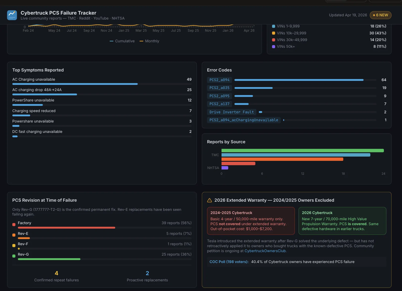

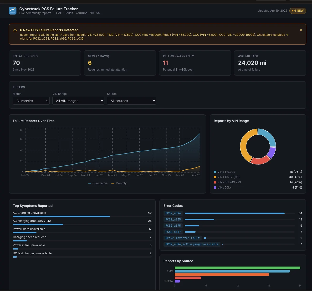

this is wild. at what point does it turn into a recall?
Good Article to read if you haven’t already. My PCS failed on my Beast and months later the wiring harness failed and went brick. The article says they should have both been replaced at the same time. My question is are they upgrading to what is installed in the 2026 or is this a quick makeshift fix.
ARTICLE:
Despite a growing number of confirmed cases, recognizable diagnostic codes, and reported service center backlogs, Tesla has yet to issue a formal NHTSA recall for the component. For many, the headache of having a looming threat in their vehicle, waiting to fail, means they may be hesitant to take road trips or plan travel without considering the possibility of being stranded on the side of the road.
The Symptoms
The Power Conversion System is a vital piece of the Cybertruck's power electronics. It acts as the gatekeeper for the vehicle's energy, integrating the On-Board Charger and the DC-DC converter into a single unit that manages all alternating-current power flowing into the battery while stepping down the high-voltage pack to power the truck's 48-volt low-voltage architecture.
There are several potential causes of PCS failure, which appear tied to failing MOSFETs or other internal components drifting out of spec under heavy electrical loads. Failures have been frequently reported at remarkably low mileage, often below 10,000 to 18,000 miles, and have occasionally happened repeatedly on the same vehicle after a full PCS replacement.
There are a few known symptoms that appear before full failure, which can help owners diagnose an issue before a full failure occurs:
  • Sudden “AC Charging Unavailable” warnings on the primary DisplayPort
  • AC charging speeds are throttled from 48A to 24A or lower before failing completely at home chargers
  • PowerShare V2L and PowerShare V2H output errors
  • Diagnostics codes in Service mode related to the PCS, including PCS2_a094, PCS2_a095, PCS2_a137, and those related to High Voltage DC overcurrent trip failures
In many cases, the truck can still be driven and accept DC fast charging at Superchargers. However, without the ability to AC charge at home, the vehicle's convenient daily use is effectively bricked until it undergoes major surgery.

Question: If you had a Rev-G fail, did you have a previous failure?
I'm wondering if some PSC failures are damaging other parts.
