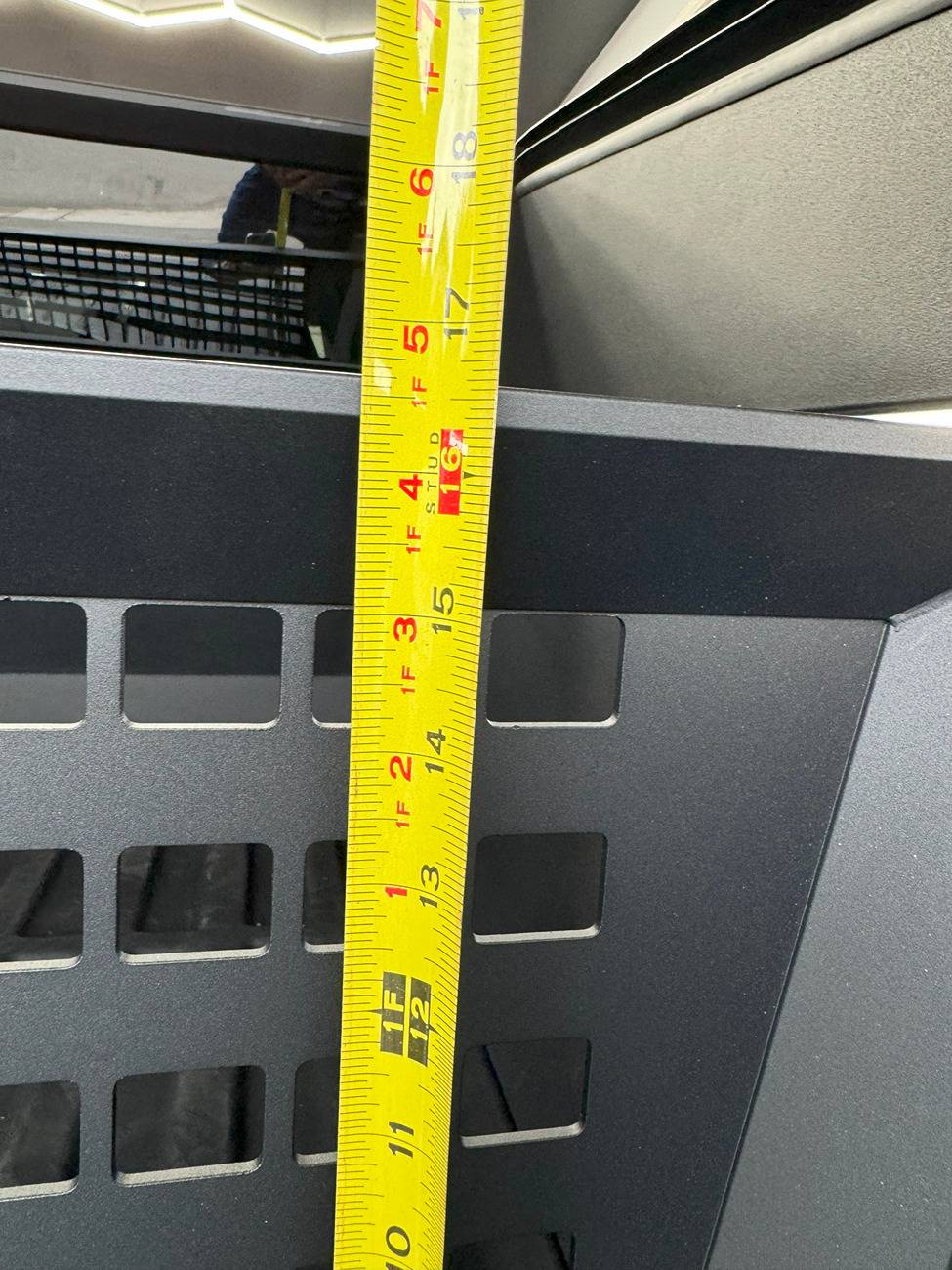

Wow, okay, so the new one's frame is actually 1/4" shorter. This one tapes out at 16 5/8" not including the legs. (Sorry I took the photos one handed so they aren't great but I measured more carefully)

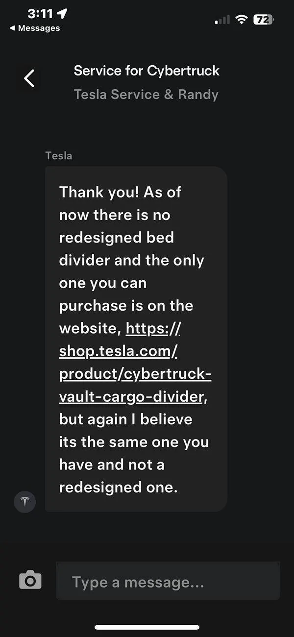

Wellll this is the response I got

Thanks for the update. Great info.
FYI, for those considering purchasing the divider now (and expecting this "updated" version), the Tesla shop now shows images of the divider feet that seem to be different than the new ones shown by the OP.
https://shop.tesla.com/product/cybertruck-vault-cargo-divider
The whole foot appears to be removable, but I don't see that any foot sections can be removed to adjust height (hard to tell from shop image). Don't know if shop image is of the "old/original" style, but it does not look like the "new" one posted.
Be good to get some clarification on what version is actually shipping now.
I believe the photo you are showing are the lock in sides not the feet
Thanks for pointing that out. Not only that, but the response you received from Tesla (there is no updated version) adds to the mystery. More questions to add to the list ?
