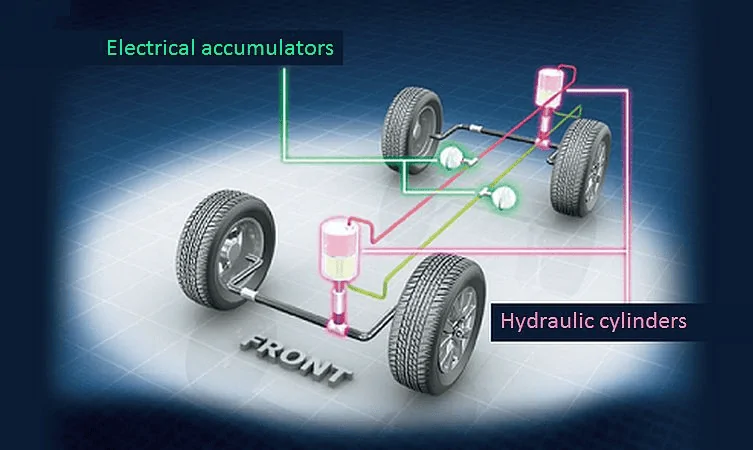

My 2001 Land Rover Discovery done one better: it had hydraulic ram activated sway bars that would allow it to roll against the corner, to reduce g-forces on passengers and it would roll upwards towards a slope offroad AND allow for absolutely unencumbered wheel articulation offroad as required, all in real-time over bumps.

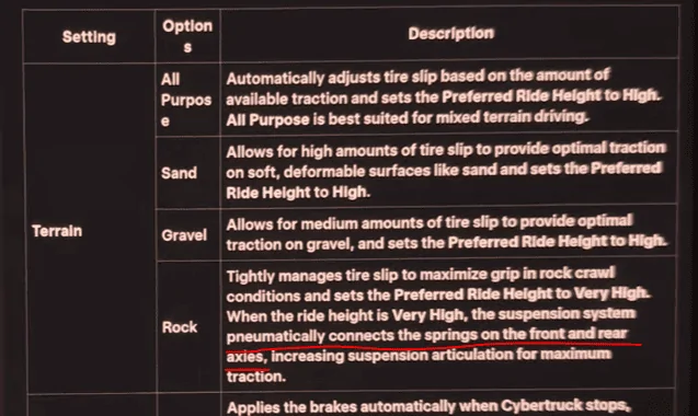

Further, it still appears that the Cybertruck is NOT cross linking the airbag suspension, which means that this is also stopping the wheels from articulating as well. The joke is the silly "offroad mode" is making it even worse, in that the airbags are being operated at higher pressure to keep the CT higher off the ground, and is also why the suspension can't compress enough to put the other wheels on the ground.
On rock crawl mode it is supposed to cross link the airbags
If I were to guess, I would say the off road modes are doing nothing right now other than change suspension height
A random person that supposedly talked to a Cybertruck engineer that is working on that section of Cybertruck said a update should come in a bit more than a month that will enable lockers, maybe more if my theory above is correct
If you guys go back a little, when Rivian launched while traction control worked, there were many issues and quirks that they steadily improved, it's not perfect and likely will never be due to the lack of lockers, but it's miles ahead from what it was

Ideally they'd install a Kinetic/KDSS type setup, as this is idiot proof and needs no driver interaction, and could be installed by simply replacing one of the linkages at the end of each front and rear sway bar, and running two hydraulic hoses between the actuators. Thats probably the best passive system, but active ones are also possible but would likely cost more.
Tesla Cybertruck Offroad Video By Normal Guy 1706408581749
Tesla Cybertruck Offroad Video By Normal Guy 1706408604019

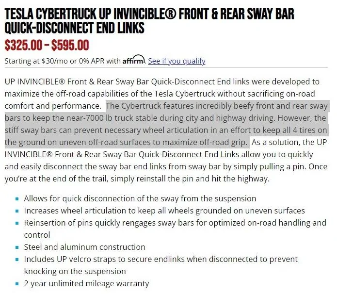

I hope that's true that it can be cross linked, and I'm grateful for the lockers being there in hardware, as it was mechanically obvious something had to be done there to give it some capability....
A bit uncertain on the language if it means connecting front right and left or one side front to rear, first option is more likely
Although I agree with your take, I think it's simply, how many people will take if off road to the point it requires a sway bar disconnect? The answer is probably a tiny tiny portion of buyers, a lot of it's features are geared to what the majority need, not solving every need a small group of people would want
For those that want it, they can buy already
https://unpluggedperformance.com/pr...ont-rear-sway-bar-quick-disconnect-end-links/
Tesla Cybertruck Offroad Video By Normal Guy 1706451175167
