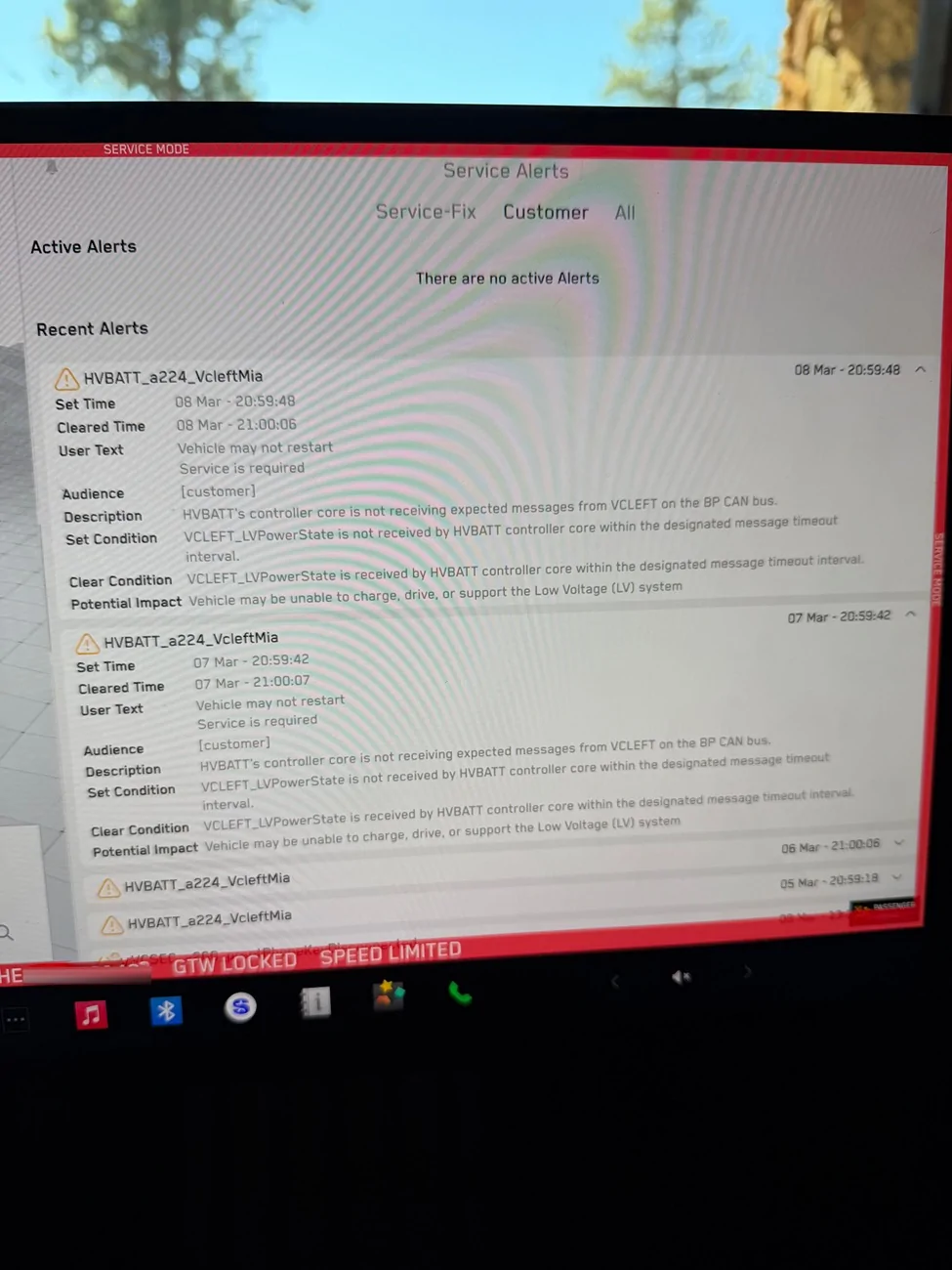

Have you checked Service Mode for older inactive alerts?
I hadn't because mine was AC charging fine at 40/40. When I saw it drop to 24/24 I checked and found an active alert for the PCS and a long list of inactive alerts related to the PCS.
If you have those, maybe that'll be enough to get your SC to do the swap?
Interesting... it's not charging now. I dont know if it's my paranoia... but I have a crap ton of these:
