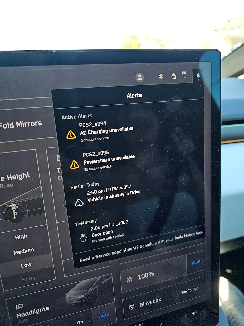

You basically described my situation. "AC Charging Failure" this past Sunday, two days ago. 25K on my 2024 AWD. Drove to the SuperCharger 13 miles away, yesterday (Monday), didn't work either. Earliest appointment available next Tuesday, 60+ miles away. CT is parked in low power mode hoping I have enough charge to make it. Glad it failed under warrantee, but very inconvenient since this is my work truck with all my tools on board.

Do the math: Consider the PSC failure description read "AC charge disabled, Supercharge IS possible".
...That was NOT true - I tried 2 Supercharger's and it did NOT charge. The error message did NOT correctly describe the failure.
So what else about that message is incorrect, or not being described.

***Just had the SAME Alerts today where it appears it stopped my home charging...looks like over a week to get an appointment on my 2024 FS AWD VIN 69XX 43K miles....hopefully we will get the LATEST REVISION of PCS (REV-G?) Im afraid to drive, so martyr to get it to the SC and convince them to give me a loaner...as I am too fearful to drive anywhere for a week...and need a vehicle. T should really make a GOOD WILL decision and warranty PCS same as motor/battery...since they know it has been an issue...(Tesla currently, has OVER $2 BILLION dollars set aside for warranty reserve)

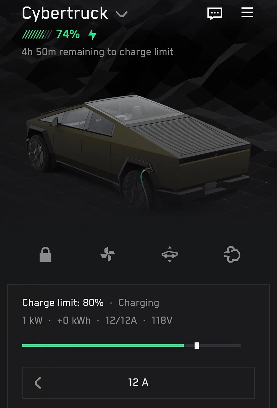

VIN 19XX. 9,900 miles. Took delivery in March 2024. Failed a few days ago. Can still charge at 24 amps for now. Submitted service appointment Friday evening, hasn't been scheduled yet.

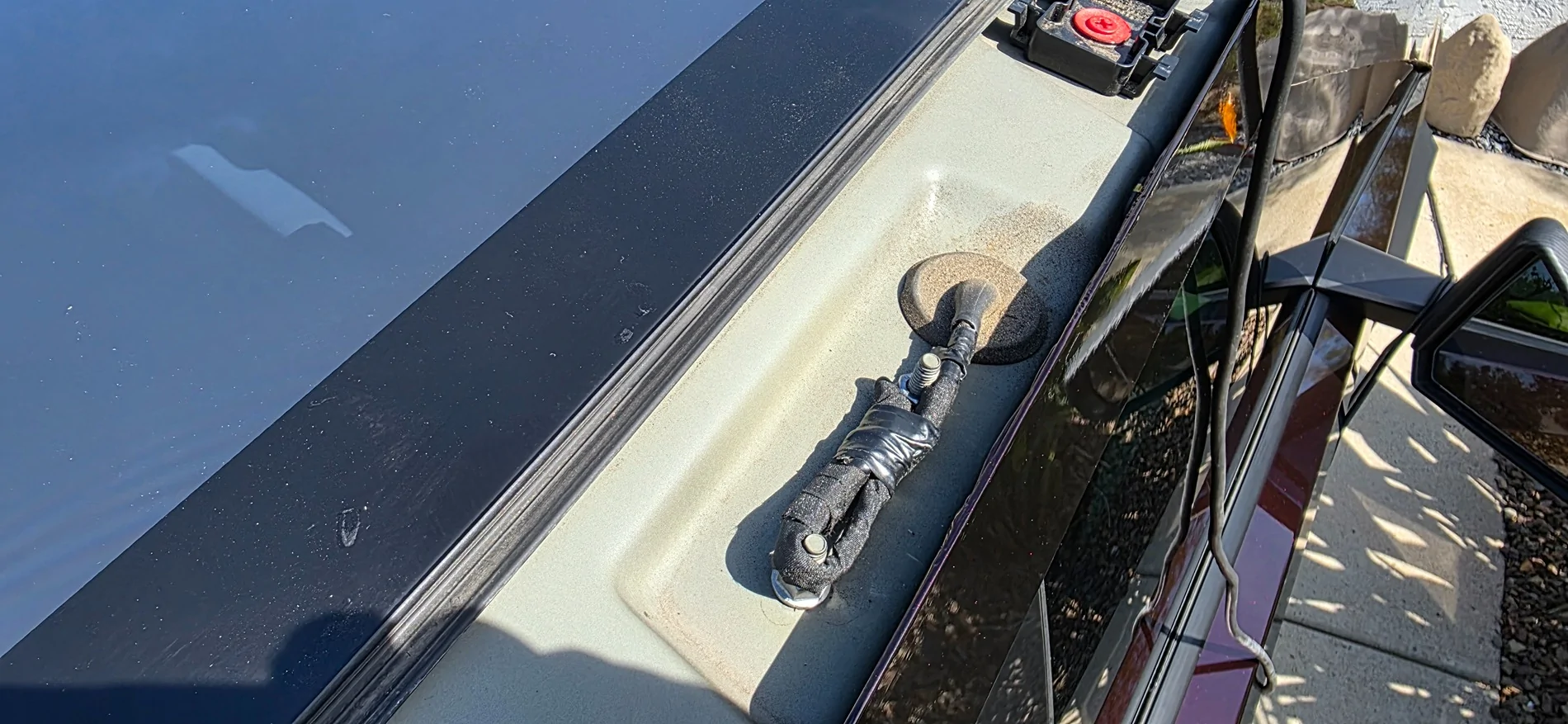

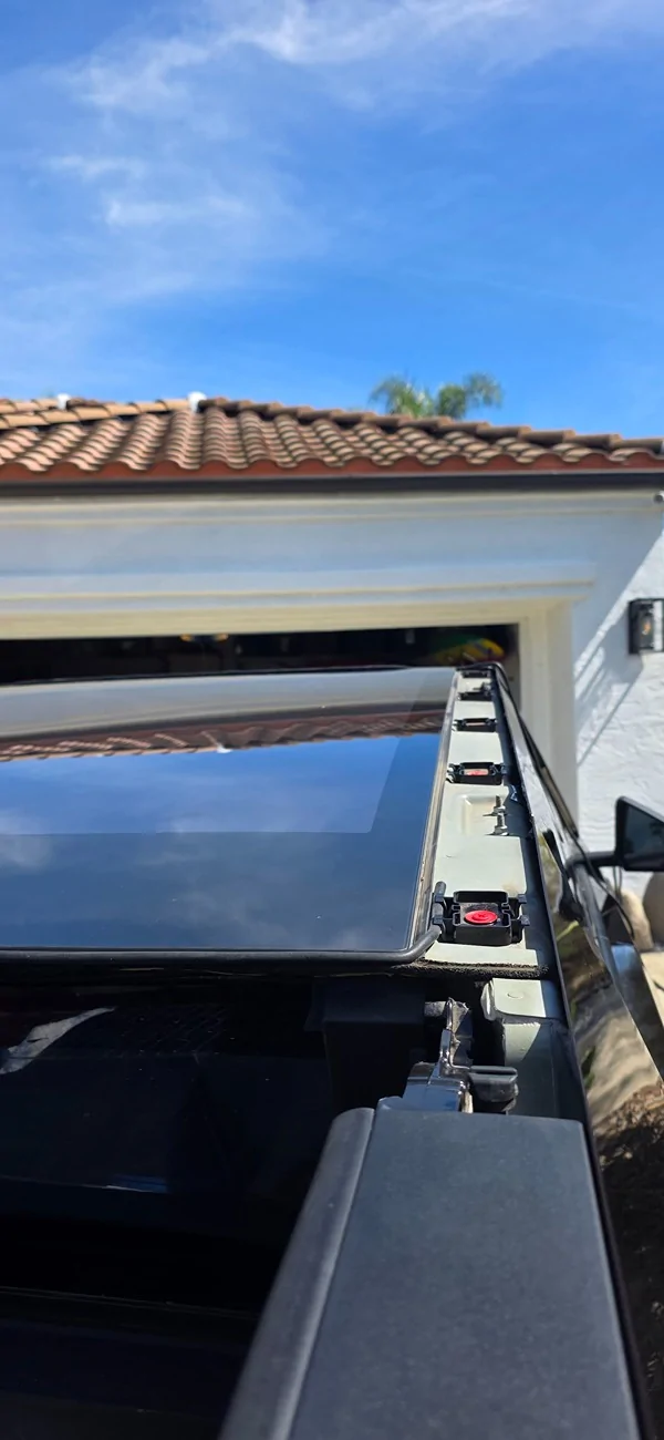

That's what my CB sounds like. Do you have the factory lightbar installed as well?
Sorry to derail the discussion. Tesla service had my truck for almost a week and could not find the source. I decided to remove the sail appliques that covers the roof rack mounts. I found the cable that goes to the light bar to be laying loose, and secured it around the bolt, as I don't need it yet. I am fairly certain that is what caused the flapping/slapping sound. In specter the mounts for the appliques, put down a 1/4" rubber molding around the ceiling panel (Amazon.) This made the appliques seem a little tighter fit when I put them back on. So far so good and no more strange sounds.
