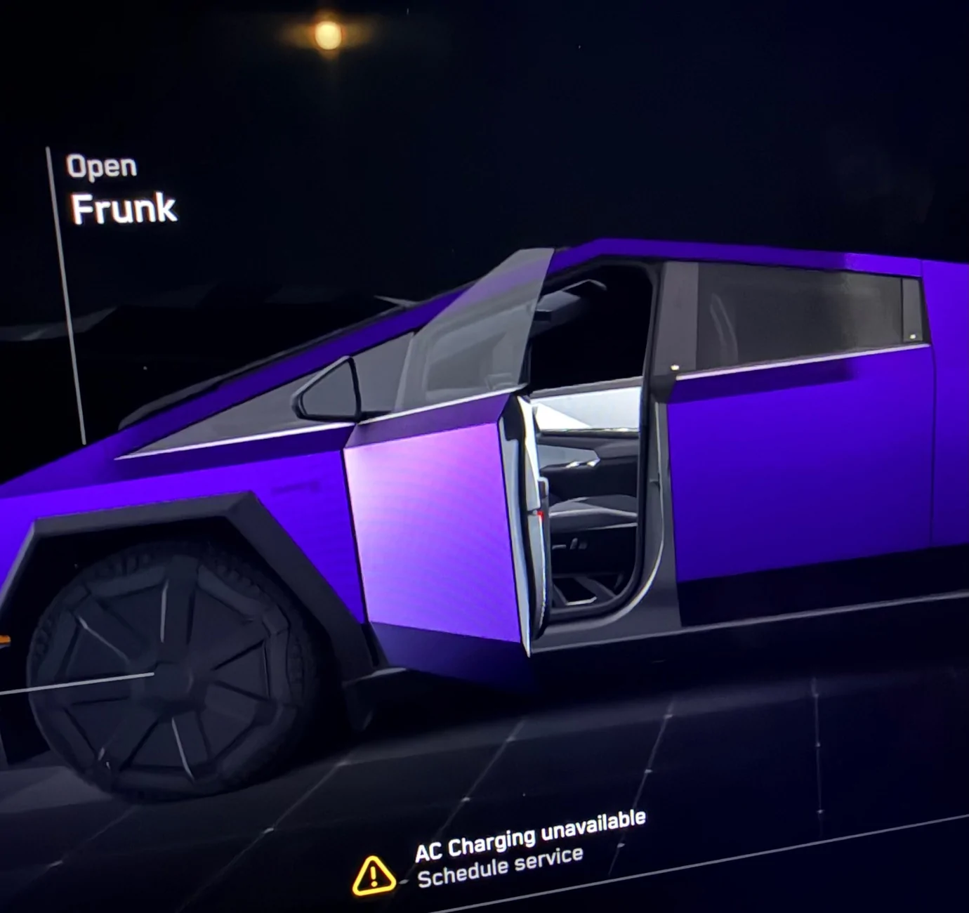

Im also likely experiencing pcs failure.
Vin 08xxx - 20k miles, picked up may 24
i had ‘limited power ‘ sign couple times in last 3 months when unplugging truck from mobile charger at home @ 32amps . My last post here in December was about it as well. Took truck to Service center amd supposedly they didnt find any errors in last appointments but had created fast pass appointment in case it happens again.
i saw thread here and texted SC couple days ago re possible issue in future and advisor made appointment to look into it beginning of april.
just got message in app that charging failed while it was plugged in and checked truck and showing ‘ac charging unavailable’ 🤬
