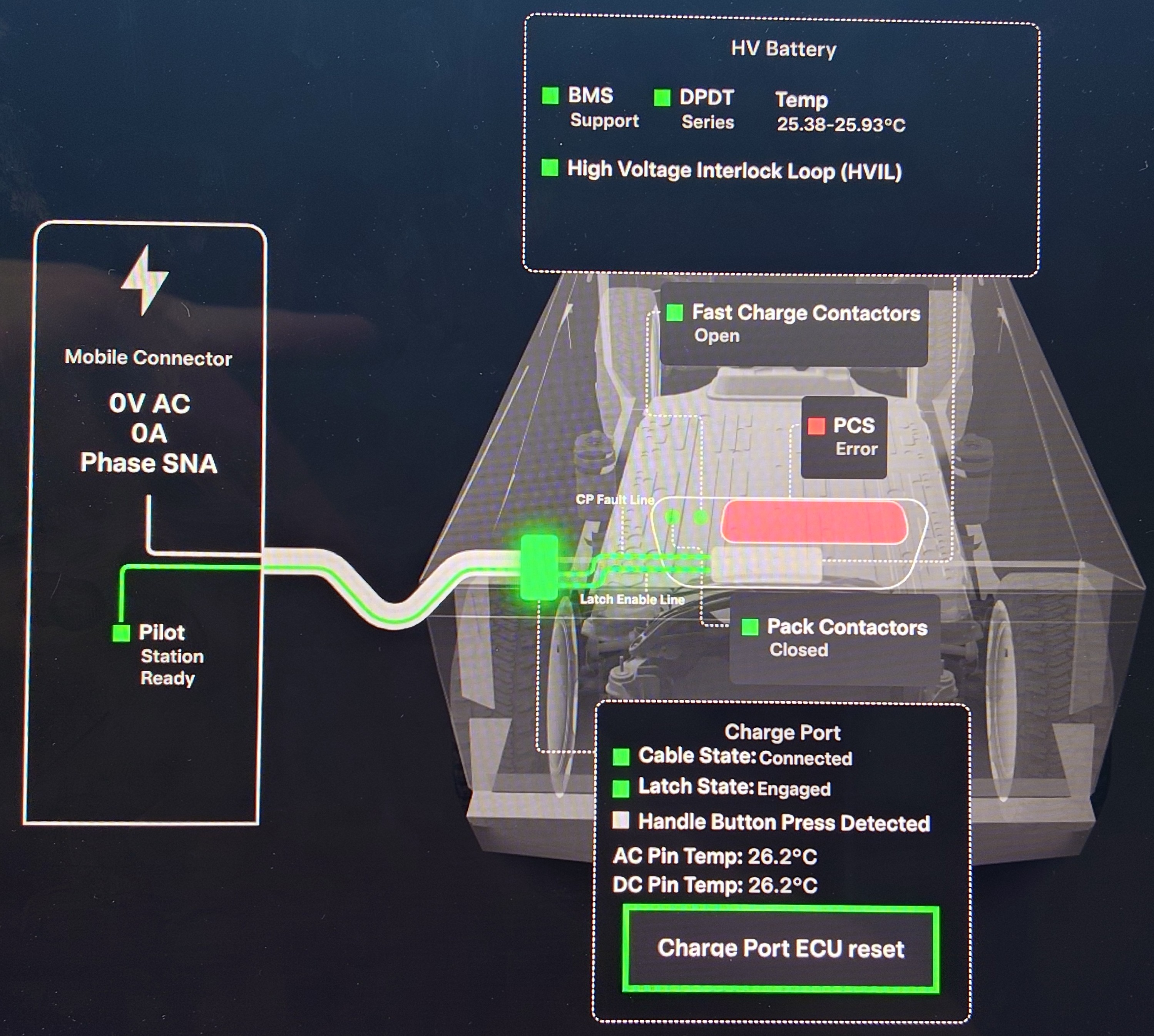

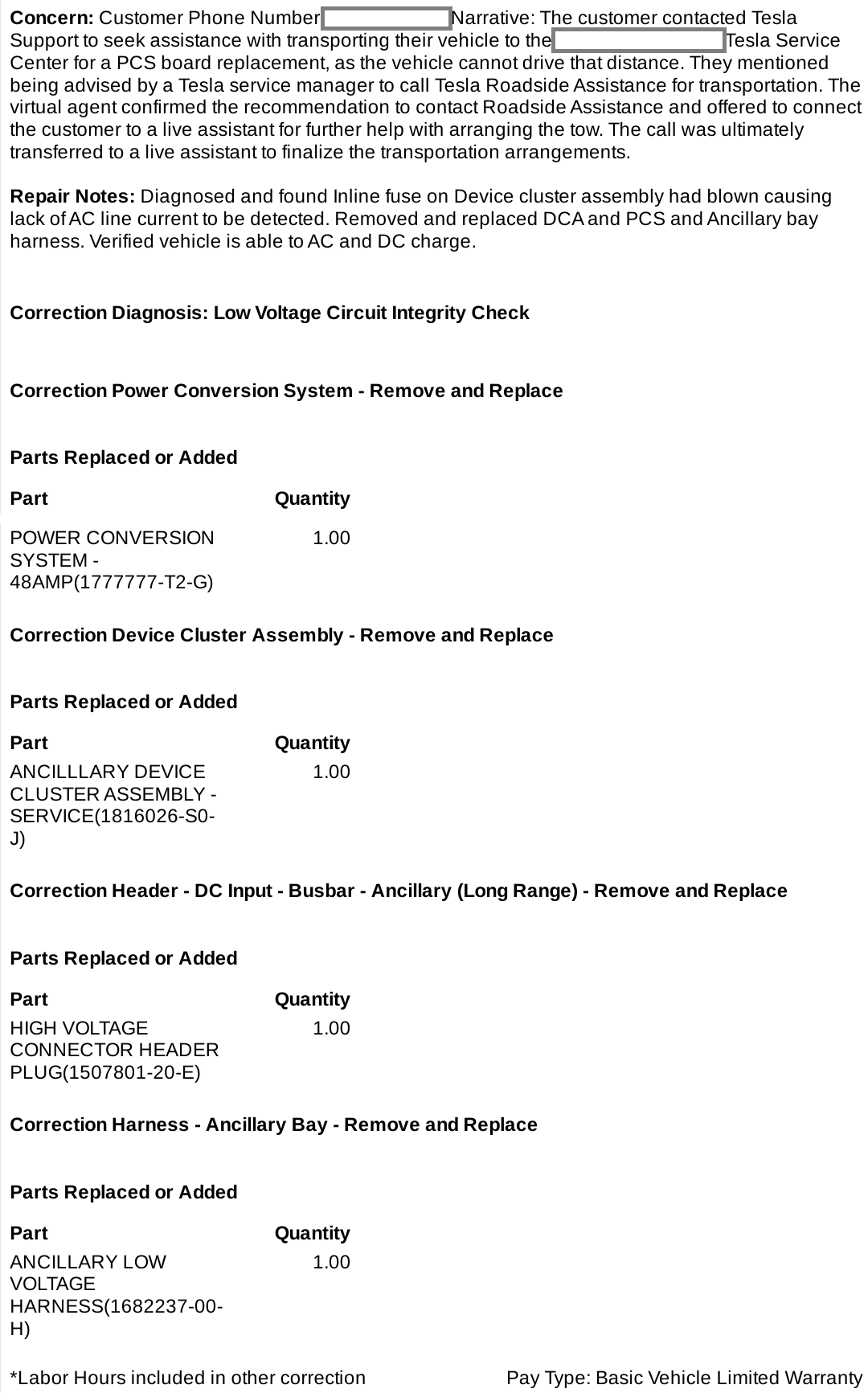

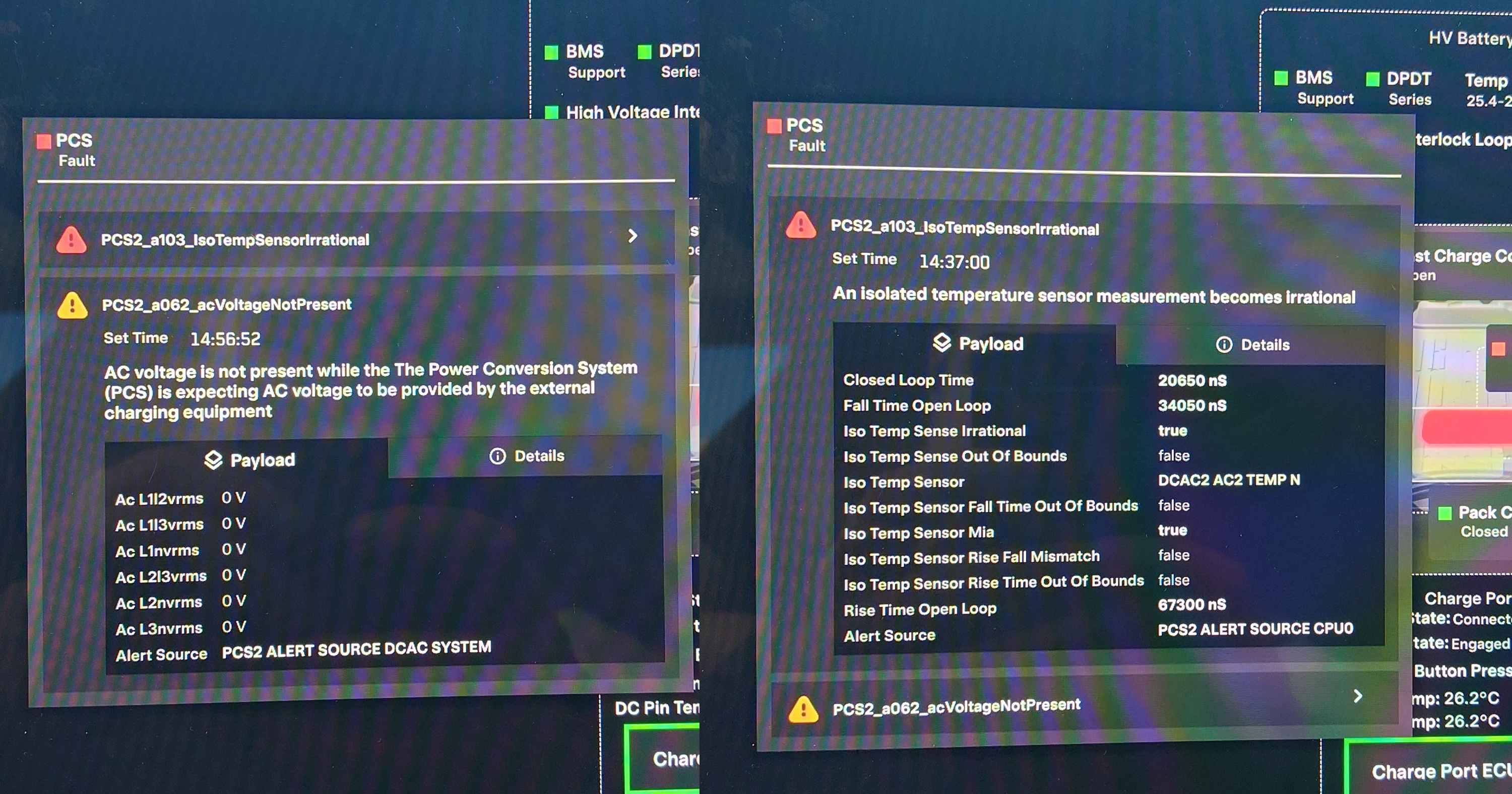

Can confirm my August 2024 Cyberbeast PCS controller failed on me March 10th. It was plugged in and charging (Tesla L2 standard charger) when it failed.
Tesla Cybertruck PCS failure rates by year...is it just a matter of time? PCS.error
Tesla Cybertruck PCS failure rates by year...is it just a matter of time? PCS.codes
Tesla Cybertruck PCS failure rates by year...is it just a matter of time? tesla.pcs.invoice

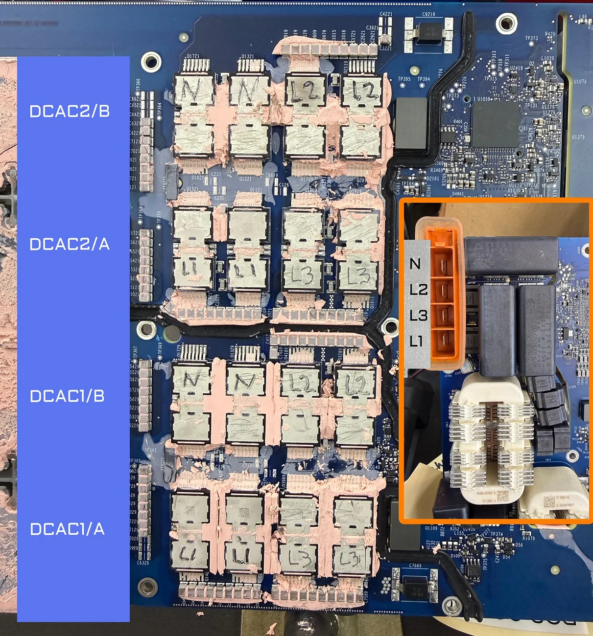

I think it is the AC power components on the bottom of the PCB. The power components may have been hanging on to the bottom side and their solder remelted as the top side chips were soldered in the reflow oven. This allowed them to become less level as they are just hanging on the melted solder. The fix is to have the power components on the last side of the PCB soldered. The other issue is they might not have enough copper in the PCB to draw heat away. A thicker copper layer is the solution. If somebody could get me the chip ID, or power and it's internal construction, I could rough guess the PCB thermal area needed. I thought they were too close, but advances in power FETs. Using a PCB inductor means they need a high switching frequency. That could add lots of thermal load if the gates are not properly driven.
Video in this post shows evidence the components are not level.
https://www.cybertruckownersclub.co...-it-just-a-matter-of-time.55072/post-30778754
(I might have designed and made more than a few high power PCBs in the past.)
The FETs dump heat to the liquid cooled cold plate. AC side looks like ST SCT040HU65G3AG HU3PAK parts.
https://www.st.com/resource/en/tech...g-and-thermal-behavior-stmicroelectronics.pdf
From the PDF file:
If components must be placed on both PCB sides, the side with HU3PAK must be processed last, as wetting forces could not hold the HU3PAK package during a second reflow.
As suspected.
The package looks to be designed to dump heat out via a heatsink/cold wall on top of it like Tesla uses, versus using the PCB copper traces. The copper traces only seam to be used for current flow and signals.
Section "3: Heat sink attachment to package" tells me using a thermal compound that can be totally squished out is electrically bad. Can this be the right package? Where is the needed electrical isolation coming from? The Munro video shows use of what looks like a caulk style gap filling thermal compound. They don't reliably provide electrical isolation. Also many of them are not as good conductors of heat as some of the thermal pad style. OK, looked at the Munro video again. There is a black surface on the electronics side of the cold plate. It might be the electrical insulator.
While it may seam like a very high heat conductivity compound that stays fluid or semi fluid could be used, they often contain electrically conductive particles. In an environment where vibration is common, they eventually end up everywhere. Been there, done that, suffered the consequences. Poor PCB became an arc path as it vaporized...

From the PDF file:
As suspected.
Not sure on what material they used between the package and cold plate.
