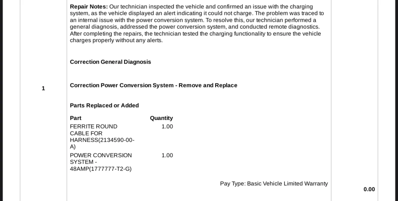

Service center fixed. Broke again after two charges.
Repair notes doesn’t even mention “replace” so idk man

69xxx vin
10k miles

69xxx vin
10k miles
Tesla Cybertruck PCS failure rates by year...is it just a matter of time? {filename}
Hmmm, I see "Correction Power Conversion System - Remove and Replace"
I also see "1777777-T2-G" listed in the "Parts Replaced" section
I guess you got a bad one? You'll survive
