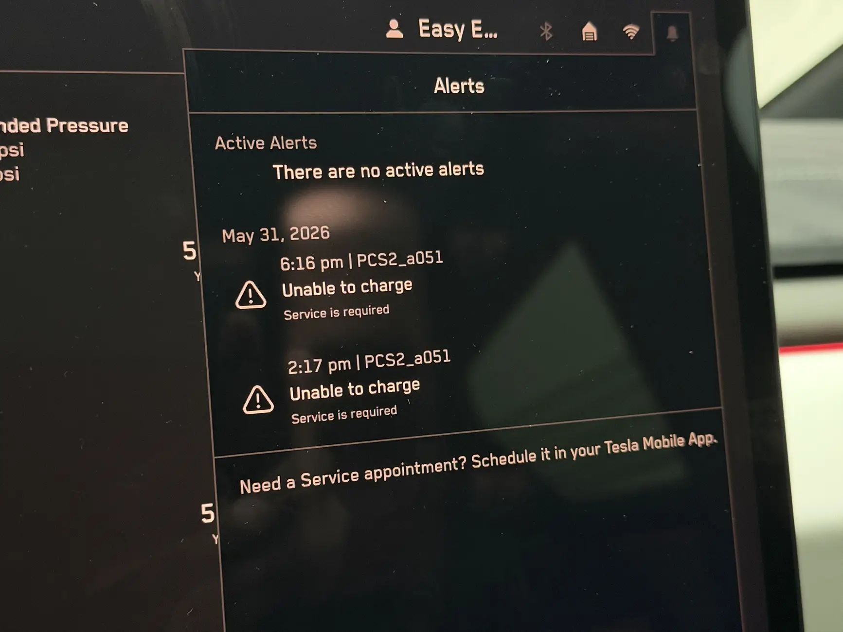

99% of my charging is at home at 30A
PCS issue started this weekend 5/30 w home charging limited to 24A
Service ticket filed. “Don’t call us we’ll call you. No ETA”

I’m planning to have Tesla proactively replace mine once they are in stock. I charge at home (AC) 99% of the time. Of that, I’d guesstimate 50-70% of my charging is around 24a or less because I use Charge in Solar. When I need to charge quickly, I do charge at 48a, but only to 50%, then Charge on Solar takes over.
Mine is a November 2024 build.
They won't do that. If you can still charge at 48 amps they will not replace it.
Well, that’s not quite accurate. As I mentioned before my failure was somewhat unusual because it only threw up an error a couple of times but with the exception of one day my truck actually charged at 48A continuously. They can no do remote diagnostics and confirm that there’s a PCS issue (and that’s what happened in my case).
It feels like my failure mode was unusual, but like ChatGPT would say: “the cleaner answer is” they won’t do it if there’s nothing wrong with your PCS prophylactically; however, there is now a way for them to diagnose your system remotely and you may have a replacement even if you still can charge at 48A.

I'm ecstatic that I can still charge at 24A (albeit slowly).
Does anyone know if that fails too at some point? Or will I be good until parts are available (i.e. in a few months)?

24 amps one of the first signs of failure, you might get a year, a month, a week, a day.
they’ll replace upon any reduction and service logs
Yup, my failure mirrors yours. I've thrown a few PCS errors and one day I had a weird 5-6A charging issue that went away with a power off. Still able to charge at 48A and use the outlets, for now. Hopefully it limps along until my August appt without me having to rely solely upon SC.
