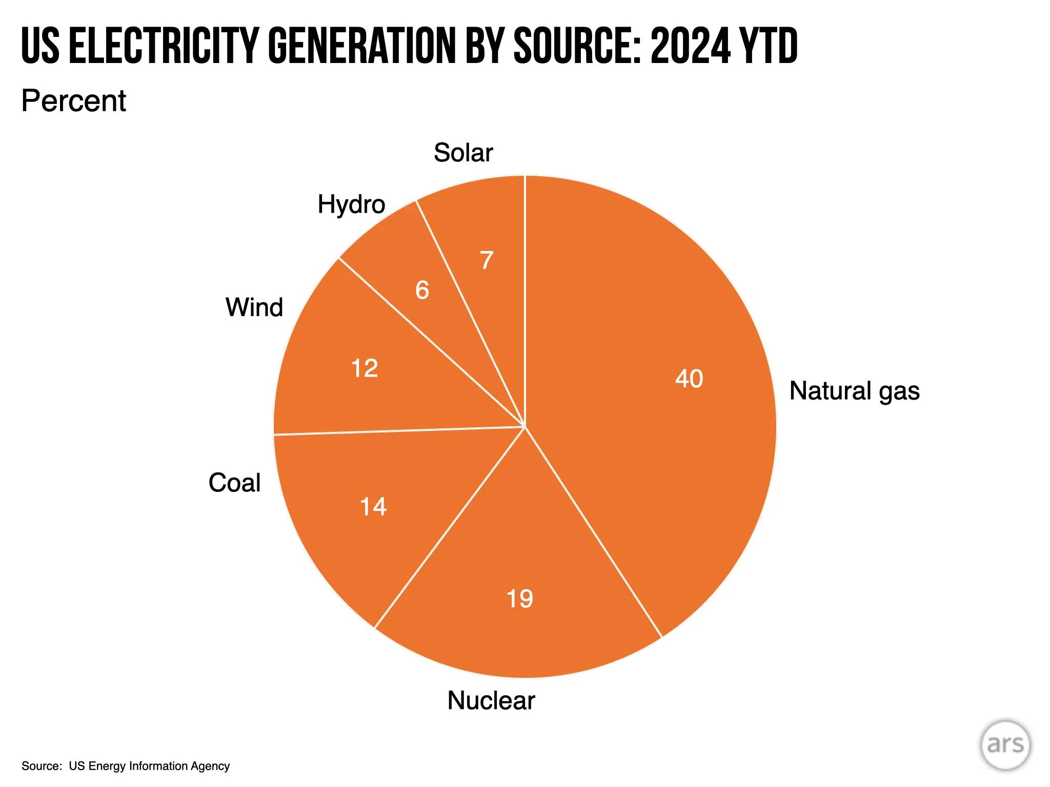

It's not any more foolish than owning an electric truck at a time in history when majority of electricity comes from fossil fuels. One has to work around the technology limitations. As the technology changes, fewer limitations will require such workarounds.
Come On, Nuclear!
