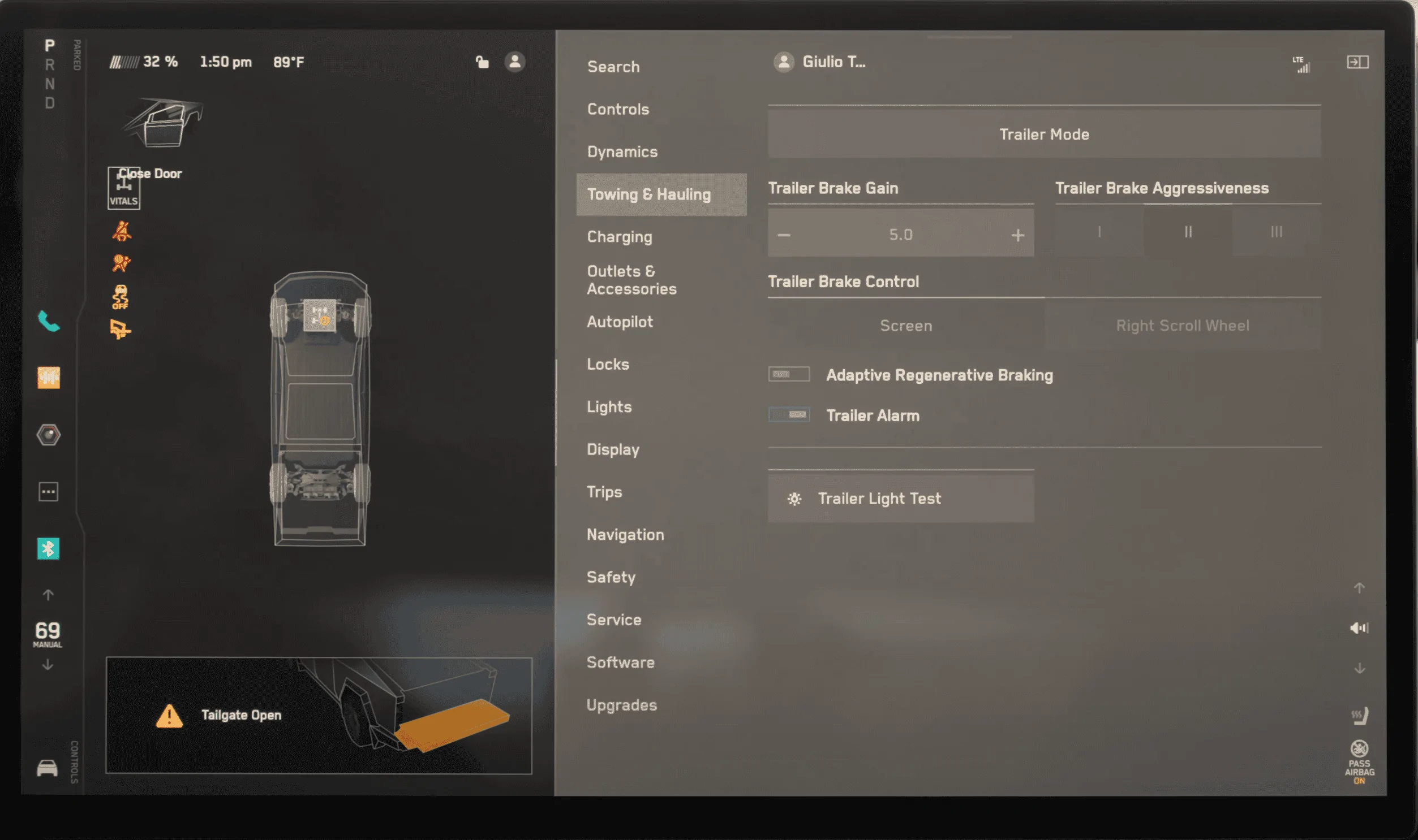

Does CyberTruck even have an electric brake controller?
I was toying with the idea of using a weight distribution hitch for an RV...just for added safety. Do you think Cybertruck will accommodate this? I hadn't thought about frame attachment points.
BTW, I did see somewhere in the UI an electric brake controller:)

Here's Towing & Hauling Screen Shot - so integrated Trailer Break Controller and light test and who knows what else - but sure it will evolve over time.
Would like add on trailer camera, some sort of hookup mode with rear camera, trailer profiles / scale (eg weight, etc)
I have a 8950 lb Hitch Pull Toy Hauler that I use a Weight Dist Hitch with....CT Beast won't pull at max weight (13k) but I'll be testing to 11k and 1100lb lounge weight!
