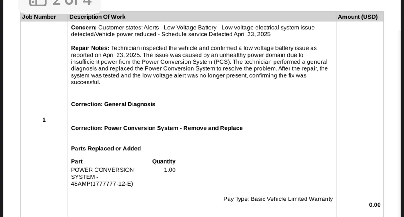

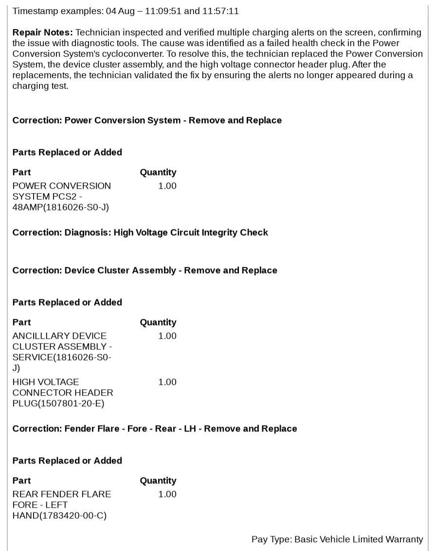

There is an internal service bulletin that’s why we all are approved for the free supercharging thing.
Mine was delivered with a E revision. it lasted 72k miles. It costed me about 800$ for the G to be installed out the door. I put about 800 miles on it so far and I have free supercharging till mid Aug. Overall im satisfied.
