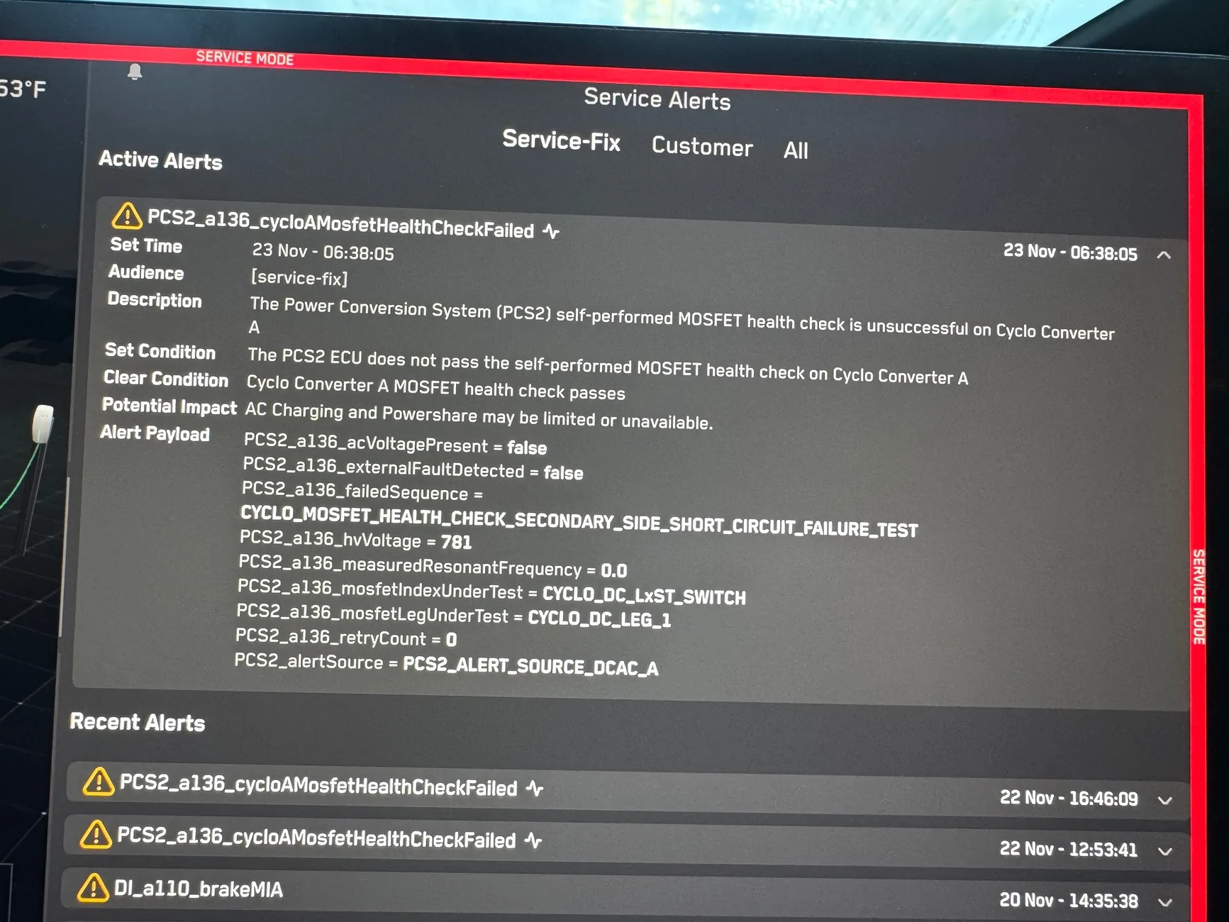

Now it’s my turn for this. I’m able to charge at only 24 amps. I can supercharge. Service mode shows this:
Tesla Cybertruck Power Conversion System Failure IMG_3488

So it was the PCS and it was replaced....a little over $3200. My failed PCS was the newest version so it was replaced with the exact same part number...so it looks like even the current ones are failing.

I plugged in the wall connector and it went to 24A/24A (normally I’m at 40A/40A). Failure confirmed in Service Mode. Replacement scheduled for 03/06.
I feel somewhat lucky because I can still supercharge.
