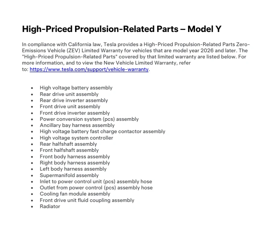

The differentiation isn't HV vs MV. The recent California induced updates to the warranty make it even more clear that the drive unit and battery only cover the drive unit and battery. Not the full pack nor HV system.
2026 SXY have ZEV updates, Cybertruck does not (2026 RWD might qualify, but those don't exist)
https://www.tesla.com/support/vehicle-warranty

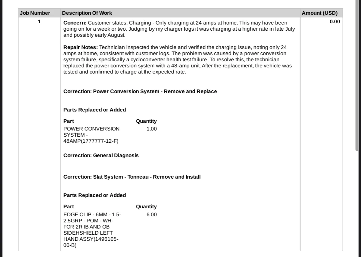

Just to add another data point: we had our PCS system replaced since it wasn't pulling the full amperage on our standard Tesla Charger at home. It's on a 60amp breaker, and our X would draw 48amps but the truck would only pull ~12-20 from what I recall. Once in service they weren't able to find any error codes or diagnostics, but then reached out to a senior service person who recommended replacing the PCS on it.
If you have access to a level-2 or similar charger it might be worth plugging it in and seeing what kind of power the truck can handle as it might be an early warning signal.

AC Charging Unavailable Schedule Service Alert
Both home Telsa Wall charger and Supercharger wouldn't work.
I drove it into my SC before it had to be towed.
Correction: Power Conversion System - Remove and Replace
POWER CONVERSION SYSTEM 48AMP(1816026-SO-J)
POWER CONVERSION SYSTEM 48AMP(1777777-T2-G)
HIGH VOLTAGE CONNECTOR HEADER PLUG(1507801-20-E)
Pay Type: Basic Vehicle Limited Warranty
My Failure occurred at 27,000 miles
SC said this isn't a common failure they have seen.
