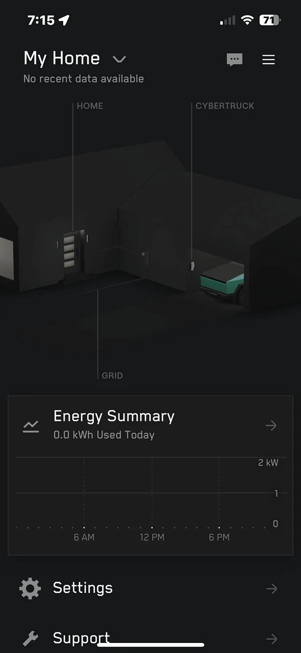

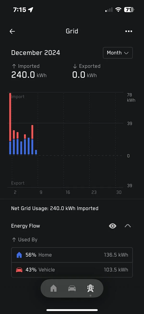

I’ve had powershare installed since the early summer. I haven’t checked the app in a little bit, but I did earlier today and I noticed that no power usage data has been pulled in my Tesla app since December 9, it’s just blank.
I have no idea if my gateway is off-line or what’s going on. I did some basic Google searching and have come up with nothing. I tried emailing an old Tesla email address that I once used when I was troubleshooting a problem with my wall charger and it came back as undeliverable.
Does anybody have any ideas?

Thanks, I tried the orange button and nothing happened, so I flipped the breaker on my electrical panel that connects to the gateway. That fixed it. I did wind up finding a different thread discussing the same issue and that's what OP wound up doing. Hopefully it's good to go now.
