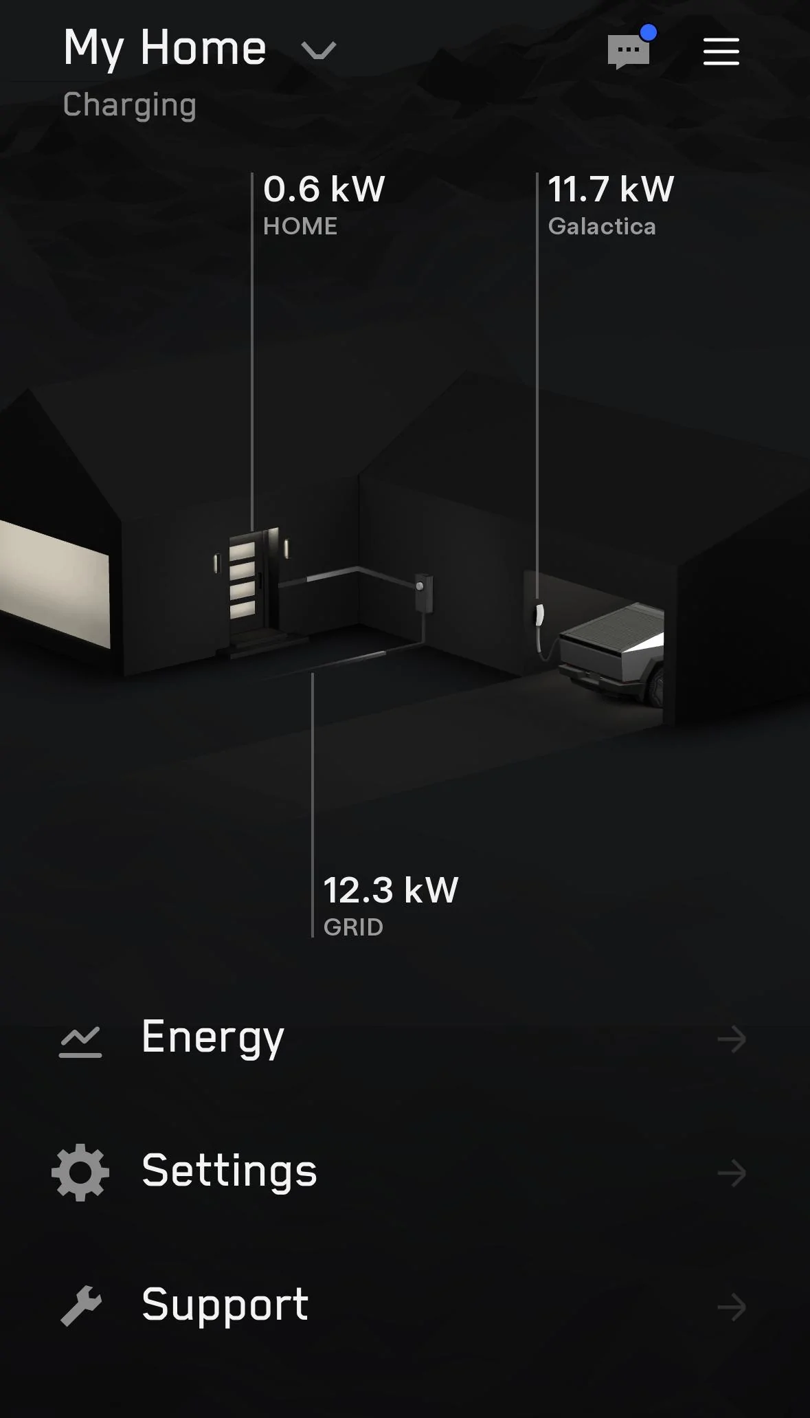

Looks like this in the app…
When you click on energy view, do you see the breakout for how much power of going to the truck versus the home? I'm my app, it's all being allocated to the home, Even when the truck is charging.
I am seeing the same. I opened a ticket with Tesla and was told this is the expected behavior until the update in June.

Thanks! That's what I was suspecting, and glad to get some confirmation.
