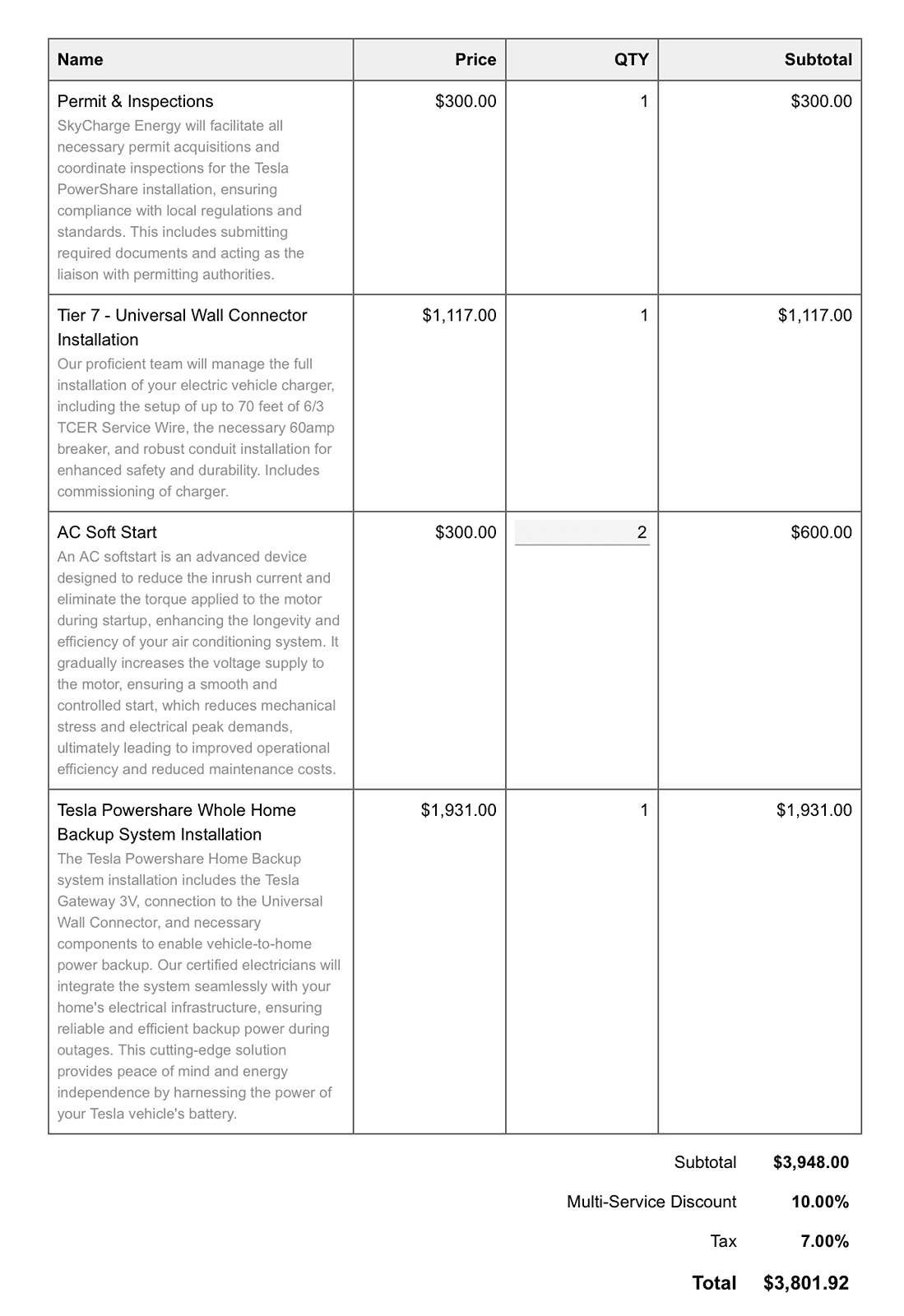

My quote for installing PowerShare 3v and wall charger is extremely high. Mounting both within 5 feet of the subpanel I want to backup was initially almost 7 thousand dollars. That subpanel currently has only 2 circuits , one a/c system and one 15 amp light circuit. I was able to work with the approved installer and did get the quote down to just under 4k. Very dissatisfied.
Anyone else feeling ripped off after analyzing value of FSD, PowerShare, and other small items prior to dropping the 20k for Founders edition? What will Tesla provide to compensate if I choose not pay this unreasonable price for install?
