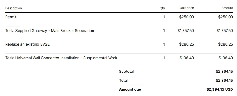

Outside of Charlotte, NC. Install took 2 people most of the workday.
When you purchased your cybertruck, you also selected the Tesla Powershare Home Backup Bundle $2500, providing the Gateway and Universal Wall Connector hardware
The above is the labor costs in your area for the install labor
making sure Im following the story
Yes, I used my $2,500 voucher for the Powershare Gateway Bundle, which included the Universal Wall Connector. The -$2,400 for installation was mostly labor, but included about $500 in materials separate from the gateway and wall connector. Primarily breakers for the gateway and 3/0 wiring at - $10/ft.
$5K all in parts and labor
How many amps and at what voltage can the Cybertruck supply via the PowerShare? 208/40 or 48? How do you select circuits to power and not pop breakers over running the available supply?
At 40-48 amps, the 123kwh CT battery could last two weeks.
240V @ 48A or just over 11.5kW. Since it is backing up a full 200A panel, it would be possible to exceed the capabilities of the CT at which point it would simply shutdown Powershare until I removed load and re-enabled it. In practice though, I rarely pull more than 3.5kW on that panel, since the big loads (stove, ovens, HVAC, other EV chargers, etc) are on a separate 200A panel.
