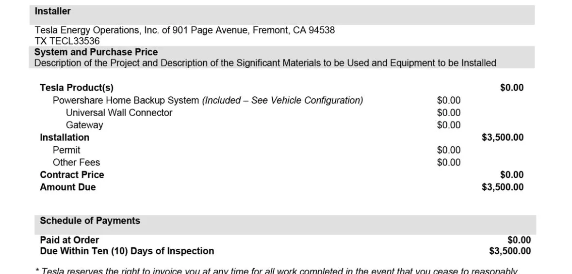

I got my quote this week. Is there any reason to believe there are some hidden costs not shown? My cost is a round $3500 and the electrical run at my house is probably 125’ as my panel is in the opposite side of the house garage.
Where are you located? I got the exact same quote from Tesla. The only run I have is for the wall charger to go across my garage - 25ft. Did you ask the detailed plans? I did and received them separately. Of course I don’t understand them.

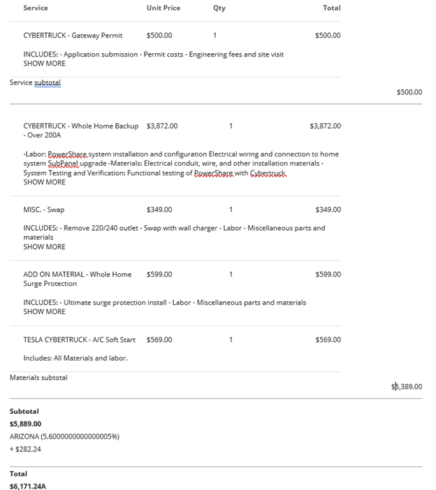

Anybody know how long we can sit and do nothing after receiving a quote before Tesla forces a credit on us instead of the PowerShare equipment? My quote, see below, was higher than anything else I’ve seen on this forum at almost $6,200. This seems nuts to me.
Tesla Cybertruck PowerShare install price / value quote
