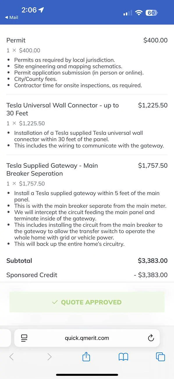

I got my contractor down to $3400. First proposal was $5k. I’m in NM. Waiting on permit, but definitively pulling the trigger since the equipment arrived.

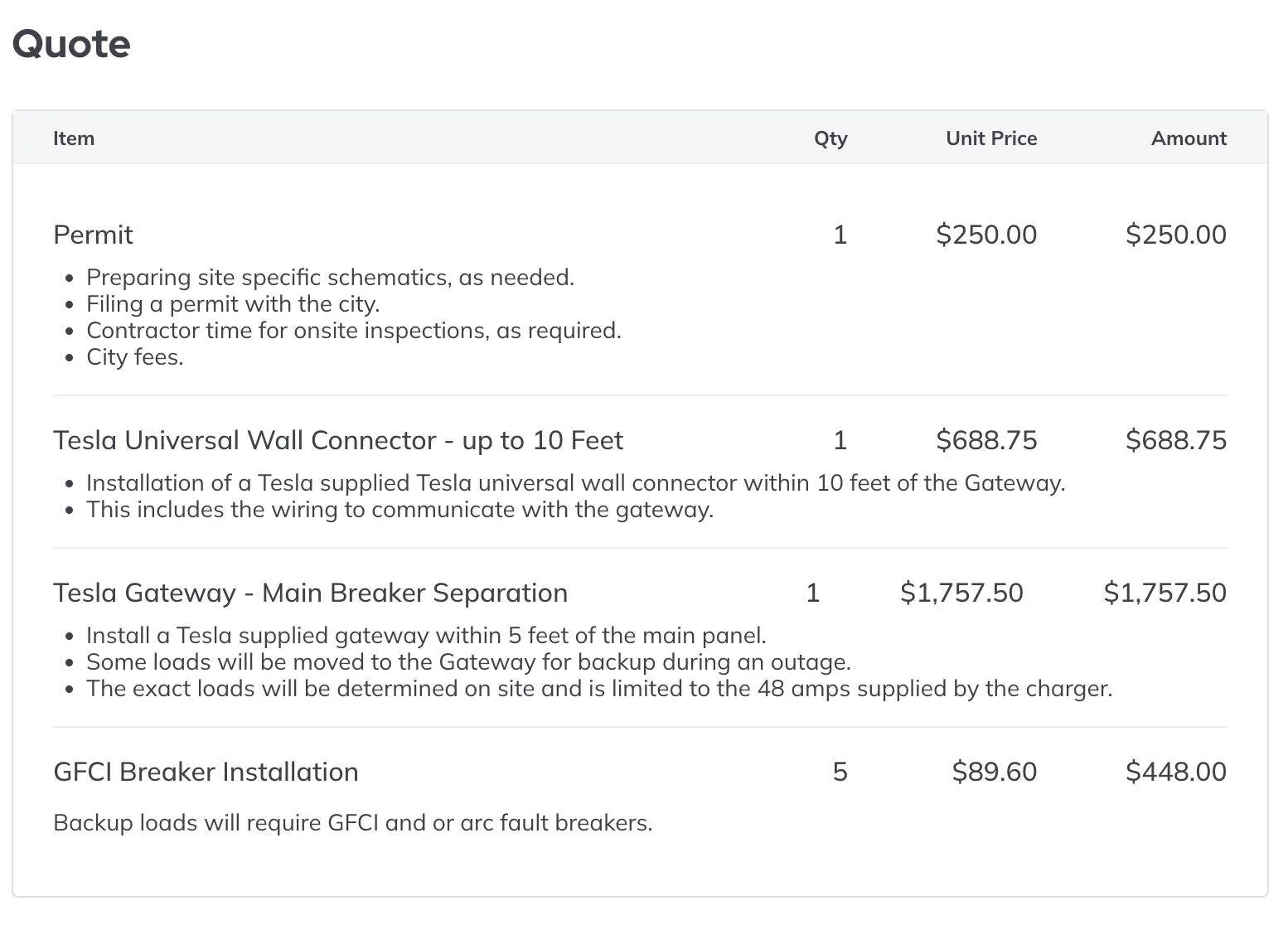

QMerit quote in North Texas below.
I live in a 4 year old developer home.
I denied four bids from "qmerit" affiliated electrical contractors before I accepted the 5th bid below for $3,400 and change. Two of the five contractors called me to attempt to explain why the cost was so high. Bottom line, the base price is fixed so qmerit can "get theirs," and also potentially break off Tesla as well. I'm going under the assumption that QMerit doesn't get Tesla exclusivity for free. They seem to act like a 3rd party referral company so the install is one less thing Tesla has to deal with.
The first four bids came in as high as 5k+ all the way down to 3.6k.
This is the most reasonable one I've seen.
Electrician claims full day's work to install. Will post pics of the work when done.

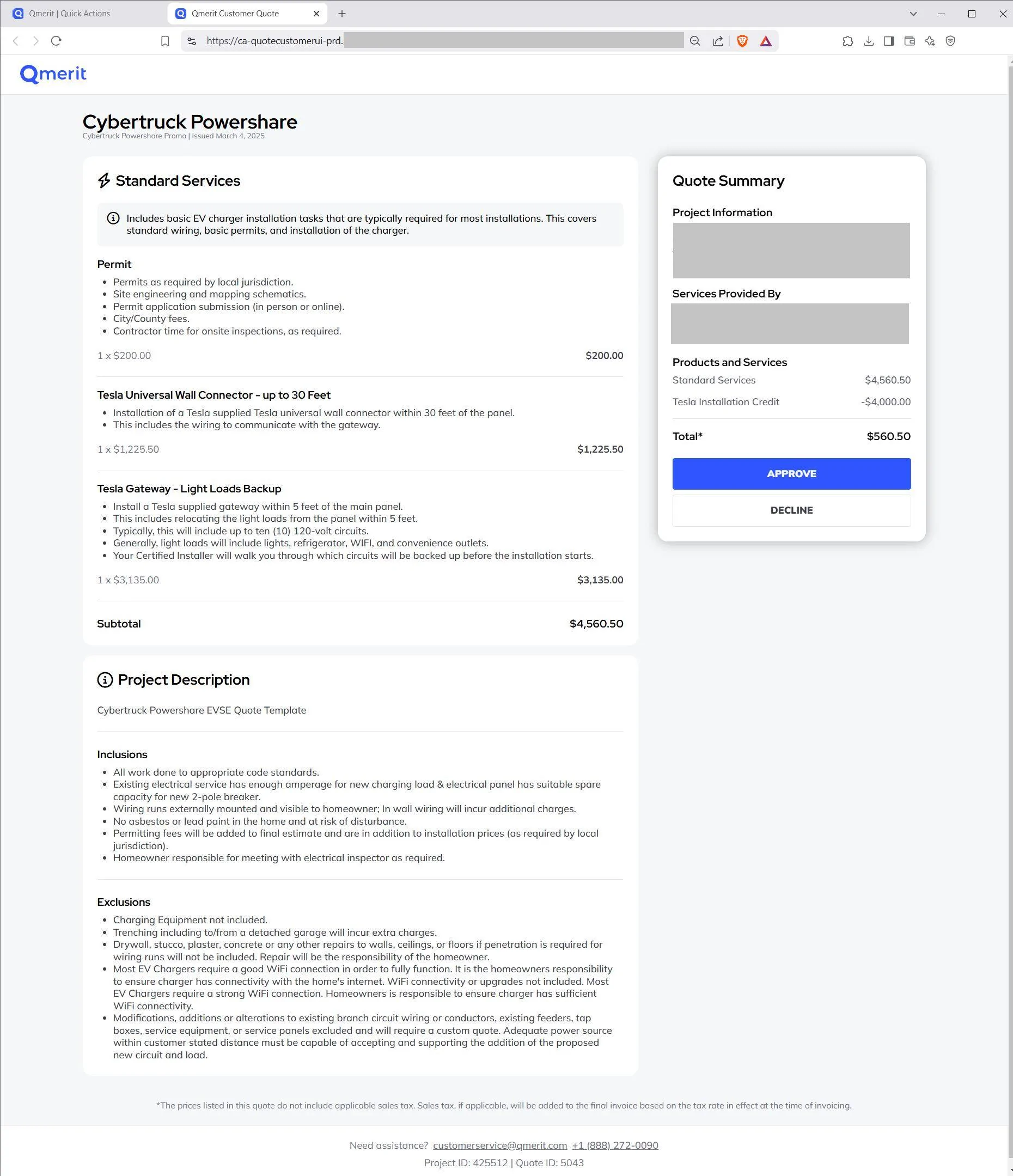

Hello all, its been a while on this topic but I just got an update on the program ending.
Qmerit is calling people and telling them that if a quote has not been accepted by 03/18/2025 that Tesla is ending the program and will be sending vouchers to people.
They did claim that if there was an issue with no installer in the area there might be a waver from Tesla.
This is especially frustrating if you had the $4000 credit (cyberbeast) but were still being gouged for a basic install.
For a basic install that only connects, does not go inline between the meter and the box its still over $4500. I did talk to the installer and he had frustrations with the options available for them to enter. Everything was dropdowns and they could not put in their numbers.
