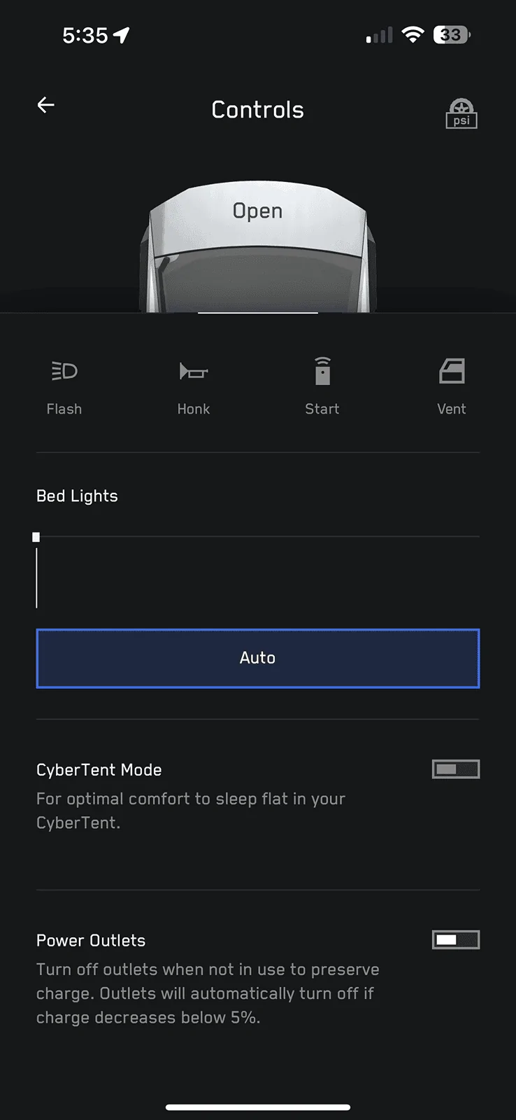

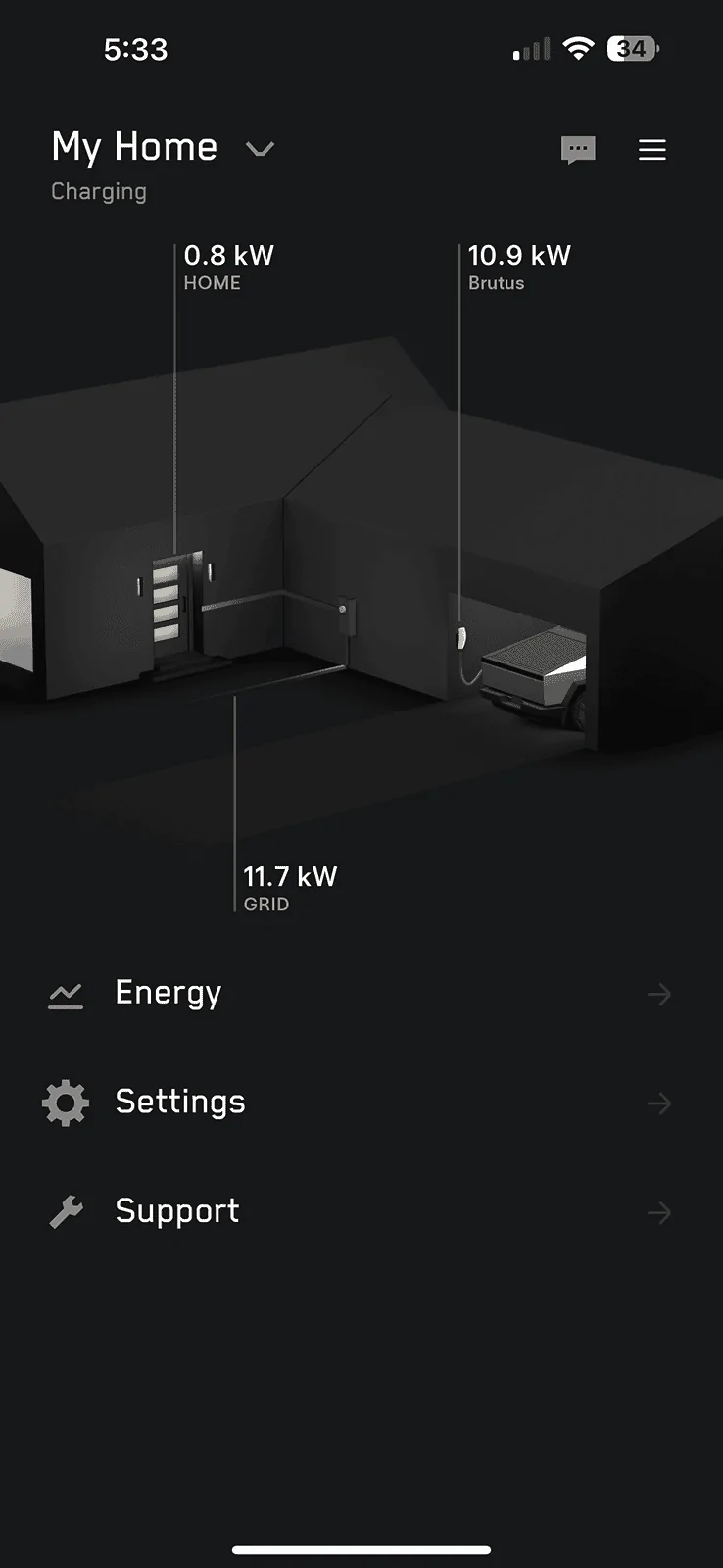

Mine was installed a week ago and I’m in the same boat as Synchronicity was/is. House is charging my car at the moment and see that in the app, but don’t see anything about PowerShare in Controls section. I’m going to sit tight for a while and see if it automagically updates in the next few weeks…and in the meantime hope the big one doesn’t finally hit (now I jinxed all of us in SoCal).
