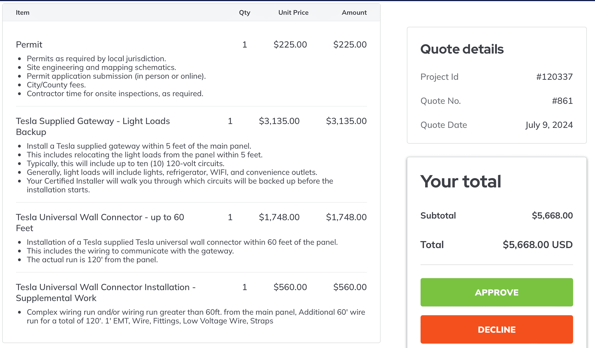

I just got my Powershare install estimate here in Albuquerque. I am #4 of 11 customers currently lined up for it. Their estimate is $5668 labor & permits. The equipment would ship to my home via the Tesla coupon use. So total hardware coupon and labor = $8168
I will say that my home layout probably presents some minor challenges not seen in a smaller home or a home where most of the equipment can be co-located. My fuse panel box is inside my home, about 60’ ( 120 feet of wire ) from the wall charger. So there’s that expense, either running Nomex in the crawl space or conduit along the garage ceiling.
Sorry, but while I think the system is interesting, this $8k expense is not worth it to me. Back East in Philly or Charlotte, where I lost power more frequently and for longer durations, then maybe I might consider it (my parents once lost power during Winter in Charlotte for two weeks after ice storms many years ago - that was bad but even that was not frequent. Everything was electric in their home, including the heat, so when the sun went down, the house got COLD). But here in ABQ, we lose power 1-3 times a year for 60 seconds. That’s been my own personal experience anyway over 3.5 years. YMMV.

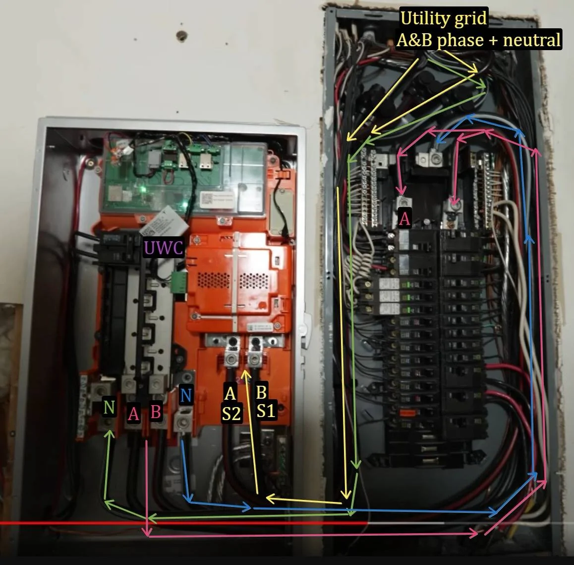

Just had mine installed today. What a cluster. The company had never done it and I don’t think they did it right.
1. Did they move your circuits to the gateway from your existing breaker box, or have wires out the bottom of the gateway to the “External Circuit Backups?” Mine did neither. I don’t think they wired any backup.
2. I think they tried to install the charger first. When I went to add the gateway to the software, it made me create a new location. I couldn’t add to existing. Any way to combine these?
3. I don’t have the backup option in my controls.
An example picture I did from some YTer that did a retrofit to a whole house setup.
Helped me understand the flow within the Cybertruck Gateway 3V (vehicle) "PowerShare" (G3V).
Note how the utility now feeds G3V. G3V now controls whether power comes from the utility grid or Cybertruck via UWC.
Tesla Cybertruck Powershare is Activated / Enabled Powershare Installation for Home Backup - YouTu

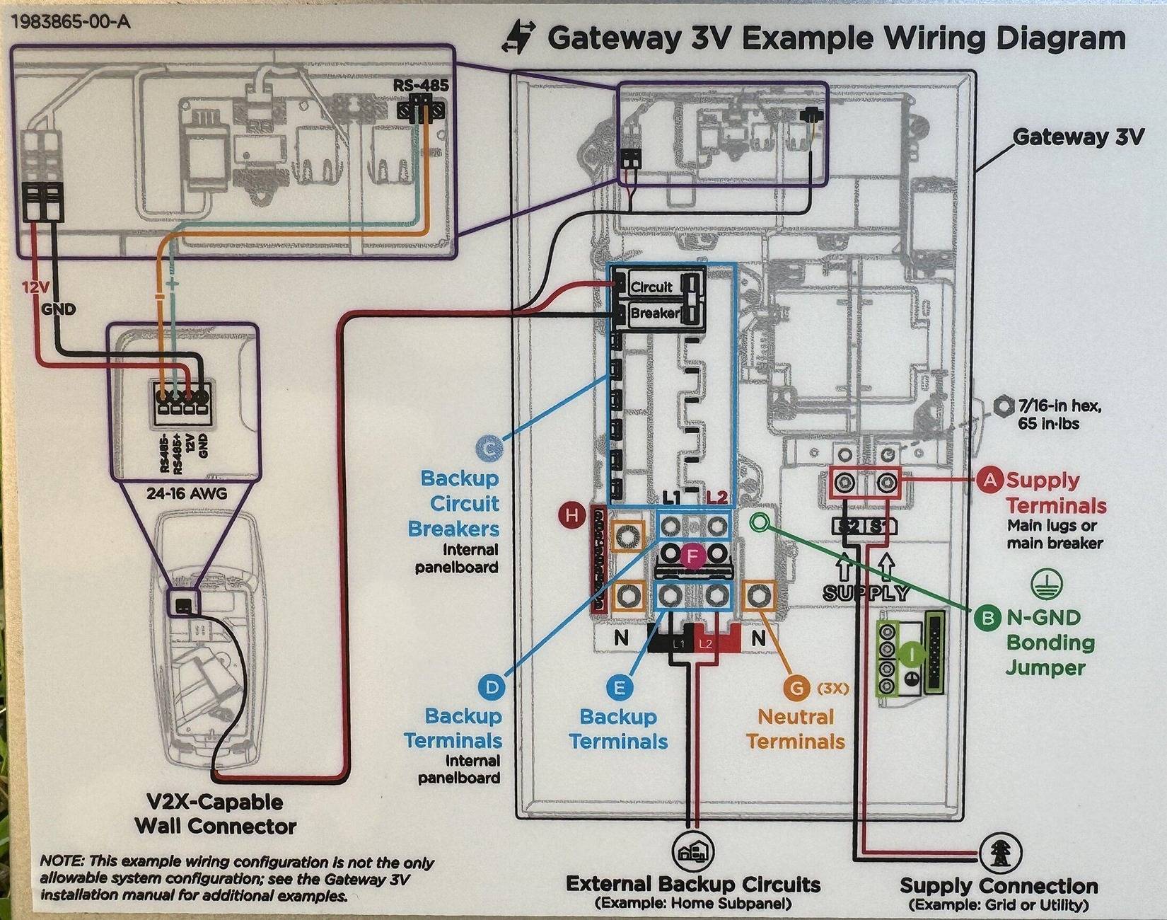

Tesla Cybertruck Powershare is Activated / Enabled Gateway 3V-vehicle Powershare labelin
Helped me understand the flow within the Cybertruck PowerShare.
Gateway is a disconnect switch and site controller.
When power goes out, Cybertruck powers the UWC which then powers the Gateway via the communication cable 12V/GND. Gateway opens the switch, disconnecting its panelboard and downstream connections from the utility.
After telling UWC/Cybertruck that the switch is open, Cybertruck backfeeds the UWC which backfeeds the panel through the 60A breaker
