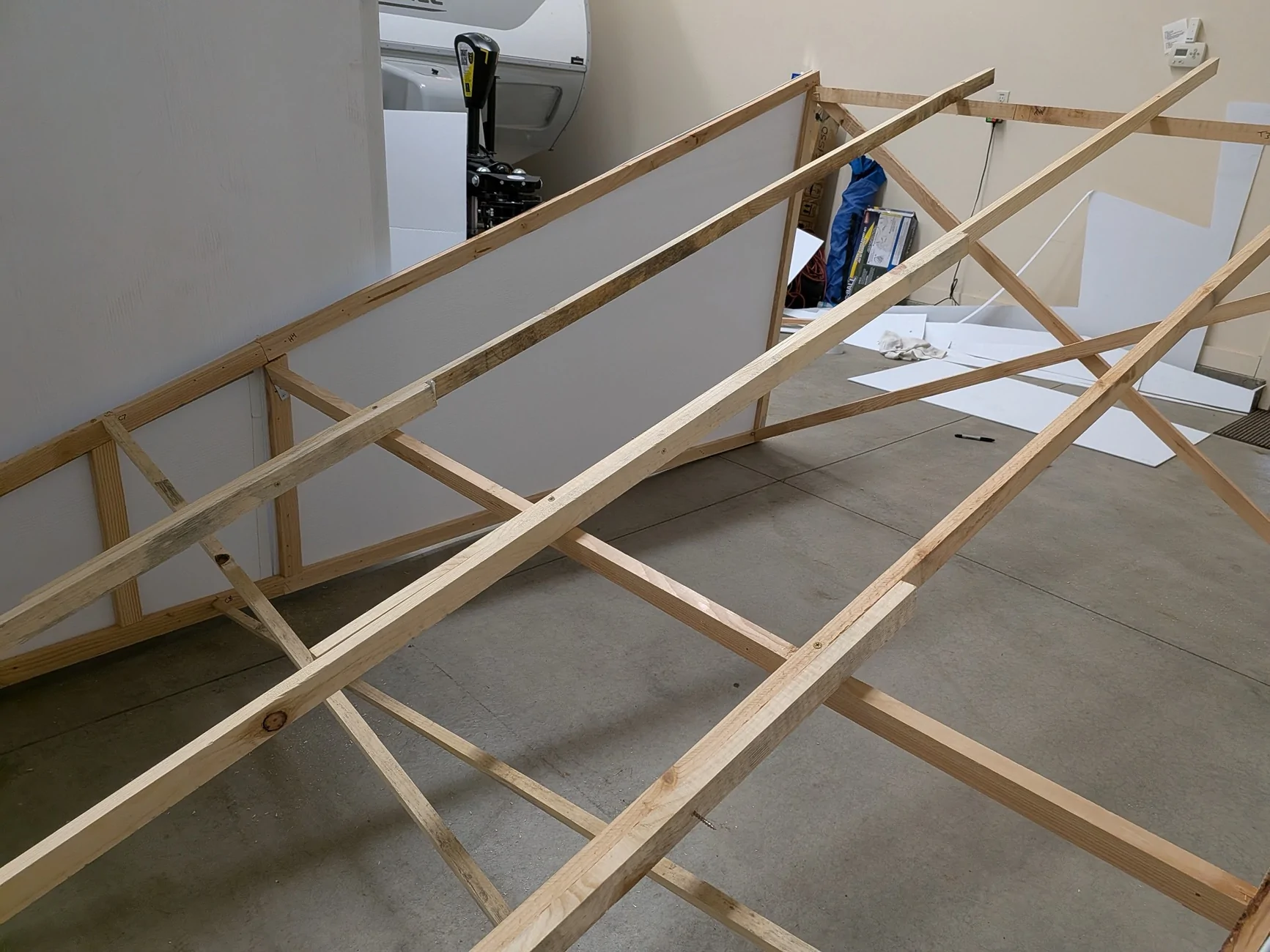

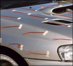

Reading the aerodynamics article that was posted on the first page, I wish I could easily round the corners on the back of my wind deflector. Maybe if it works, I'll spend more time on improving it by adding vortex generators as well.

At 4am I was trying to sleep, but thinking about my wind deflector. I need to make another run to Home Depot to get harder would for the 8 blocks attached to the truck to make sure that isn't a failure point. I also want to strengthen the supports running front to back under the plastic sheets so they don't bend under pressure. I made the mistake of putting them flat instead of vertical because I wanted more area supporting the plastic, but obviously the wood is more flexible that way. :rolleyes:

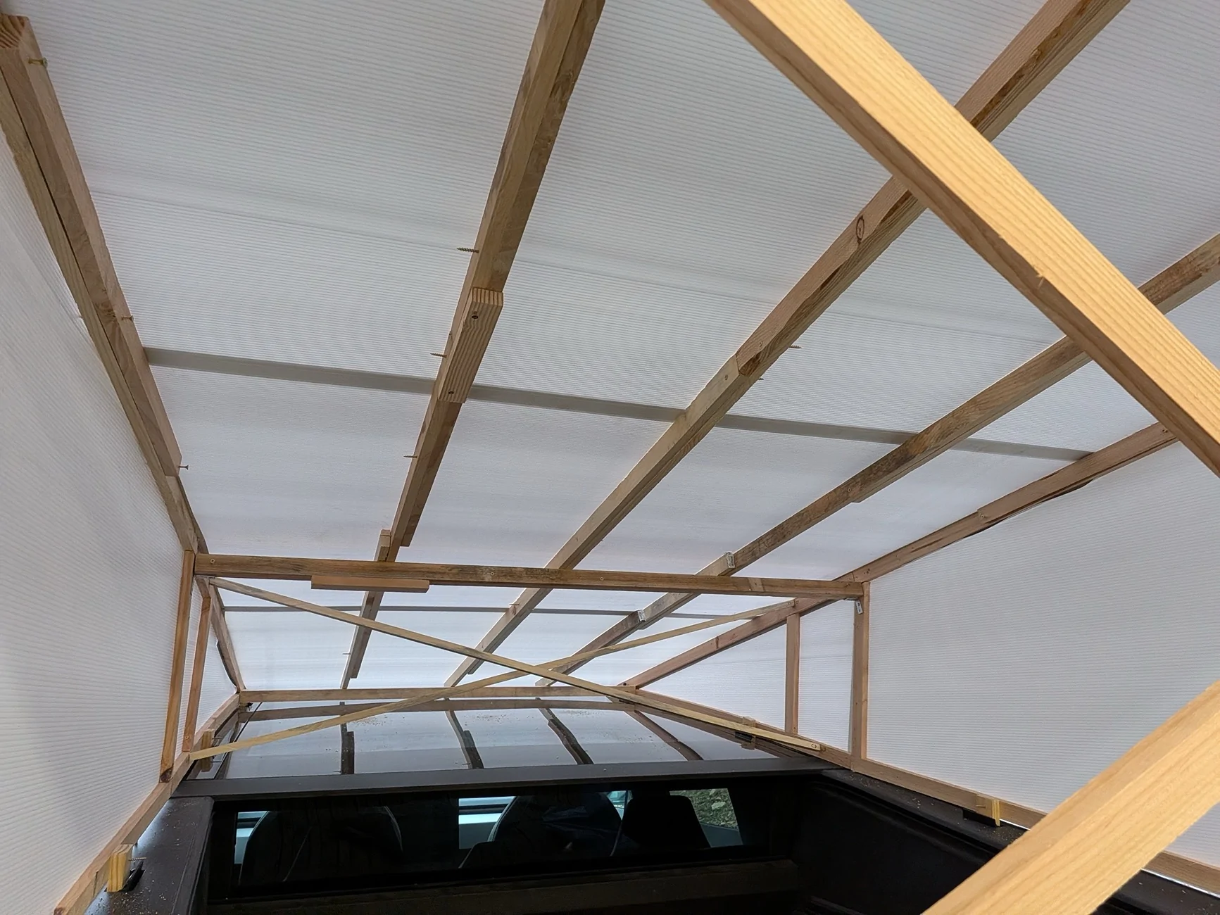

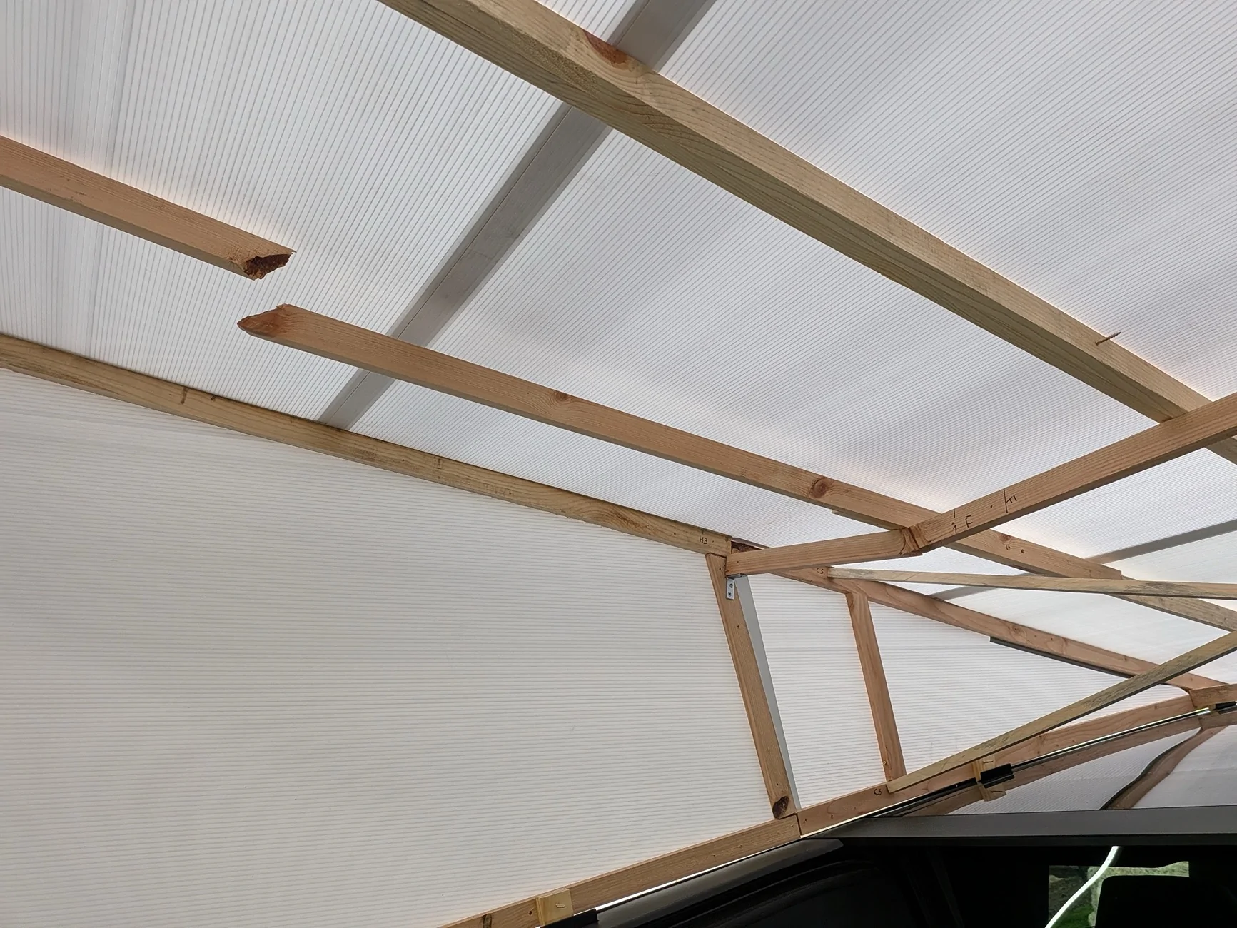

So this morning I bit the bullet and took the roof panels off, and moved the transverse supports to vertical as well as the longitudinal ones for the panels. Thanks God I did, because even after having done that, the light 3/4X 1.5 inch pine pieces were flexing on the highway. My wife was driving and I was sitting in the bed. Then two of them broke where the wood had a knot. I held up the roof with my hands as my wife drove home. I'm guessing maybe 40 lbs of downforce.
After I got back to the garage, I basically double up every piece of wood using scraps that I had. Looks even more ghetto now than before, but should be strong enough for another test.
The great news is that the really light weight corrugated plastic sheets I bought worked great!

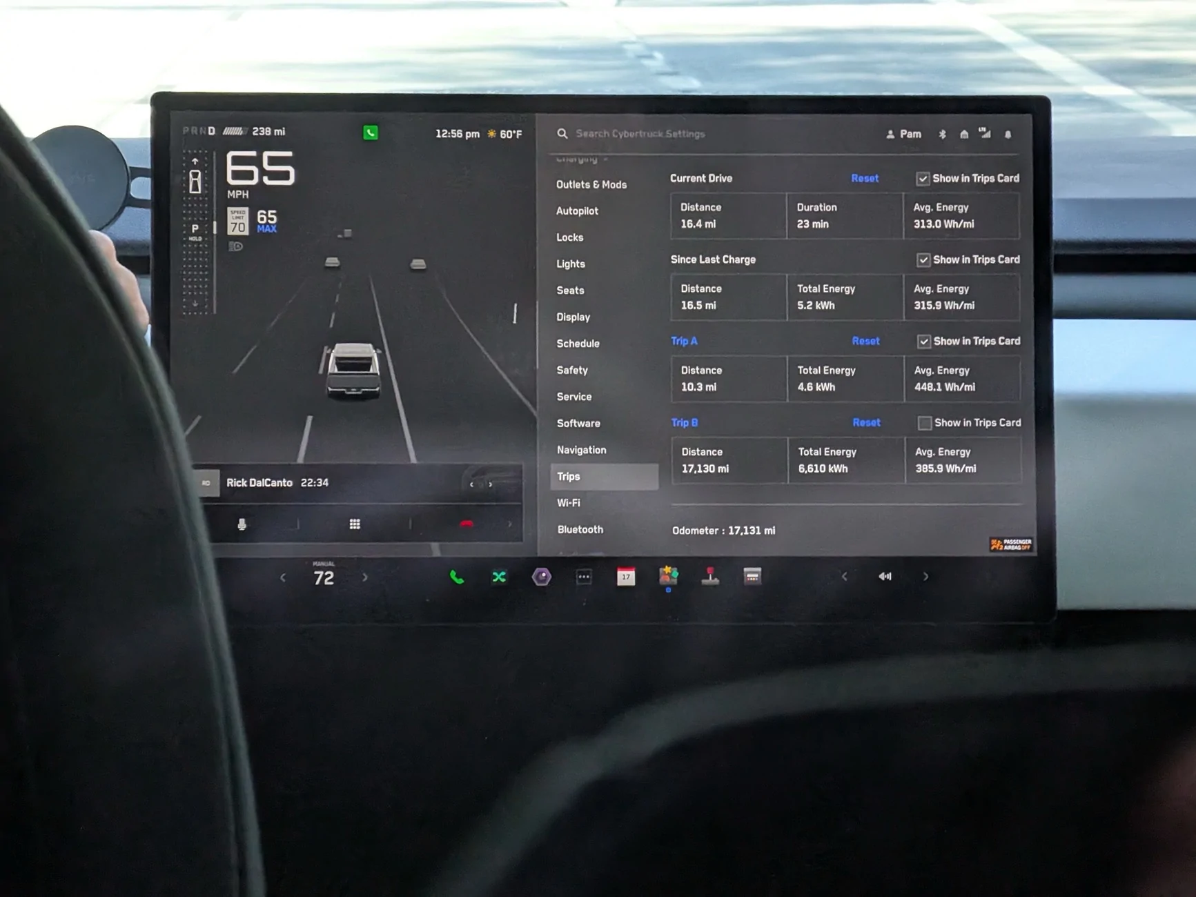

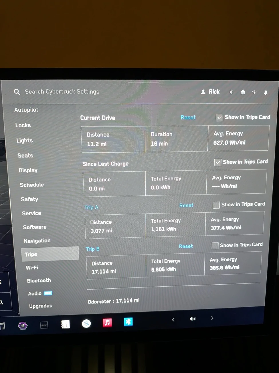

Good news!
Repeat highway test after reinforcing all the load areas was a success. No breakage.
My Energy usage on a 10 mile out and back at 65 mph was 448 Wh/mi. Not too bad considering I was displacing that much air. My energy usage for the last 3,000 miles this summer, averaging 70-80 mph, and almost all highway, has been 377 Wh/mi. (stock AT tires, 4,500 elevation and higher).
Now I just need to borrow an Airstream type trailer in the SLC area to test....
