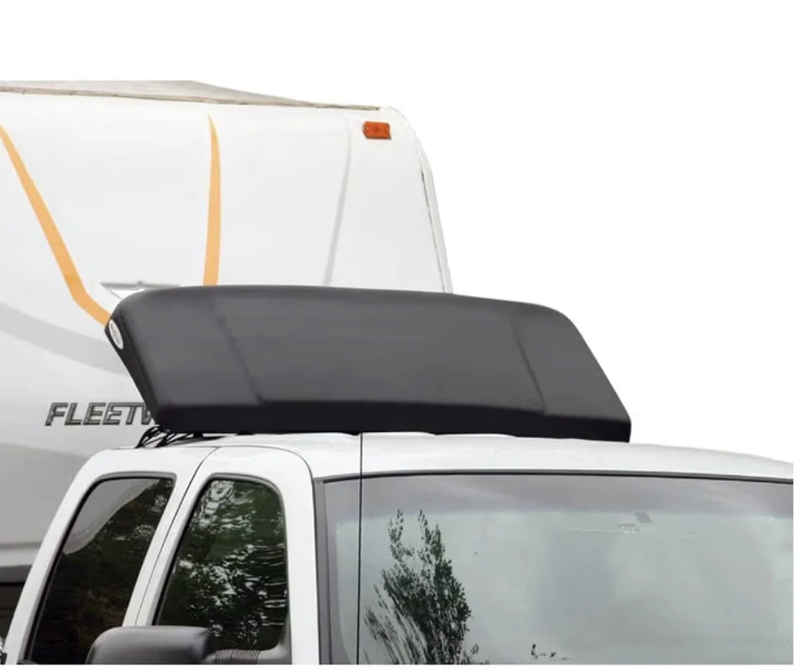

Thought of this while browsing today because I ran into this:
https://a.co/d/eFFRKrV
any of you use something like this?

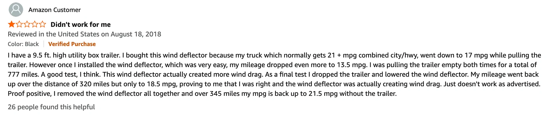

Something like this is what I want simply to deflect air over the top of the RTT on my roof rack which is just a flat vertical surface 45" wide by 10" tall. I italicized something like this because this one doesn't appear to be a good one based on reviews...particularly this one which seems to basically prove it:

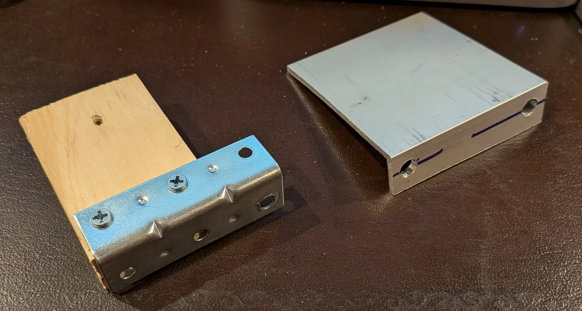

Yes. I originally cut some hardwood and screwed blocks to 90 degree metal brackets. But I'm worried about the strength. So I ordered 1/8inch thick 3 inch aluminum angle metal and cut them to be 3 inches wide, and cut one side to be 7/8 wide to bolt to the truck. 4 on each side. (I haven't drilled the holes yet that will go through the actual wind deflector yet since it's winter).

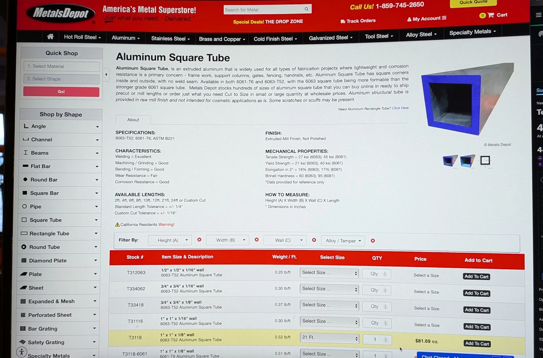

If I end up buying an airstream trailer of my own, and range is acceptable with a 27ft Airstream, I may rebuild the wind deflector for real world use using 1 inch square aluminum tubing instead of the cheap wood I got at Home Depot. Can get 21ft lengths pretty cheap.

21' pieces will be tough to manage. I'd consider building a forward and aft piece that connect in the middle.
